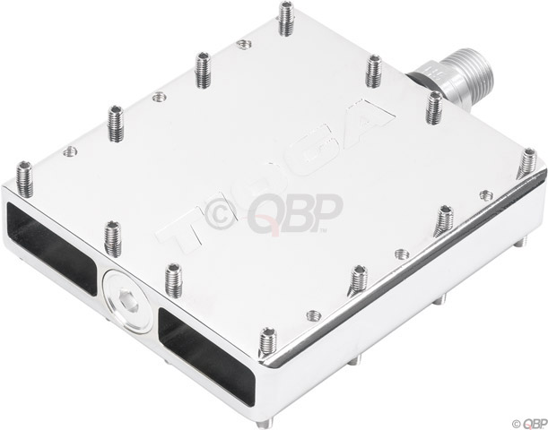

I ran the Shinburgers (they have a lighter, cut out model) for about 18 months but oddly, they’re not grippy enough for me because the top of all the spikes is flat. Josh swears by them, however. Pedals are truly personal preference. I ran the Shimanos as well and hated them as well–too slick and too cut out. But the Texas guys live them. Go figure . . .

those will catche on fire
they look bad-ass!!

Yeah, like JL said, I run those (the cut-out version). Great for pure muni - huge platform, and more or less unbreakable. One set I had lasted a year before pedal strikes ground the edge spikes off, and they were still trail-worthy when I replaced them.
The spikes aren’t super sharp, so they don’t chew through shoes too quickly. I can get a pair of Vans to last a couple of months if I take care of 'em.
