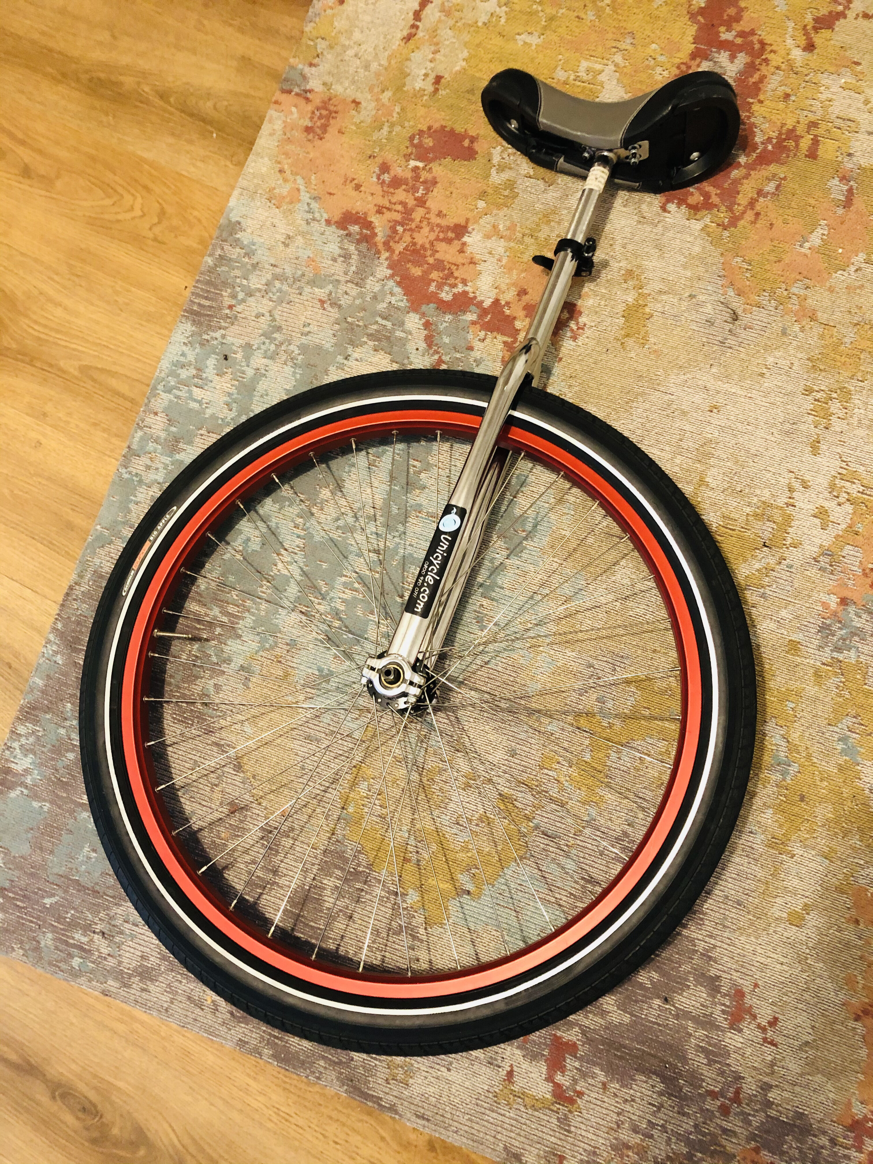

My new uni came! But it’s not all the way put together because there’s one hiccup:
I bought this Unicycle.com 29" road unicycle from someone (used, also slightly customised so it’s not entirely a Unicycle.com uni) and while I was putting it together, it seemed that the crank bolts would only screw in a half rotation and no more than that. I tried both M8x1mm and M8x1.25mm crank bolts. Does anyone have experience with crank bolts behaving like this?

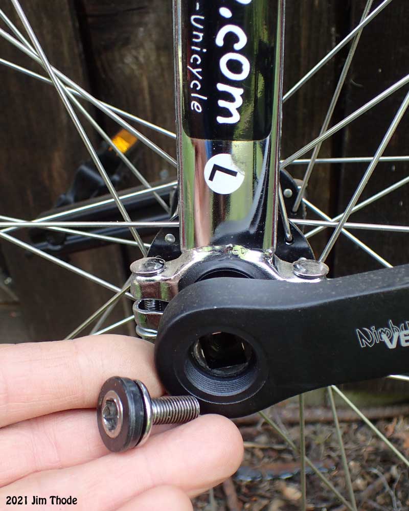

The bolts on cotterless cranks should screw in freely quite a lot of turns. If the bolts you have are going in and turning 1/2 a turn check that they are the right thread (specifically that the bolt thread is not too coarse).
Do you have the same problem on both sides? Also can you stick something in the hole to see how deep it is? I would think it should be at least 20 - 25mm deep.
If you have the same problem on both sides it is probably the bolts that are wrong. If one side has a deeper hole perhaps there is part of a bolt broken off in it.
Don’t force these in, they should be free and go in a reasonable bit as it is the bolt that pulls the crank onto the taper. If you have any doubt you might be best take it along to a bike shop and let them have a look rather than damage anything.
Looks like M8x1mm should be the correct size. With a good light and magnifier I’d very carefully inspect the threads for any problems.

It is the same problem on each side, and neither has anything stuck inside them. We tried taking the bolts from another Unicycle.com uni and they wouldn’t work either. I think all the ones we tried are M8x1mm bolts, and also one M8x1.25mm too - could they be a different size?

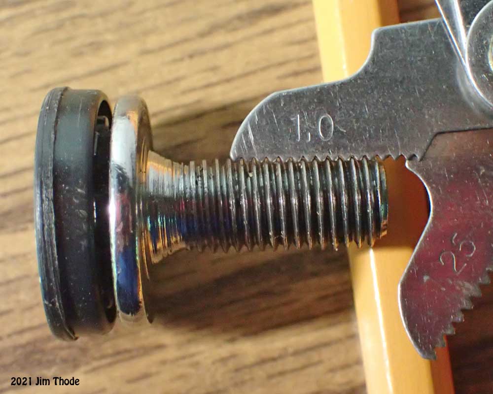

I have the same 29" UDC uni and I checked the bolts. They are M8x1 bolts, about 19mm long with a 19.5mm diameter flange.
Edit, it should be noted that M8x1 bolts are quite rare with most bolt suppliers not carrying that size. The M8x1.25 are very common but they will not fit.
