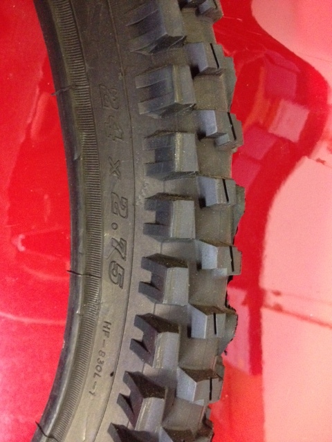

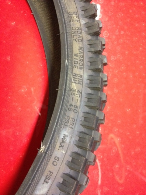

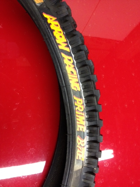

Then again, I suppose it’s on topic if I show some examples of a tire that did not seem to ride well on dirt or pavement, at any pressure, on my Sun Doublewide rim :):

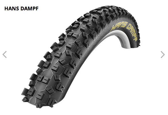

Now compare the tread pattern of the Schwalbe Hans Dampf, below. Note the differently oriented knobs in the “transition zone” between the centerline and the edge of the tire. These “transition knobs” are engaged slightly when running straight under reasonably low pressure, then really come into play by evenly gripping the surface when you lean the tire through a banked turn. Their small size, and relatively low profile also means that they don’t overly resist rotation about the center axis (twist of the wheel when standing still). Consequently, rapid changes in direction require less force.

Here’s a photo of the HD tread pattern:
