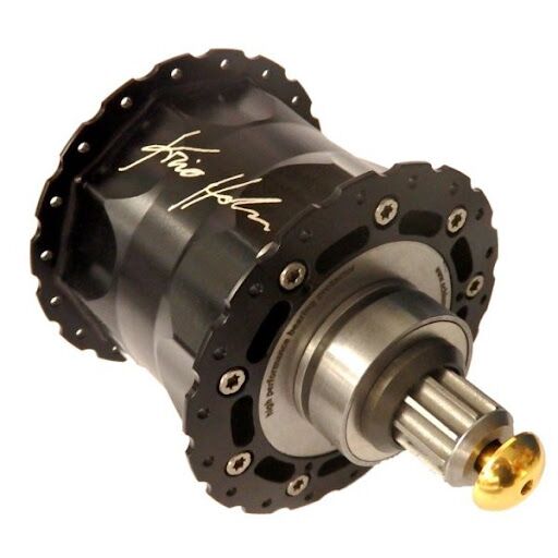

Hello all, today I realized my crank had some play.
When dismounting it, I broke the bolt and cannot use it anymore.
I haven’t found anywhere to buy this bolt, it is out of stock on unicycle.co.uk, does anyone know where I can find one or has a soare one?

I have receveid a replacement bolt together with spacers since the problem originally came from a loose crank.
BUT when placing the right spacer (gold button side) and tightening the crank, the bearing gets locked, so I cannot use this spacer.
What do I do wrong ?

I have instinctively placed it with the thinner side towards the hub and the wider side toward the crank.
And when I thigthen the crank, the bearing becomes really hard to turn, and I have no idea why.
If you really want a picture, here is one from the internet. I have put the spacer the other way around, but I don’t think it should change anything.
I think that could be your first problem as they should be installed in my view as per this internet picture.
I know of current hubs there’s a metal O-ring that helps clip these protection rings in place and helps to avoid on-bearing pressure as I think they’re not meant to press up against the bearing wall itself.

I would hope so too - I am thinking it might be that that side’s bearing has some lateral movement - I can’t recall how the gold button side is installed (assembled at factory) but if it is a secondary part - moveable perhaps it needs itself pressing inwards on the axle shaft to make more room for cranks and pressure rings.

The gold button is mounted on a thin axle which goes through the tightening bolt. To mount the spacer, I have to remove the button, then the bolt, then the crank and finally install the spacer before putting everything back.
As an information, the bearing is really hard to turn even when the wheel is not mounted in the frame.
That’s pretty key info. Is this without your cranks installed?
If yes I’d say sadly you’ll have a bearing issue where hub may need a service.
If hard to turn with the cranks installed, then you may still have an issue with unwanted pressure from the way cranks are being installed.

No, the problem only happens when tightening the crank (and so the spacer on the bearing).
The cranks are not new, they are spirit cranks from KH. If I cannot mount the spacer, I will probably have to buy new cranks with less worn interfaces.
It appears that the problem came from the big bearing that is apparently damaged and can no longer turn. It seems that some dirt, water and other stuff has gone into it since the bearing protections are no longer stocked in place. Before putting the spacer, there was no side pressure and the small bearing was not pressing on the big one, and its outer flange was spinning inside the inner flange of the big bearing.
I did not read the whole thread, but #648 would be from a generation that did not use spacers. If you do, it pushes the the C-clip holding the dust cap into the bearing and will make it harder / impossible to turn.

It does indeed push the c-clip, but I haven’t got any noticeable difficulty turning the wheel with spacers (except from the very obvious one from the big bearing).
I will have to send the hub to Florian for a maintenance and replacement of the bearing anyway.
In the mean time, I will try to find new spirit cranks in order to not have to use spacers.
