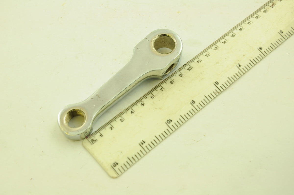

You could get yourself a couple of these for the princely sum of £9.98 and see if you can drill and helicoil one for the right-hand side. They look closer to 100mm than the stated 90mm, so maybe still a bit shorter than you are looking for, but they are cheap and a bit of a fun project (the tools to put the helicoil in would be more expensive!). :slight_smile:
Thanks, but no thanks. I run 100s on my 20er, but anything shorter would be suicidal, particularly on a bigger uni. These are meant to be mounted onto a 650B/27.5er (though one with a rather narrow tyre, probably around 1.75" wide).
