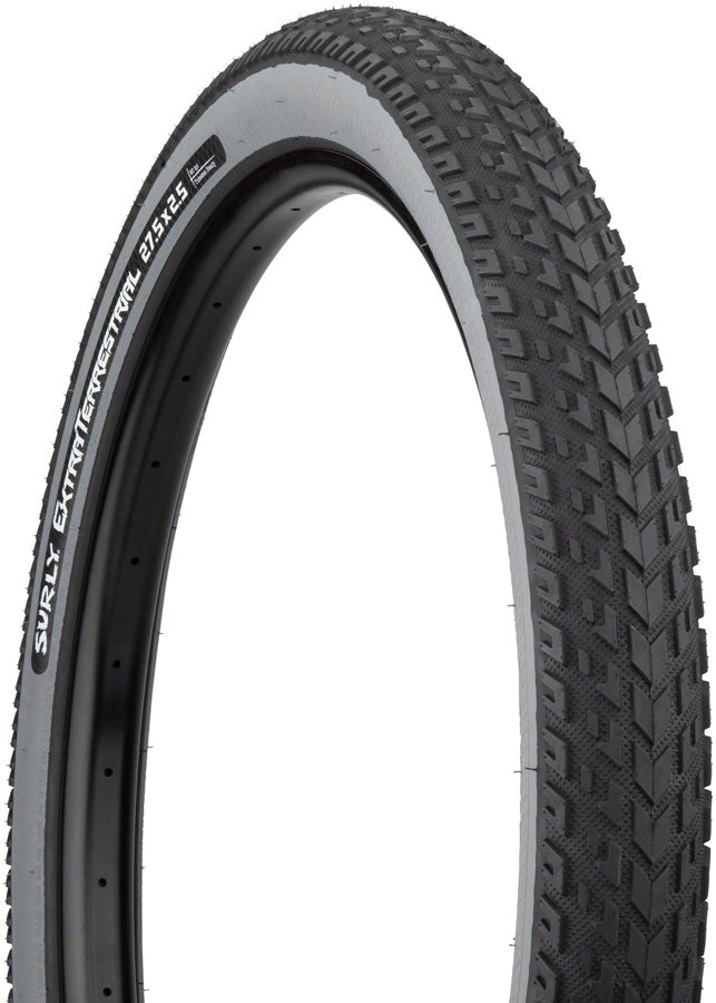

I saw @hillin mentioned he got a Surly extraterrestrial for a similar terrain mix, which looks pretty good, but the largest I found was 2.5", so not sure if it would work well with my 42mm rim.

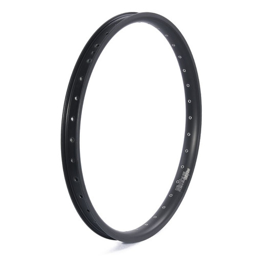

You are right, looks like 41.6 external, 33 internal, according to this:

The Surly ET 29" definitely worked for me, it’s fast, stable and good looking. I’m not sure how does that translate to the 27.5" version, but keep in mind that in the 27.5" world there are far more choices than 29", and amongst them the ET is a very expensive one.

Well I shied away from the ET due to seeing the recommendation here saying max 30mm

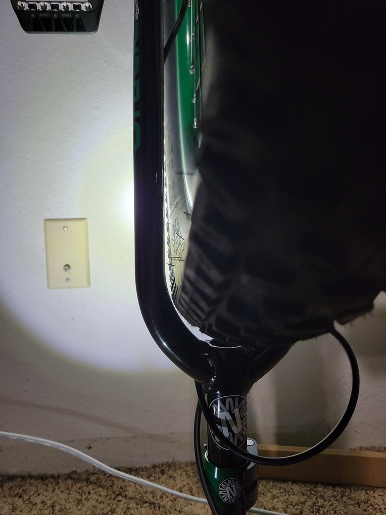

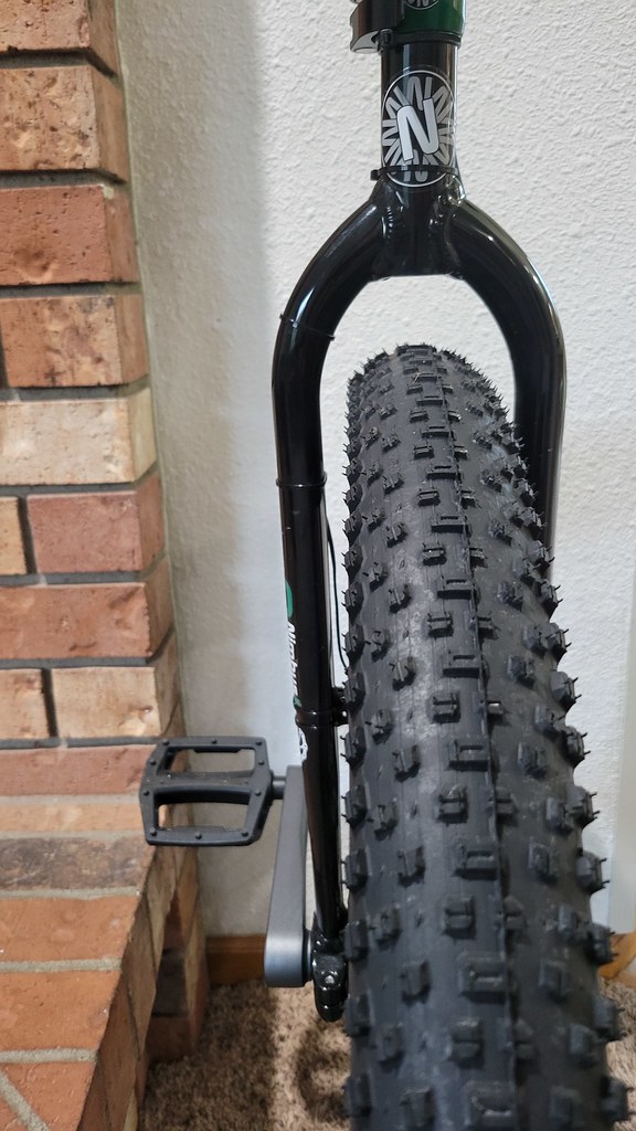

Got the WTB ranger 27.5 x 2.8 in the mail, mounted it and gave it a try… wow what a difference in appearance and ride! It feels like I dropped a wheel size. It shaved 288g of rotating mass, looks noticeably smaller, rolls noticeably smoother, feels far more responsive for turning and getting moving after mounting, and I now have tons of frame clearance with no more tire rubbing.
I should have done this a while ago!
After:
Imgur
Before:
Imgur
Now get out there and ride. He He He.

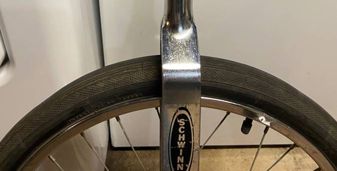

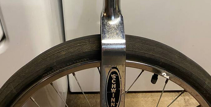

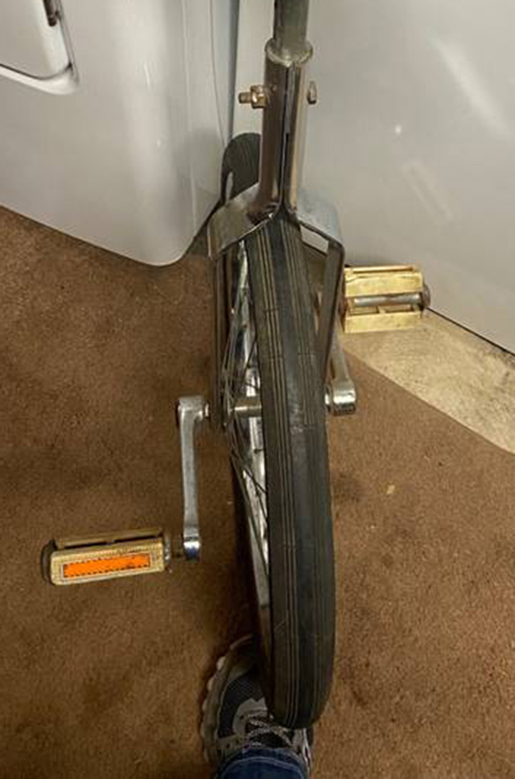

My old Schwinn had no knobs on the tire whatsoever. The tire was very smooth overall. It had a center rib that was flat and about 5/8" wide. A bunch of tiny flat ribs emanating outward and a crosshatch pattern on the sidewall. It handled hard packed dirt and the street smooth as silk. You may want to reconsider running a knobby at all. If you don’t need one, you don’t need. Knobby’s have a lot of roll resistance over time and distance on smooth surfaces. I live in the country now and got myself a mountain uni a while back. I ride on hard packed roads and kinda like the traction of the knobby on a sharp turn. Aside from that they don’t contribute to the ride. I broke a finger in spring and had problems with my eyes this year didn’t ride. Your post got me to thinking about my tire. I’ll probably replace the tire before spring arrives and see how a smooth one works out for me. I’m not going to be doing difficult trail riding that requires extreme traction. Enjoy the ride however it works for you.
Wow, I am surprised that worked out well on the hard pack, it looks slippery (so do those pedals!) Unis have come a long way!

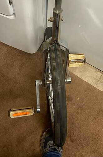

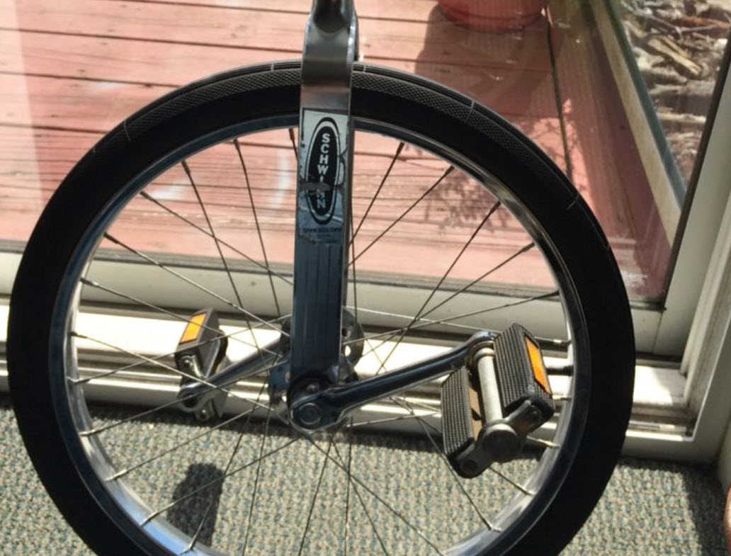

It’s been over 40 years since I had the Schwinn so I got the photos from the internet. I don’t have any myself, I don’t think the white pedals came original. In this image you’ll see the originals. They were rubber and your feet stuck to them pretty good. I rode barefoot a lot. They were very comfortable on bare feet. I can’t find bare-footing pedals these days. I’m not sure it’s a great idea for 64 year old feet to be jumping off Uni’s onto gravel, etc. LOL. I like the looks of the tire you shared, its almost dead smooth with a hint of bite if required. Rubber has a lot of natural grip to it. I rode in the winter. Not across smooth ice much but I have, packed snow is less suicidal and I doubt a knobby would help much. I rode on cleared roads and sidewalks primarily. Now I’m a fair weather rider, if its a nice day, great. Its a good day for a ride.
