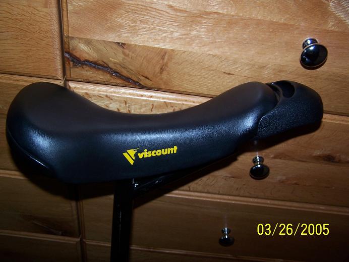

then all you need is a Viscount seat.
… and a handle
no not really, its mostly seat out in trials and the Viscount is the most comfy for that.
Viscount eh…Will that fit a summit frame? Or rather, is the seat post diamter the same as the KH post?
Summits were sold with a shim to fit a 27.2 seat post. the KH post is 27.2 also. so yes.
A KH Handle fits nicely on a Viscount .
