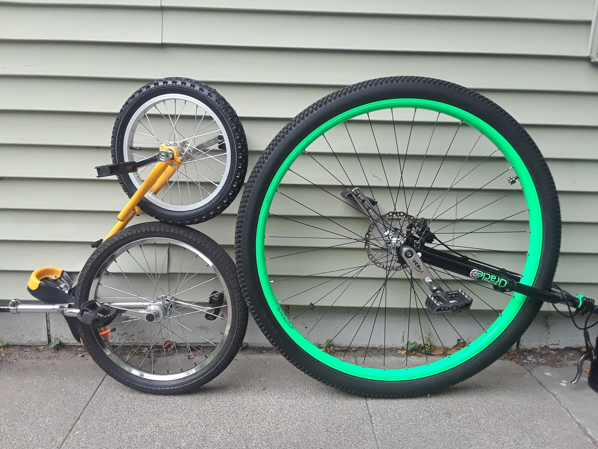

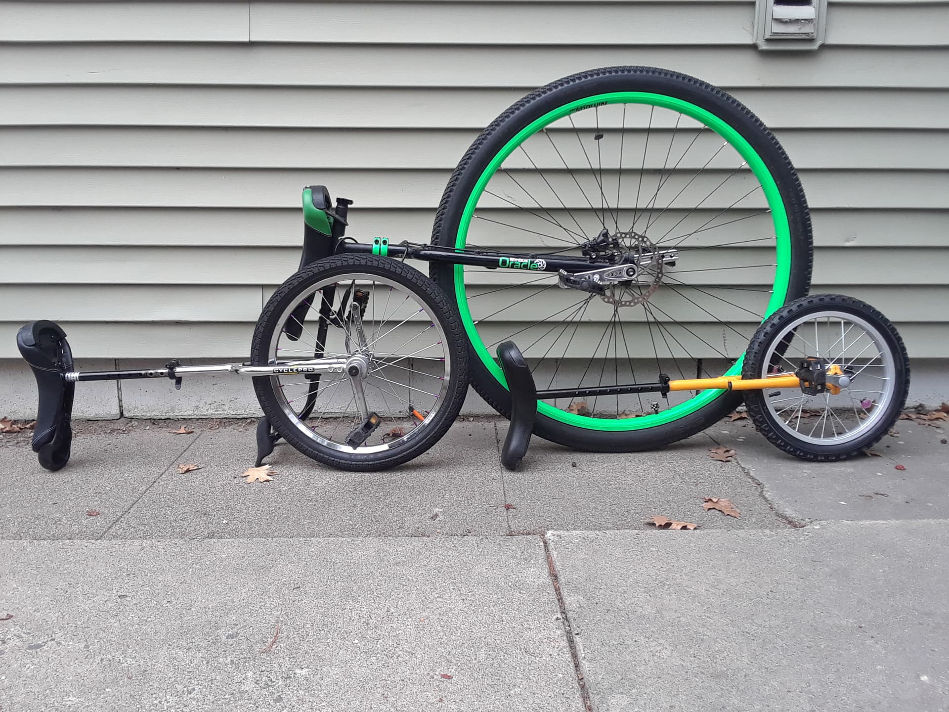

A couple pictures are worth a thousand words ![]()
(Those two pictures were taken months apart, believe it or not! The pic with all of them level was taken today.)
The silver uni is a 20", the yellow/orange one is the 16"⦠You can see how they compare to the 36er!
For a further visual, the top of the 16" wheel reaches to about the upper-middle part of my shin. The top of the 20" wheel is about level with my knee. Meanwhile, I canāt quite fit the 36" wheel between my legs! Wearing a pair of thick-soled boots though I think I can barely stand above it. The 36er is definitely a beastā¦
