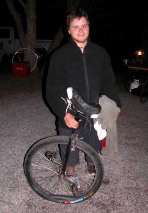

Was Jeff using a Nanoraptor in the Rich And Famous race? Picture from Nathan’s Webshots gallery.
That looks like a foldable Nano with a Rhyno Lite rim, John. I think that was one I built for him.
So far all the blowouts have been road or stationary, but with at least two different rims… all the data are not in yet.
WTB did say they had problems with the foldable tire with a tubeless setup, but they did not say what rim:
Ah, now I see the tube on Jeff’s uni… bonks self :roll_eyes:
