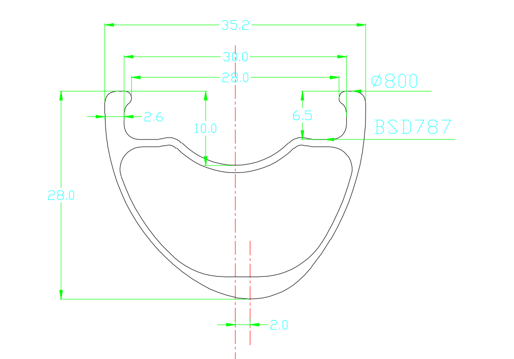

The rumours over this project started a little while back and were discussed in this thread:
Recently I got the design for their new rim which is asymmetrical and looks to my eyes more like a mix of the Braus’s narrower design and the Dominator2.
I’ve got the go ahead to share this here, so we can get feedback on the design from those with a more engineering bent.
Naturally there’s also an element of trust needed as the engineers at LB also clearly know how to make rims — but for 36” rims to be a success we would need there to be a clear awareness to test tyres at 60psi and be aware that there are variations between tyres.

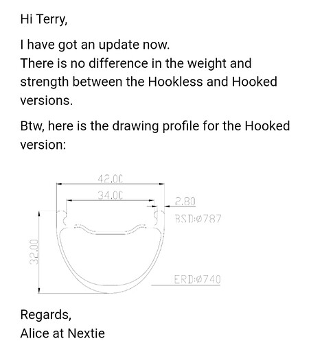

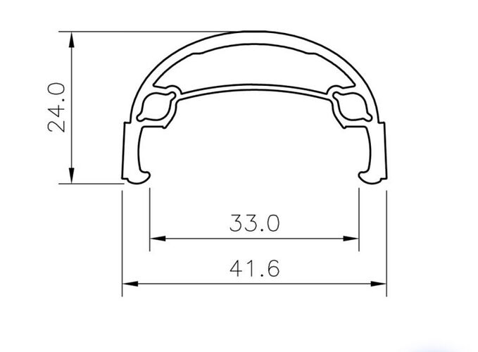

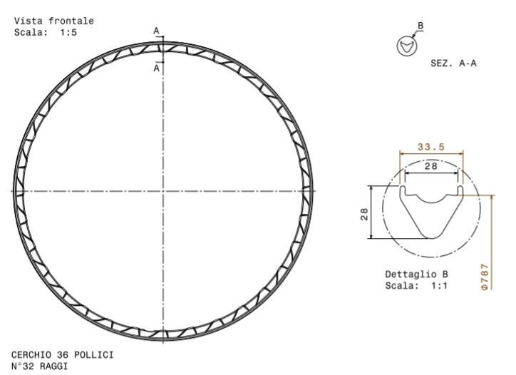

For reference, drawings for other rims (those have already been sent to Nancy from LB in December):
Dominator2:
Nextie:
Braus:
So, I’m not a mechanical engineer, but based on the other designs, this ones looks pretty great. Now, I’m eager to see this one in my uni :star_struck:
Here here!
I can’t wait either as it looks so nice especially the asymmetrical part.
Only area I wasn’t so sure on was the thickness of the side areas - think these are 2.6 whereas others as 2.8 ish. But again I’m not an engineer and my gut says this will work well due to being narrower than the Nextie :crossed_fingers:
Sure! My Braus rim is hard to center because of its symmetrical aspect. I had to get it a bit off-center to have my spokes well tightened :frowning:
Nice job. It’s really narrow which would make for a “pointy” tire. Braus riders might have feedback on this.
Interesting they would make an offset rim. I guess it makes sense since even the bikes will have disc brakes in the front and lots of gears in the rear.
I can’t take the credit here as it was @Maxence that first mentioned it on the forums, but it’s been fun sharing my own view with LB when asked for comment - and I’ll be very keen to see how this one comes out of the mould.
I don’t personally know how it’ll change the feel but I can picture enjoying the feeling of a more pizza cutter style ride.
As for the asymmetry - I think symmetrical wheels are rather an oddity when it comes to normal bikes, and even with unicycles the only symmetrical system relies on the KH external braking system via crank mounted rotors.
It’ll certainly help with building a nicely tensioned 100mm hub or make for a killer 125 build where the tensions can be equalled.

The more I ride narrow rims, the more I like them! IMHO, they tend to turn easier than wide rims. They’re usually a bit lighter, too. So better for accelerations and hill climbing. They also seem to be less sensitive to road camber (to be confirmed, I’m not 100% sure of that fact).
So: that’s really great to have a narrow design! :heart_eyes:
Let me disagree on that point :grin:
I would say that on old or low-end bike, that’s not odd. I mean, when using rim brakes on a front wheel, you don’t need an asymmetrical rim. And a symmetrical rim is probably easier to produce.
The same goes for a single speed rim brake rim, no need for asymmetrical.
But yeah, for a top-end, carbon bike, I don’t see why you’d like a symmetrical rim.

Would you need new spokes if you’d replace a Braus rim with a LB rim? They look to be as deep. Even though there would be a little offset on the LB rim, the previous spokes may still work :thinking:
The offset makes almost no difference to spoke length. But until you know the rim’s ERD, it’s impossible to know.
I’d prefer an asymmetrical rim, but I’m not sure I’d make the purchase just for that.
I don’t think a difference of a few mm in width really has an impact on wheel stability. The lightness and stiffness of carbon have a much greater impact.
With a heavy rim and tire, you get the impression of being guided by the wheel. For the same speed, the wheel’s inertia is greater, allowing for more forward/backward positioning error.
That said, it’s still a 36" wheel and, with speed, you get a greater stability than with smaller, even heavier wheels.

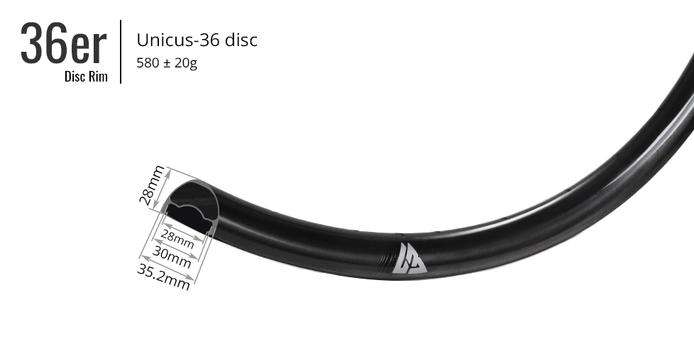

https://www.lightbicycle.com/unicus-36-36-inch-carbon-rim-for-unicycles-big-sized-bikes.html
Oh, I see it’s in the other thread:
Has anyone experiences with the unicus 36 rim from Light bicycle, now? Is it compatible with the nightrider light tyre or does it need a special tyre? Blow offs? Is it really ok with 50 psi?
Thanks Aws
I’ve ridden the rim for a full year on my G36er and my freewheel 36er, at 45 psi. No issue at all, whether with the NightRider or the T-Monster. The only real difficulty is to put the tire on.
