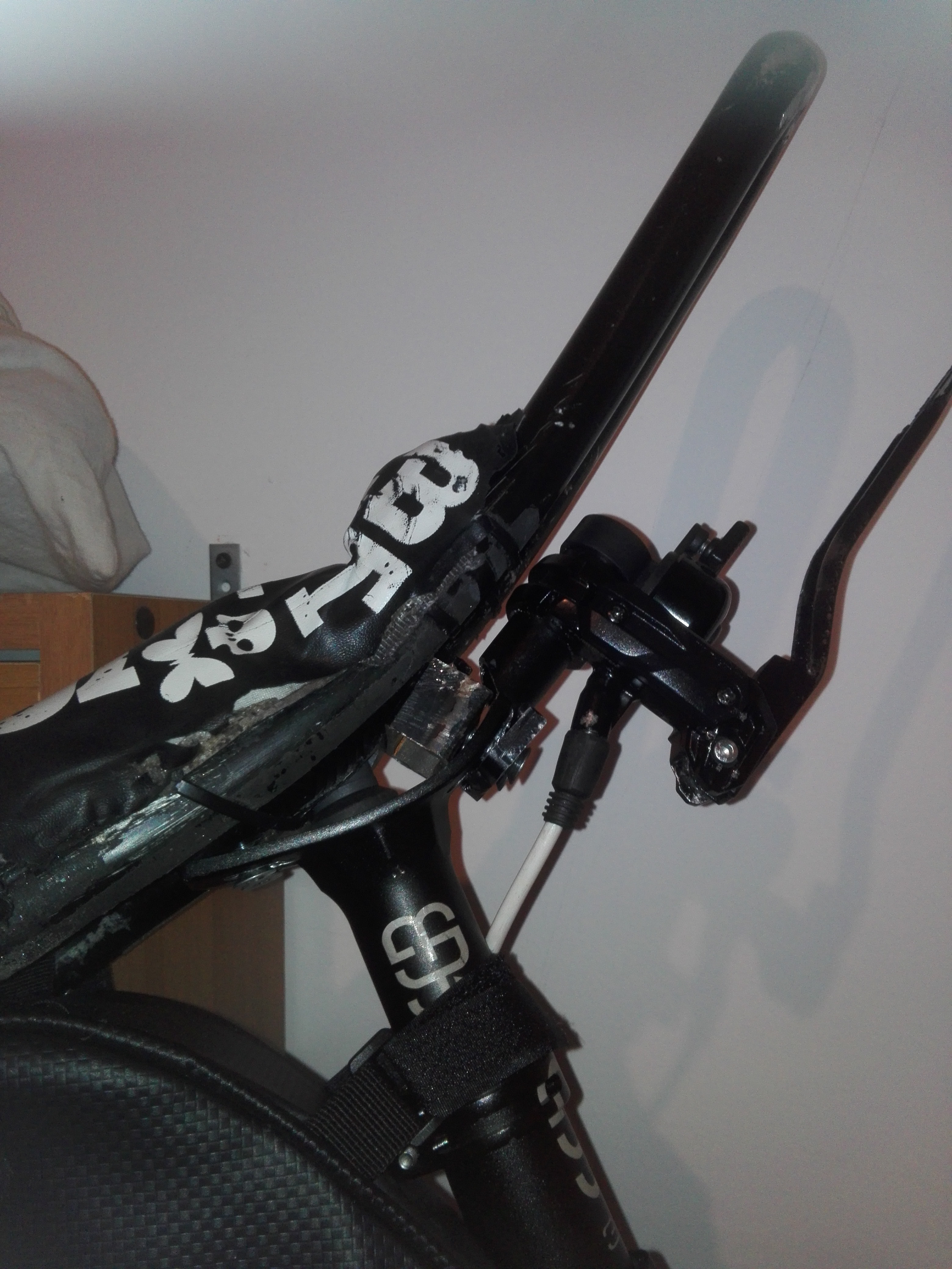

Does a custom saddle count as a custom uni? I just take this PIC for the handle saddle post… but it is a custom saddle (a big deep hole in the middle), an hidden pump in the seatpost (reachable by the hole), an handmade LONG brake lever (I can now brake ib whichever hands position), plus various other mods/addons

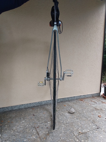

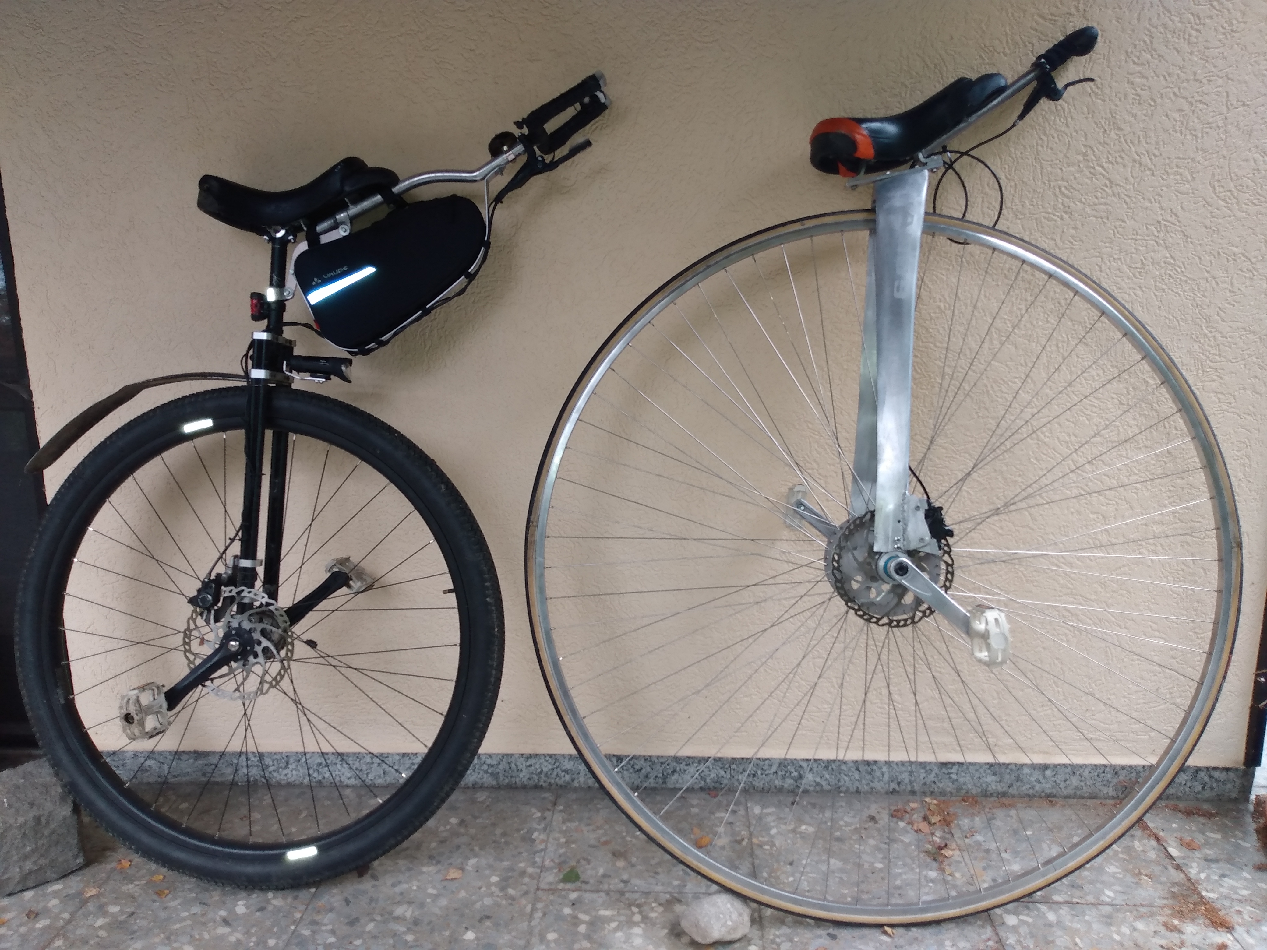

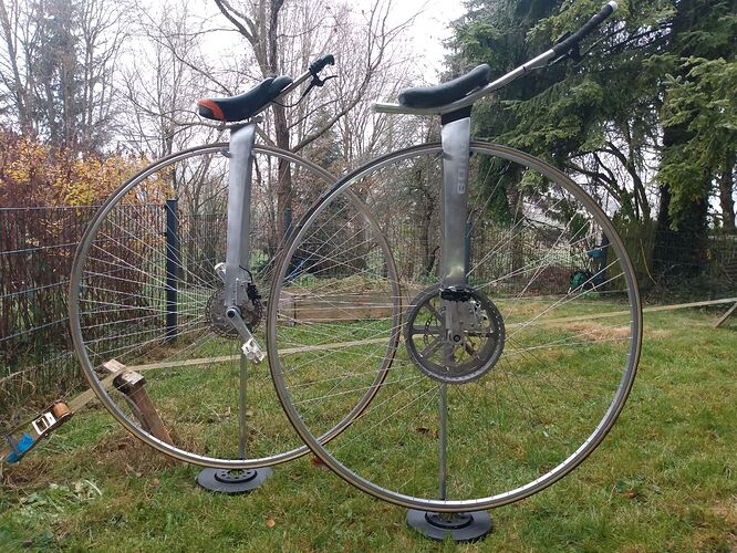

Here is my custom uni. Its not finished yet, but it is really fun to ride (and horribel to mount, always need help from my wife).
To show the size: the small is a 36.
Gruss aws
Yowsa, that is a big one!

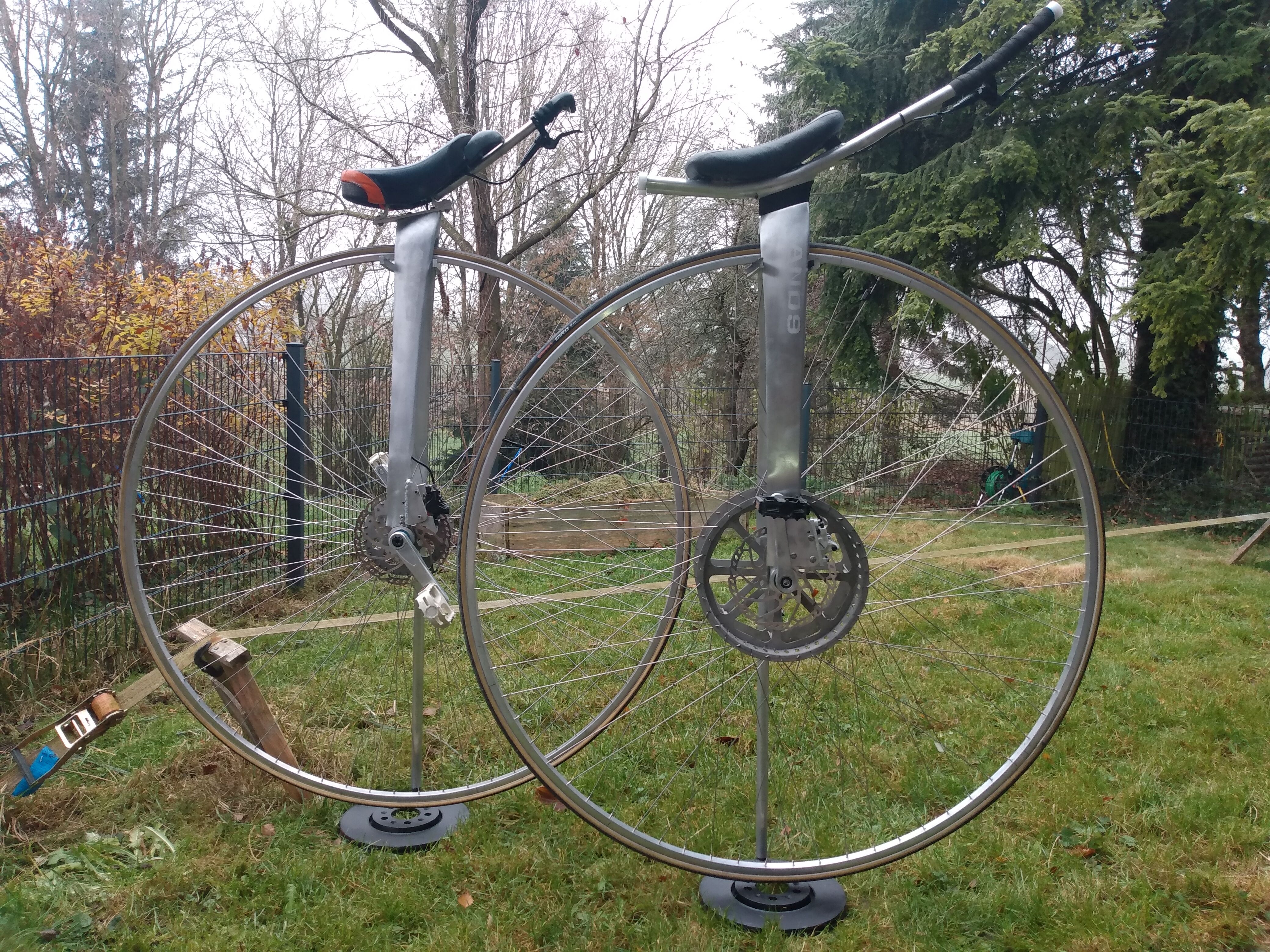

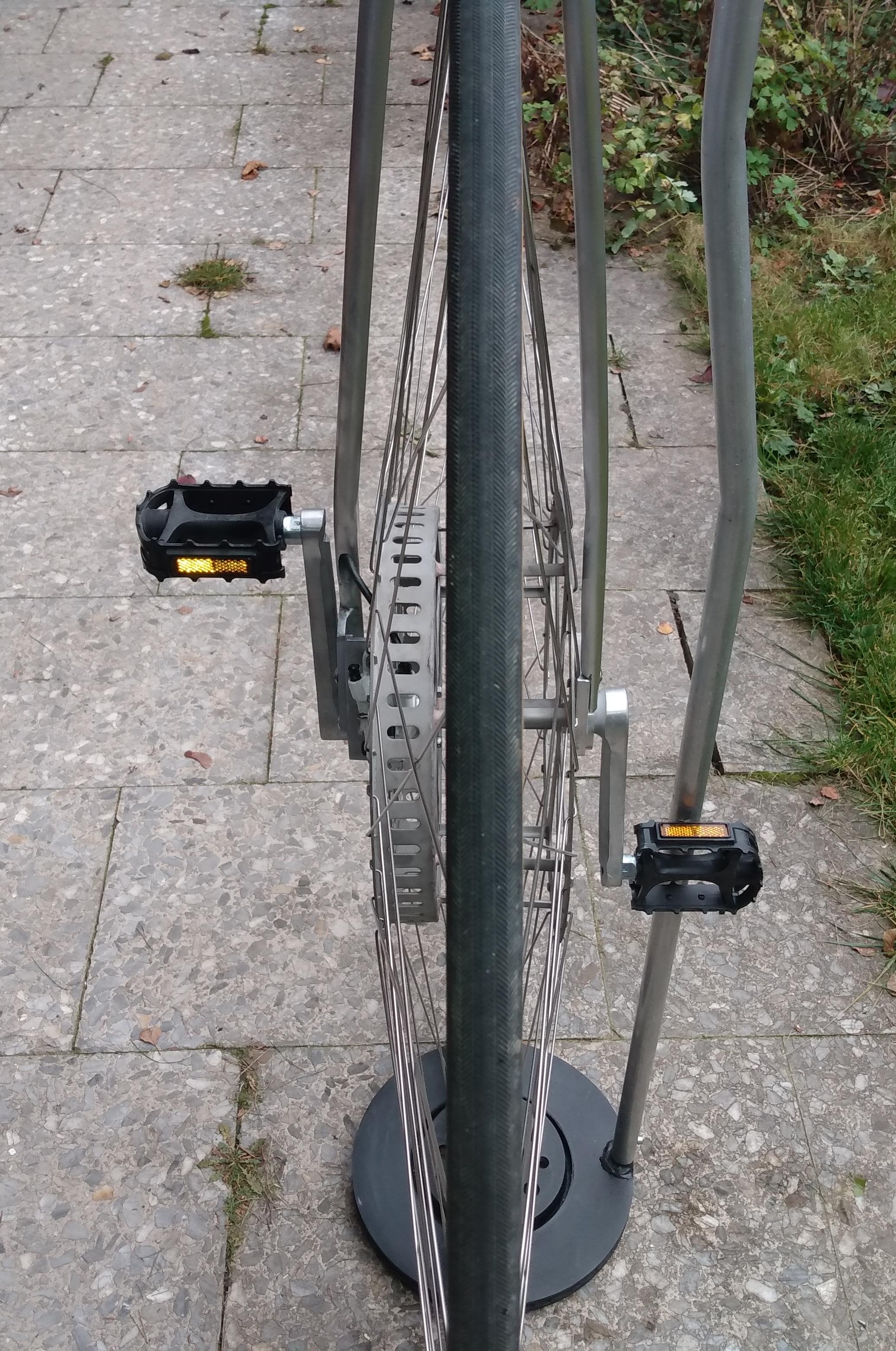

Hello,
Growian 3 is nearly finished. As the discbrake is “inside” the hub, the hub is more narraow at this wheel. Today i made a 30k testride and i am able to mount with the help from a traffic sign or a wall now. So maybe i can learn to freemount.
Gruss aws
That’s very cool. It absolutely dwarfs your 36er. Would you take some video riding it? I’d love to see it in action.
Now that is cool!
Is the opposite flange equal in size to the brake side flange? What is the size of the disk? And the wheel? I’d guess 202mm and 54".
Yes it is a 202mm disc. The wheel is ca. 125cm outside diameter (between 49" and 50"). The opposite flange is eqal in diameter. The flanges are connected with soldered braces.
