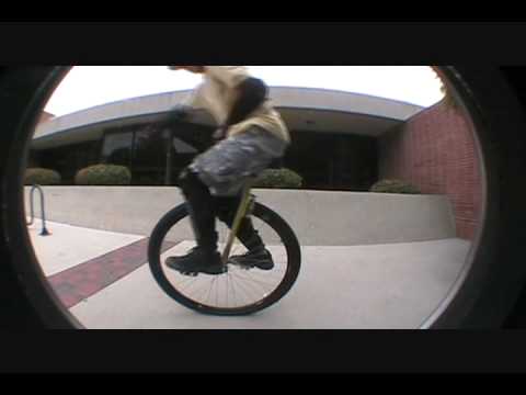

I use the rolling mount and found this video helpful (thank you Terry P)

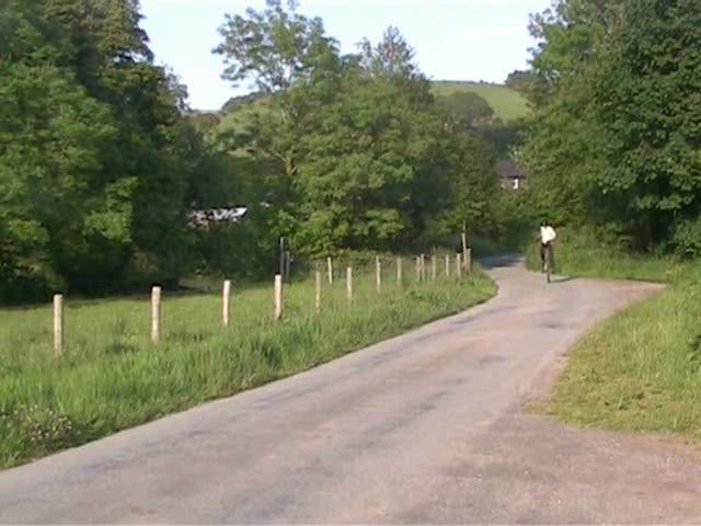

+1. When learning to mount the 36 I found the running mount - or rolling mount? - was my prefered way to get on top of the wheel. Here is a practice video when I was first learning the mount that might be useful as it shows a beginners efforts. This was also before I could ride with both hands holding the handlbar.

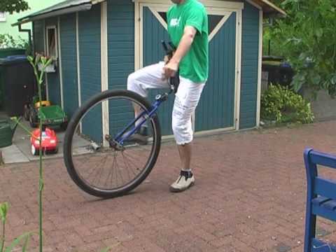

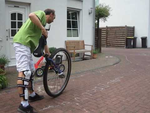

@flyjeffva: It looks like we have similar problems. It is a real pain for me to mout my 36er. I tried static mount, rolling mount - and now ended up (again) with rollback mount.
My Problem with static mount is that I always have to do a few hops before riding off (and I fear that my geared hub will not be happy about this in the long run…)
And with the rolling mount, I have timing problems.
It may sound weird, but the rollback has the highest success rate (for me). It do not need to jump a lot because when I step on the pedal, the seat will just push me up. I find that much less exhausting than doing a static mount.
Nevertheless I made 2 short videos last summer. I will add the rollback mount as soon as the weather allows.
Here are the videos:

When watching your mounts, the pattern emerges that all of the failed mounts are errors of not getting your body far enough forward. When you do make it up to the top you take a bunch of those little hops that allow you to position the wheel a little bit behind your body’s center of mass. This tips you forward which allows you to then accelerate the wheel forward, get the wheel back under you and get going. More practice and the resulting increased confidence will allow you to mount directly to that forward position and cut out the middle step of hopping to reposition the wheel.
