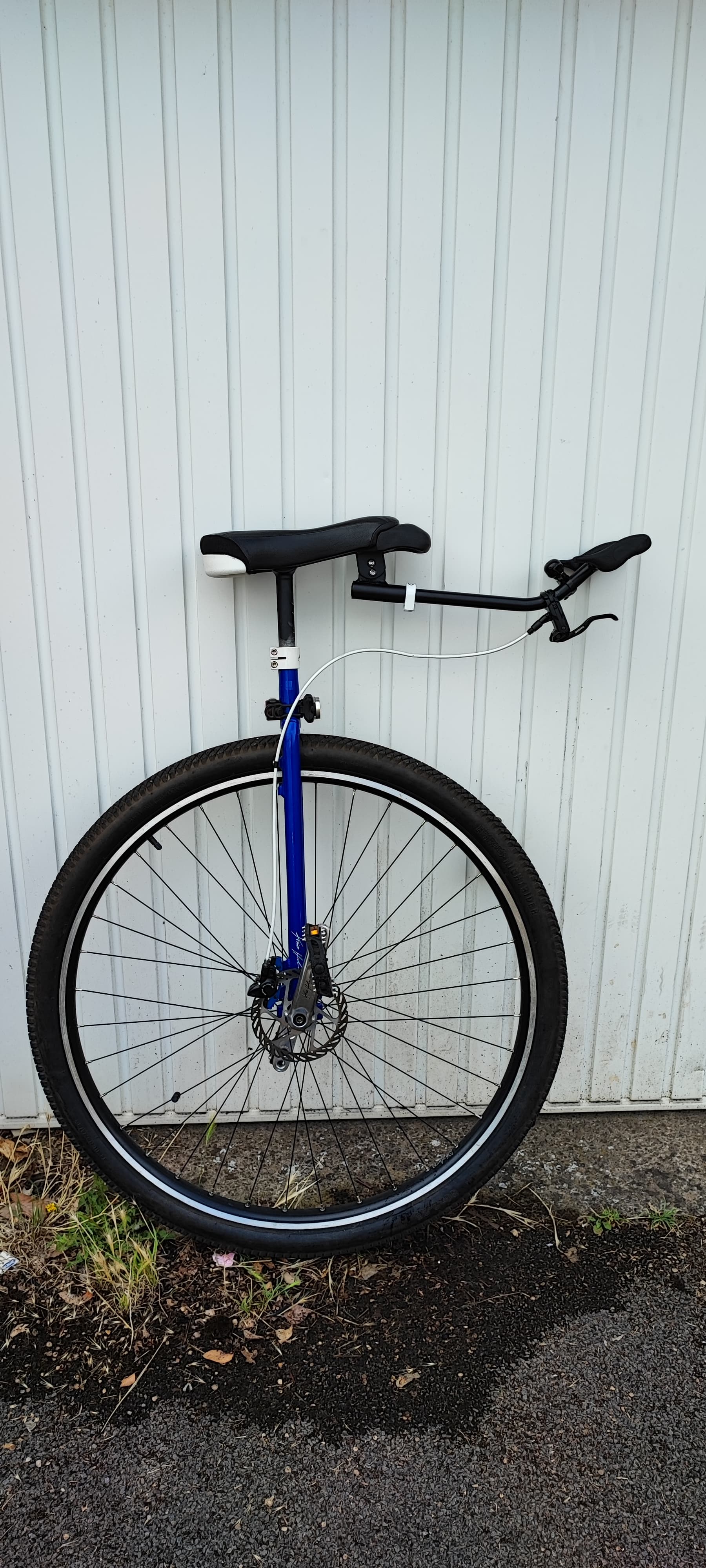

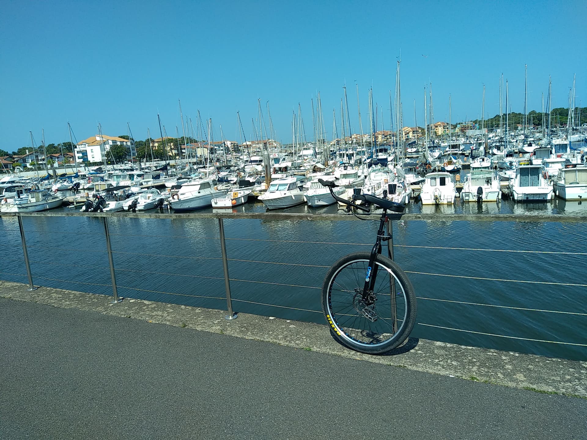

Maybe you could post a photo of your uni to see the setup.
Here is mine.
This is roughly my current set up
Nice uni!
Our setups are quite similar!
The handles seems a little bit lower than on mine.
What length do you use on your cranks?
Thanks, I use 137mm currently, do you think raising the handle would help?
Having your handlebar as low as you do seems like it would place a lot of pressure on your hand and cause you to lean forward a bunch, possibly putting extra pressure on your back as well.
But, I normally never make a comment on people’s setups if they are happy with it, because everyone is different.
Raising your handlebar will allow you to sit more upright (I’m not sure if that’s a benefit to you).
I do hope you figure out how to relieve the pressure on your hand while riding.
