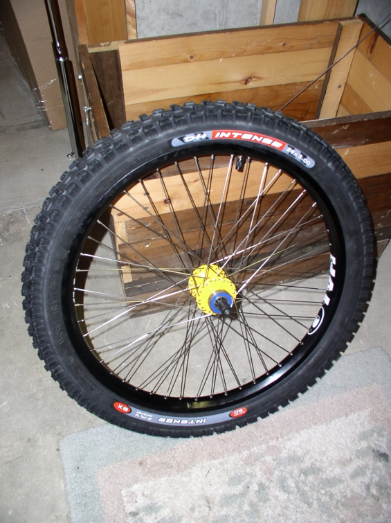

I did a 48-spoke QU-AX / Halo Contra 24" wheel. It seems sturdy but a bit heavy, although I don’t have numbers to back that up. If you do this, use 14/15 spokes to help keep the weight down. The rim has double eyelets. This should be a great wheel for downhills with lots of drops, but probably a little heavy for straight natural trials and 50-50 mixes of slopes.
Do you have any other pics? A closeup of the hub? Are all the spokes the same length?
I’ve never built a wheel before but i wanna give it the ole college try. (wait I didn’t go to college)
Since the hub and rim are both 48-hole, the spokes are all the same length.
A 48-spoke wheel isn’t necessarily the best configuration to start out with because there isn’t as much room to work between spokes and there is a lot more manipulation to true the wheel.
However, my first wheel was a 48 spoke, so go for it!
I don’t have any close-up pics at this time.
