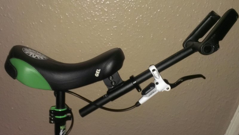

The pic below is how I have my bars just now. I tried out and low, but every time there was even slight road camber I felt it niggling in my lower back…
I haven’t had any problems since raising it and bringing it closer, even did a bit of Muni a couple of days ago! Completely different on a 36er :sunglasses:
Davejh, would you recommend shorter/closer than this for Muni?

Very much so, but i would advise you get a shadow handle section and cut it down so you don’t lose a setup that you know you like. The width of the T needs to come down to 10-12cm if you value your legs. Currently the T is around 5cm forward of the front of the grab handle with just enough clearance to still be able to use the handle for hops.

    In my current set-up (pic above) if I upd, my brake lever can’t hit the floor.
Until I come across any issues, I’m reluctant to cut my bars in any way…I’ll put a few decent Muni miles in tomorrow, weather allowing, and try a few different arrangements :slight_smile:
