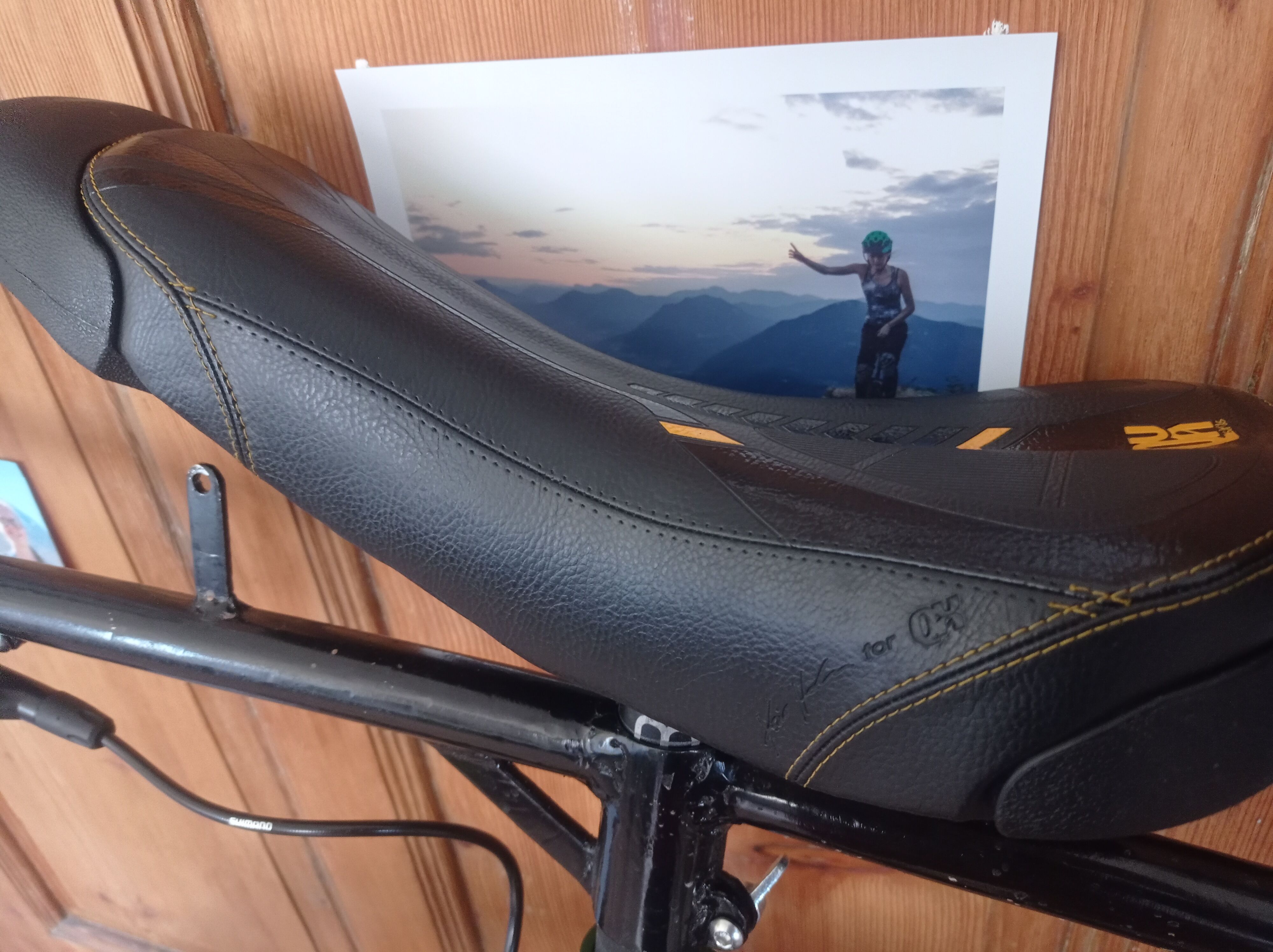

So to the QX eleven: In comparison to the other Kris Holm banana shaped saddels it uses a double density foam, the upper layer is soft and the lower is harder. I just compared it to a Kris Holm Street that I have lying around and the QX seemed to have a softer foam. One thing that I find weird of the Kris Holm saddels as a women is the part in the middle has no foam (Also in der Mitte würde ein durchgängiger Streifen ausgespart, auch als “Pulsrille” und der Einradszene bekannt).
The QX doesn’t have it that extreme. I only had problems with the yellow stiches, they start rubbing after 50 km, but I resolved that problem by cutting them open and pulling them out, the saddle still holds perfectly together since they are not the stiches that hold the saddle. When you ride the saddle for a few years you also rub them off, this just makes the process fast. Since then I didn’t had any rubbing issues from the saddle.
Here a pic of the saddle with removed yellow stiches:
If tne frame can be made to fit, I think the quax would be a good choice for a smaller, female rider. The quax rgb is quite light, which is always an advantage provided it is strong enough. I’m not a huge fan of the saddle, but thats because I find it tends to crush my anatomy. It also gives great control and is otherwise comfortable. Overall, I was very impressed by the quality of mine, especially at the low price point. If you’re 160cm however, then I’m pretty sure the frame of a 29er will have to be cut. The seat tubes on rgb’s are very long. Mine is a 27.5 and I am 185cm. With 170mm cranks I only have about 5cm of seatpost remaining.
The photo is the saddle QUAX Eleven, isn’t it Betty? Thank you for your long text, his help me a lot to choose a new saddle.

Yes, that’s the QX eleven.
