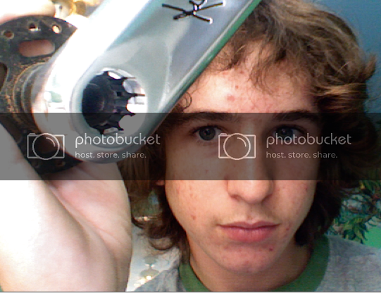

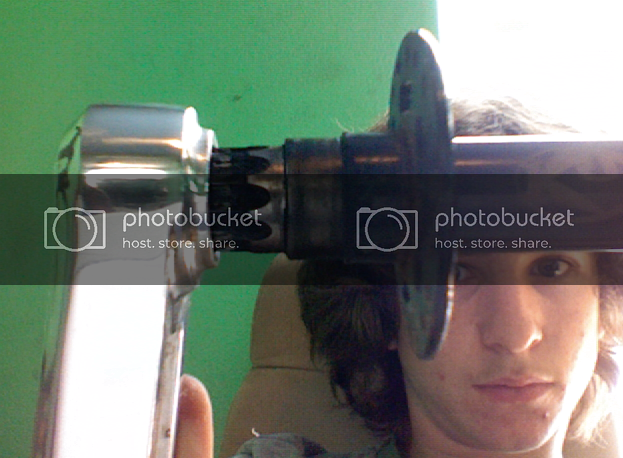

Ok so I tried this out.
The koxx cranks fit very easily onto the kh hub. I can put them on most of the way with my hand before even threading the bolt on. Once they are tighted down I can’t feel any wobbling or anything so I don’t see any problems riding it like that.

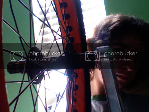

I tried to put the kh cranks on the koxx hub and just like everyone has been saying, it doesn’t work. The KH cranks go on a very little amount then don’t go on anymore, I am just pushing them on with my hands. The cranks won’t slide on enough to even thread the axle bolt in. I didn’t want to force it on so I didn’t smack it or anything to see if it would taper more.
Here are pictures just for fun…
K1 cranks on KH hub
and attempt of putting KH cranks on K1 hub
(It is harder to take a picture with my webcam when there is a wheel attached)
Its pretty low quality but its with the webcam in my computer.
Nice work Spencer!
Is it just me, or does the KH hub have a kind of ball type end, similar to an Allan key with a ball on the long end.
Thank You!
Thanks Spencer!! That is exactly what I was looking for, recent hard evidence. Now, for taking your time… e-mail me (tim@trialsin.com) and I’ll get you hooked with a couple 19" IRC tubes.
Cool, thanks!

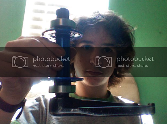

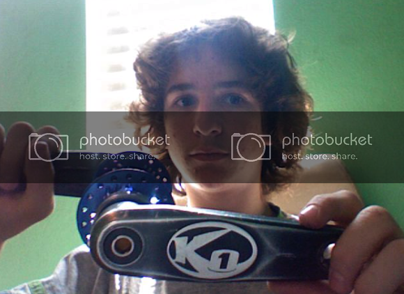

I am lacing that KH hub into my wheel so the koxx hub isnt laced to anything anymore so I was able to take a closer up picture.
This is as far as I can get the KH crank on the koxx hub by hitting it with my hand and like I said before the axle bolt isn’t long enough to even reach the axle.
My attempt to show from the other side too…
Ok, one more thing. I noticed the ISIS bolts that came with my KH hub were much longer than the Koxx axle bolts that I had so I used those and it thread into the axle and I was able to tighten it more, I think I got it about half way on then it got really hard to keep turning and I didn’t want to force it and ruin my splines.
When the KH crank is on the Koxx hub you can see that the splines are slightly different shapes. Not sure if its supposed to be like that, I would assume not.
