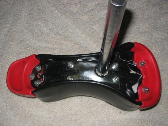

Next, I had a friend of sew up 3 custom covers (one for each uni) and installed one of them on my Miyata saddle base
pretty!
I only got to ride it about a mile tonight. Although it is considerably more comfrotable than the original saddle, I’ll probably take it apart later and fabricate an air pillow to fit it

Although this set-up was a great improvement over the original Miyata saddle, I decided to convert it to an air saddle of my own design.
Here’s a pic of the air saddle cushion
I hollowed out the bottom of the cushion so that it would “cradle” the inner tube to aleviate that “wiggly” feeling inherent in other air saddle designs
Today, I got to give my new air saddle design a true test. I headed up to the “hill country” in Texas and Muni’ed on some rough singletrack for close to 7 miles. The saddle performed flawlessly and withstood many, many impacts with the trail. I haven’t ridden offroad since October and had mulitple UPD’s (but my body only hit the ground once)
This has got to be the most comfortable saddle that I’ve ever ridden. Tonight, about 6 hours after riding, my back’s a little sore from being “out of shape” from not riding for 3 months but my “sitting area” feels like never even rode!!!
I’ll definately be making a couple more of these. One for my Coker and one for my 28’r :slight_smile: :slight_smile:
