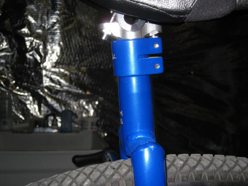

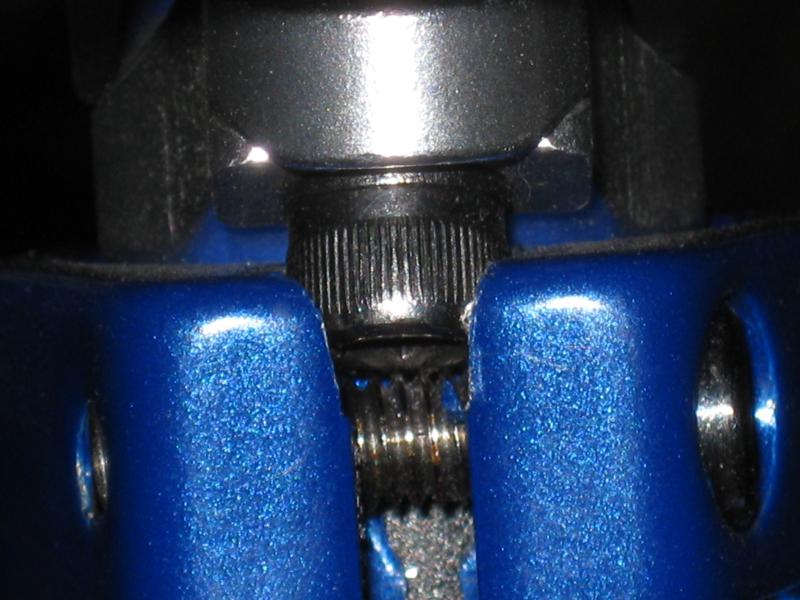

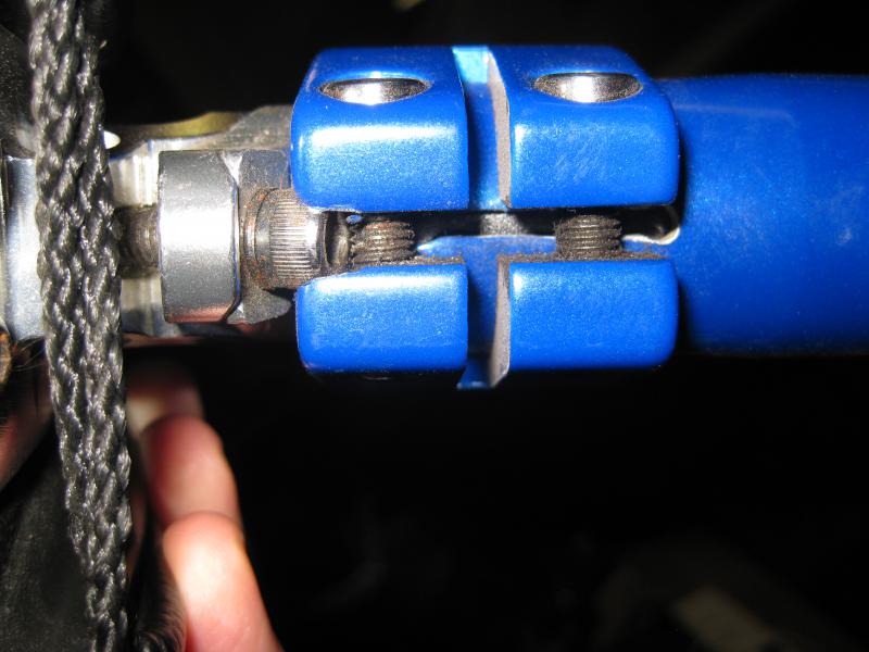

If your near Poughkeepsie NY, you can try my cut down KH 36. also with some carefull drilling, you can allow the head of the seat post adjustment screw to recess about another cm into the top of the seat post clamp.
I have a ~28" inseam, measured by the pant size. Presently using 145 cranks. I had to cut my KH 36", but not my 29".
Here are pictures showing the cut down frame with the seat post head recessed into seat clamp. You can see where the bottom of the original frame slot, just below the top seat clamp screw.
