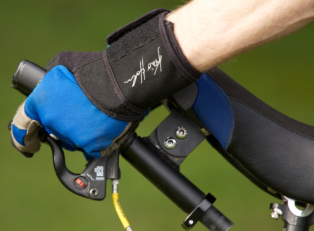

Kris, my other hero (sorry for the use of the picture John but it’s just so darn sexy) has his brake lever mounted half-way-up rather than way out on the end in the T-bar position like mine (2nd picture). Granted I’m talking about Distance riding with a slightly different (Shadow) HandleBar but the concept is the same. My left “braking” hand never leaves the handle. I use my right hand to recover my balance (when it gets too bumpy to hold on with both) so I want my lever handy (pardon the pun). Most of the 36er pictures I see have the lever mounted half-way-up (like John’s) presumably to simulate braking from the saddle handle. I would be interested to hear from both you and John on this subject as I could not imagine mine any other way.
The difference between touring and muni, in my view, is that with muni there’s often the need to pull up on the handle while simultaneously braking, say to go over a bump while descending. Plus with XC you often want to have your hands in a “distance” position while being able to pull up over bumps on up-and-down terrain.

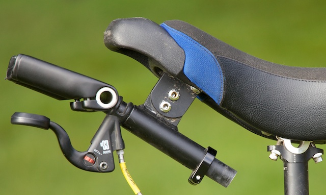

Attached are a couple of photos of my T-bar setup for muni (since this photo was taken I’ve moved it about 10 mm forward and 10 mm up). Flip the slotted tube around so it’s oriented towards the back. Cut the T-bar shorter, and cut it narrower to 120 mm width so it avoids the knees (also makes it easier to reach the brake). You can raise it up just so that there’s plenty of room for your knuckles when curling your fingers around the saddle handle. In the very beginning I did find it slightly strange to brake from this position but it was only because I was unfamiliar with it; now it feels totally natural.
In this orientation I have no problem pulling up hard on the T-bar over XC-like singletrack bumps, and on bumpy descents while braking. The lower position keeps my arms fairly straight which is less tiring when leaning on it. For steep climbing I want my hand facing back and as close to the saddle as possible, so I use the saddle handle.
I find this combo really helpful for XC Muni, and wouldn’t ride without it now that I’ve gotten used to it. I prefer it to an asymmetrical handle that would replace the plastic saddle handle because I find that I use different positions depending on the kind of riding.
Kris

As was just mentioned I don’t think the brake lever is exposed to damage any more on the T-bar than under the saddle; maybe less if you push it further back. For riders trying it offroad for the first time I do suggest keeping it on for a while, certainly more than just a few rides - I also found it strange at first but now prefer it.
Kris
