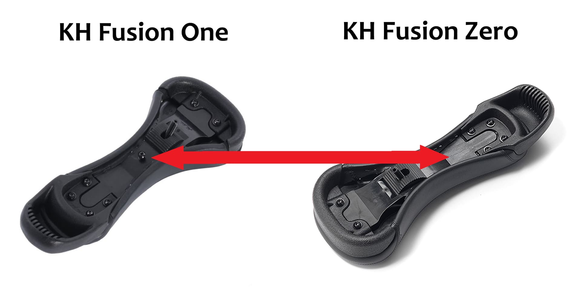

I have the KH Fusion Zero on my 26er and want to put a touring handle on, but the Fusion Zero only has the four holes for screwing in to the front handle, it doesn’t have the extra screw hole/s by the stem.
Given this, is it worth attaching a reinforcement plate?
I think it isn’t needed with that saddle
T-bar touring handle compatible with no requirement for the reinforcement plate.

I could swear I’ve seen someone add a rivnut to a Fusion Zero for that purpose, but can’t find it…
My mechanical instinct says without that bolt, a reinforcement plate would be completely useless.

I use one on my zero and it definitely stiffens it up without the rear bolt. The rear of the plate sits against one of the pivotal notches which helps with downward pressure on the bar.
Without the plate the zero has noticeable flex with a mid length road bar setup. you may not notice it with a short bar

I ran a Zero without a reinforcement plate and a short-ish bar setup on my 36er for over a year (riding daily) before it was stolen, and it was OK. A bit of flex was noticeable, but my main concern with the Zero and longer bars would be snapping the hollow pivotal bolt.
If you keep it really well tightened up then you should be OK, but a friend of mine snapped two of them.
You can modify it to take a solid bolt, but it requires total dismantling of the saddle (stapled cover, glued foam).
