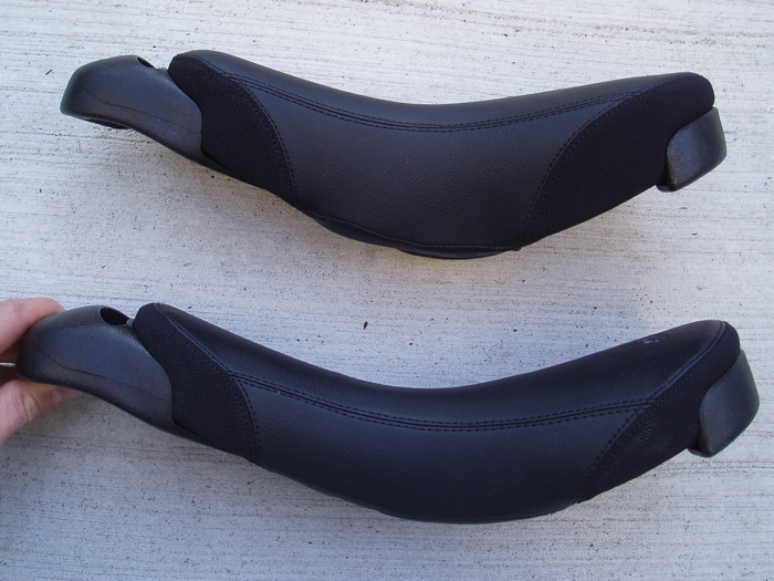

Right now the seat bases are the same as the 2006 base. The front area is the same width, and personally I like this width. But the point of having a removable cover is that you can modify the foam to personal preference, so you could still do that.
Attached is a photo showing the profile of the 2 saddles. You can see that the foam profile is the same height in the front and back (sticks up only about 10mm above the bumpers). But in the case of the Freeride I reduced the curvature which increases padding thickness in the middle. This seems to be a lot better for increasing shock absorbancy and for decreasing pressure on the front of the saddle. But if you don’t like it you could still just take the saddle cover off and cut the foam to whatever shape you like.

I also really like the shape of the foam on the new Fusion Freeride along with the center cutaway. That is shape I’ve been trying to get for my Coker saddle by carving up the old Fusion foam. I’m going to have to get the new Fusion Freeride saddle (or just the foam if UDC will sell it that way) and try it out. The quest for a better Coker saddle knows no ends.
+1
I don’t have a Coker, but the shape looks ideal for long rides. It’s very similar to the shape that my modded old Fusion has taken on.
