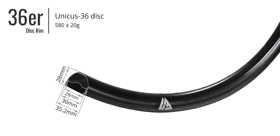

Anyhow, that aside, LightBicycle recommend 120-130 kgf for their Unicus-36 rim, their 700c rims seem to be about 120-135kgf, so it seems wheel diameter isn’t too important a factor, for carbon at least.

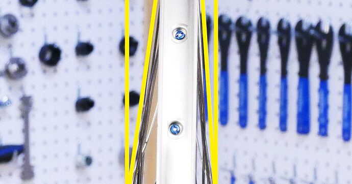

I think the general advice is that carbon rims should be tensioned higher than aluminium, which seems to fit in with the numbers of 100-120kgf mentioned online. I seem to remember guidance that it is relative tension (between spokes) that is more important than the absolute tension, which would be consistent with Park Tool’s guidance regarding squeezing spokes to find something that feels right.
