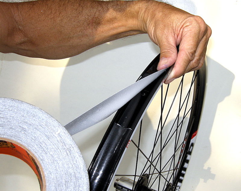

Thank you for the clarification. I do have a cut-out rim on one unicycle, but I will try out the tubeless on something else for now. I will probably try some 25 mm tubeless tape as you have recommended. Here is a blurb about gorilla tape that sounded promising:

Scott,
I’ve done mtb rims with the gorilla tape, and it works great. If you decide to go that route, skip the potential trip to the emergency room by not cutting the tape like they recommend. Gorilla tape will tear straight, clean, and true once you get it started. So, nip the end of the tape and carefully start spooling it off. No need to cut through multiple layers.
I’m not sure how it will deal with sagging through the holes of a cutout rim - guess there’s only one way to find out! Were it me, I might try with a layer of spinnaker repair tape which is a rip-stop nylon tape. It’s super light and quite strong in a tensile way. I’d overlay that with a layer of gorilla tape for the air-tight (and sealant proof) layer.
