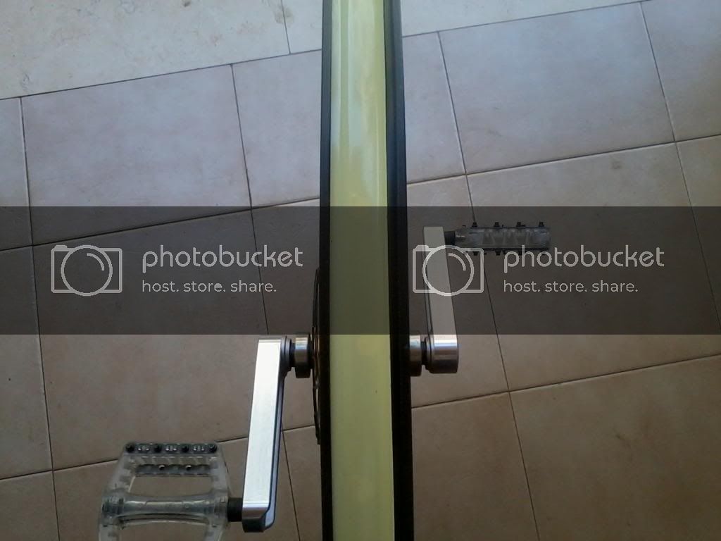

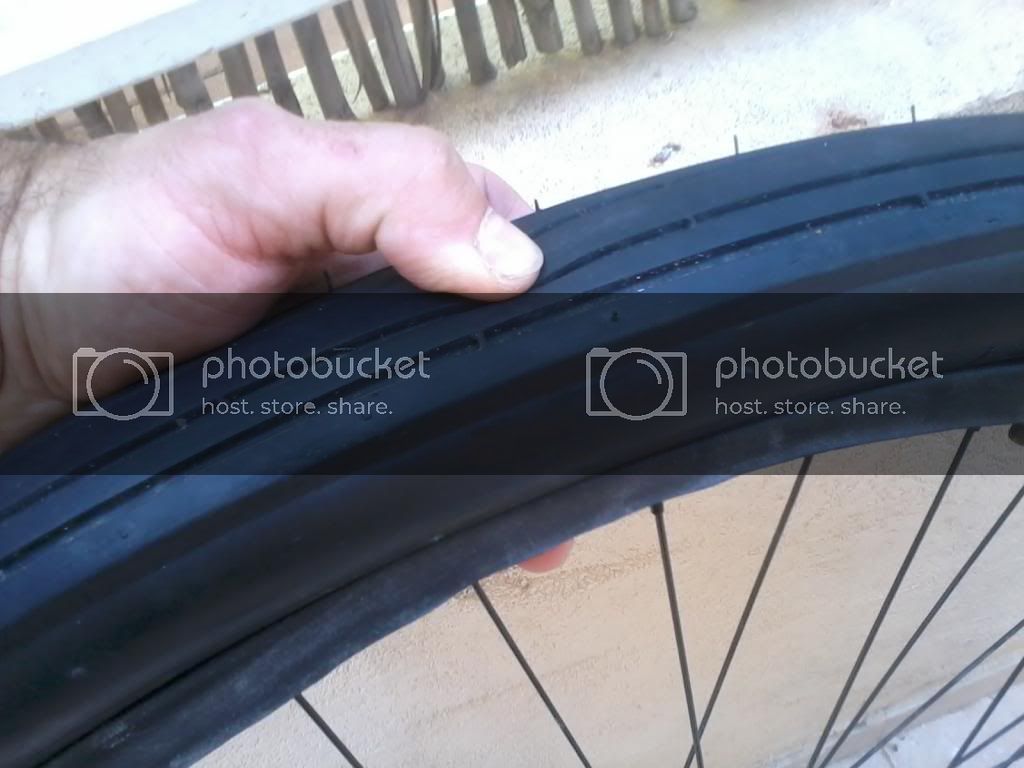

Here are the pics below, enjoy.

It gets even better:

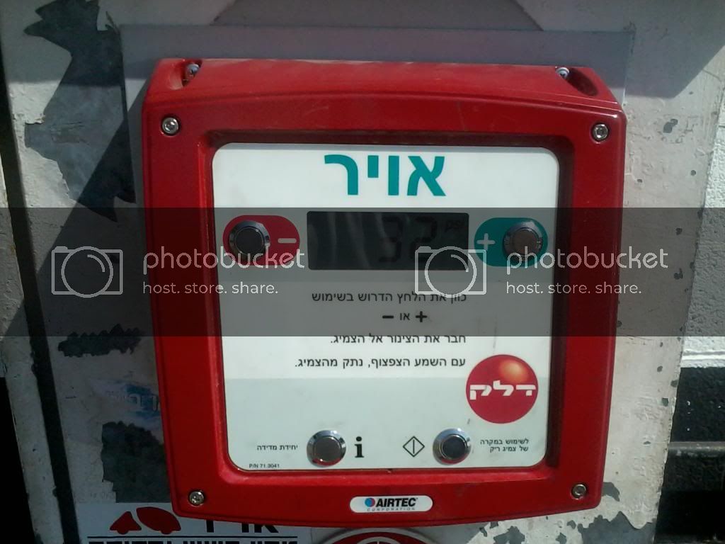

But guess what? The gas station’s pump could :slight_smile:
Look at this beauty!!!

A short update: today after 24 hours of the 36" tire holding air in 32 PSI perfectly the same as it was yesterday I’ve added the sealant (had to deflate and inject via the valve without its core) and took it for a short ride.
You may say it’s psychological, but I gotta tell you - it feels like feather-light in comparison with how it used to feel with the inner tube. It’s like riding a 26" wheel or at least 29" wheel.
