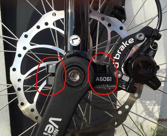

I feel a slight click when I move my frame. I got off the unicycle and investigated by rolling the wheel forward, back and side to side. It seems to be coming from one of the bearing holders. When I looked closer at the bearing holders I found that there is much more space between one screw than the other (it’s this way on both sides). I can see the screw through the gap on one side but not the other. Shouldn’t they be more or less level?
Yep.

Ok I’ll have to adjust and tighten them. I haven’t touched them since I first took the uni out of the box last week. The frame was already on the wheel and I figured UDC would have put it on correctly but I guess they didn’t.

Here are photos of the holders. Maybe they did it this way because of the D’brake. There is no space on the right side bolt of the bracket but tons on the left side.
Thats the way it has to be. Don’t change this! Allways tighten the right side first, really tight. And then tighten the left side, handtight. It’s because of the d’brake.
Aha, I didn’t know you had the d’brake bracket on your uni. Yes, you’re meant to leave a gap of 3mm on one side. Your set up looks fine.
I have the d’brake instructions here and it says that on the disc side you should fully tighten the bearing cap on the side where the caliper is mounted and leave a 3mm gap on the other side.
On the non disc side tighten the bearing cap bolts screws to normal tolerance.
Oh, didn’t know we were talking D-brakes. Leave it be.
