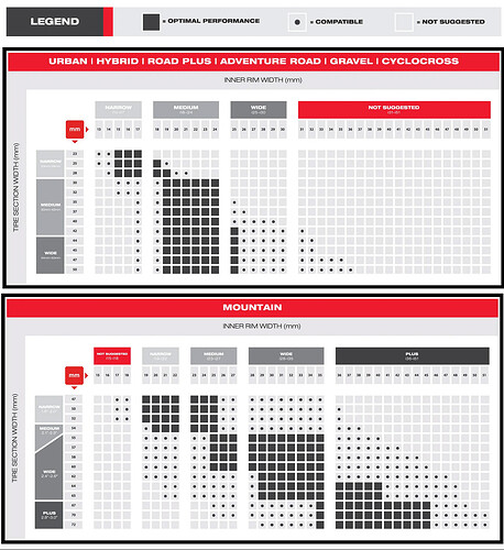

Its late here so I don’t have time for a long answer… but here is a chart to start the discussion (while I sleep)
Source: Tire & Rim Fit Chart – WTB

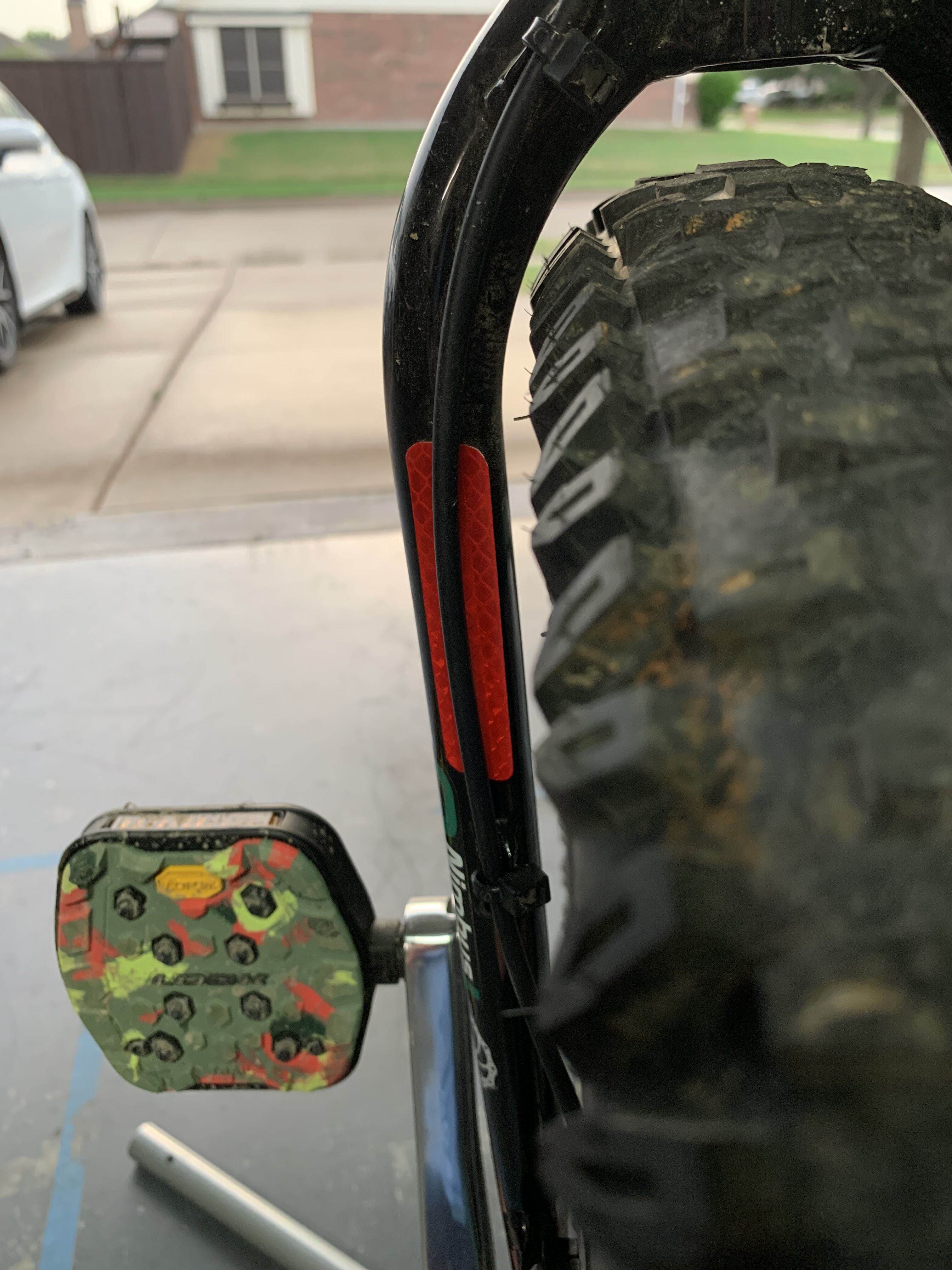

I was wondering something along the same lines thanks for asking. In my case I have my Nimbus Oracle 27.5 with a Duro Crux 3.25 Tire and 42 mm rim, which I have no complaints about except that the tire rubs against the frame.
I was wondering if dropping to a 3.0 Tire would be enough to stop the rubbing or if I would be a better off with a 2.8. It seems like it’s somewhat difficult to find much selection of 27.5 x 3.0 tires.

Thats the stock tire for that cycle right? I’m certain it is. Sounds like you may have an issue with dishing with that wheel. It shouldn’t rub.

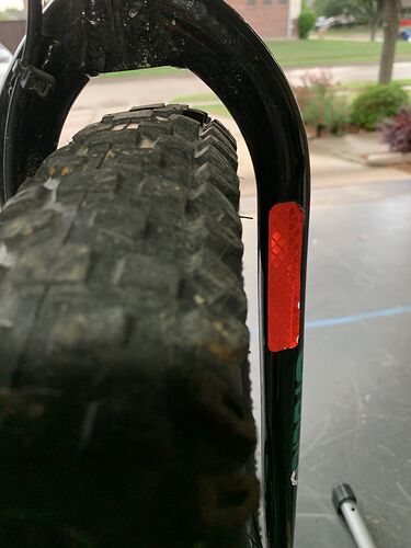

Yes all stock. There is very little clearance between the tire and frame, like 2 mm or so on each side. Somewhere around here I’ve got a picture of it…
The oracles used to come with a 3.0 tire from what I hear, I wasn’t sure if they widened the frame more to accommodate the switch to 3.25 tires and or if maybe I got an older frame or something.
Yeah, I have the green Nimbus MUni version of that 27.5, so I’m familiar. I’ve had to dish that wheel at one point.
Share some photos. Might be able to help.
I posted some pictures here where we were talking about frame Flex:
Huh. And it never got solved? I need to go look at mine with the Crux. I know it was tight-ish, but I never had any issues.
I was wondering since the steel one is newer if they made the frame wider there or if it just flexes less because of it being Steel but yeah I’ve more or less just been living with the annoyance planning to someday buy a smaller Tire
Be aware those charts don’t give a perfect answer to how to eliminate things you don’t want your tire to do. It may help you, but you’ll definitely have to try it out to be sure. E.g., I have a 32mm rim (EN732 from LightBicycle) that I use with a 3" tire. That works perfectly, the tire behave as I want it to behave while it is not recommended by this chart.
As a matter of rule, I’d usually go for a narrow rim/wide tire combination to avoid the square-tire effect. The 2.6" Rekon may be better in that case.

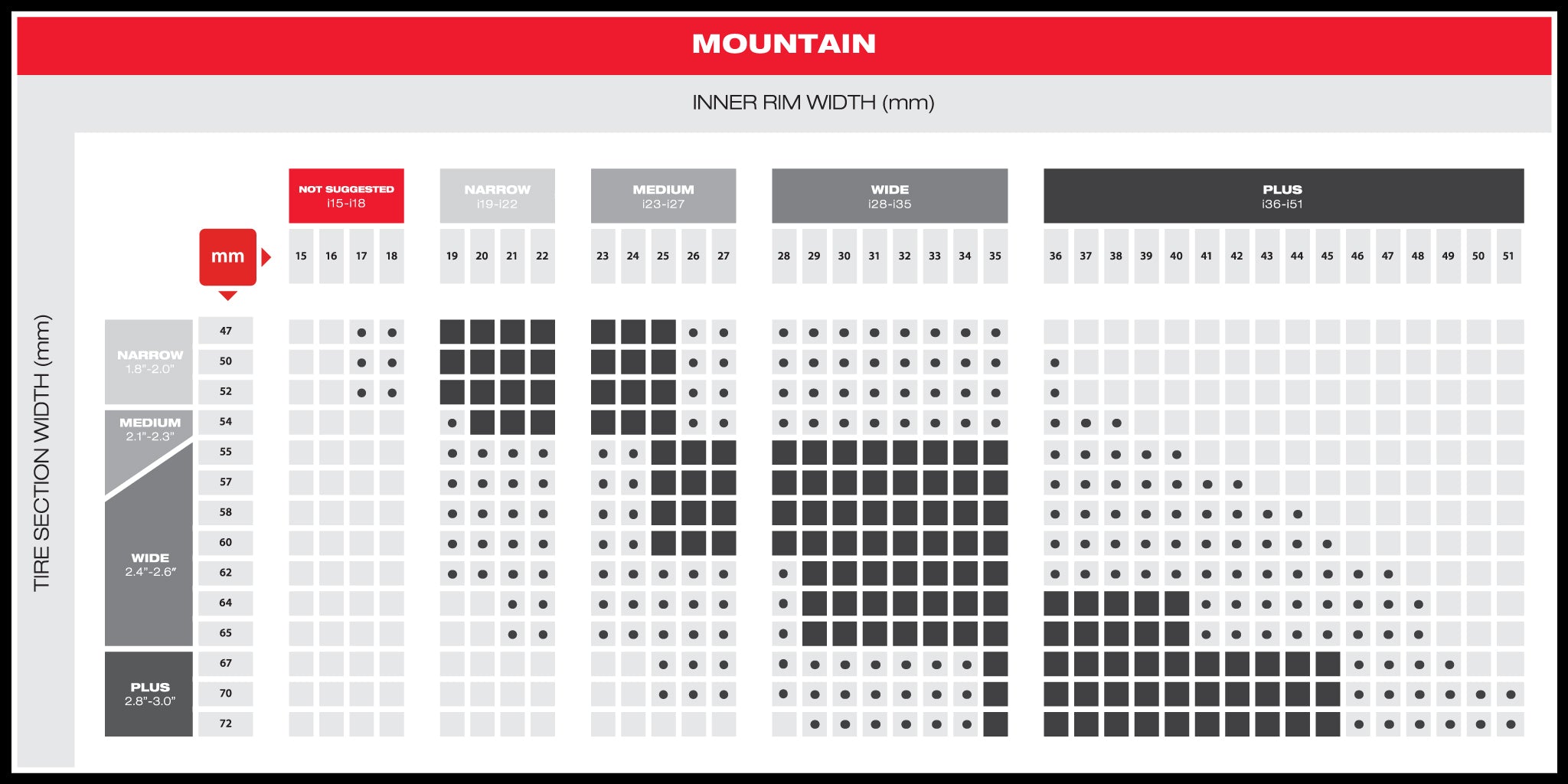

Here is the rest of the chart with the legend:

According to UDC when I called via phone, the 27.5 frame was widened when they switched from the Kenda Havok 3.0 to the Duro Crux 3.25. The gaps on my frame measure 6mm on the right and 4mm on the left.

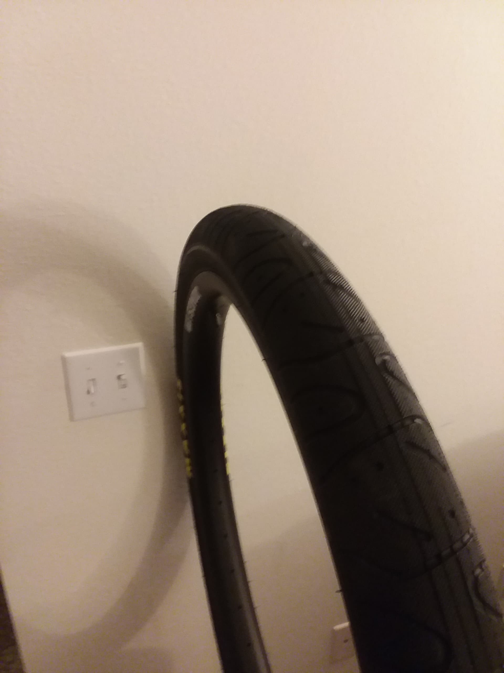

While waiting for the hub to arrive, I’ve ordered: Maxxis Hookworm (29x2.5) = 63.5mm width. Jones C-Rim (29x56) = 49mm inner width. This puts me right into the “not recommended” range. I’ve mounted the tire on the unlaced rim, and it has the right “look”.
I’d be curious to get your review once the wheel is built. I have tried a KH Freeride rim (50mm inside I think) with a Maxxis Grifter 2.5" tire and that was lame. The tire was square and it was horrible when trying to turn. I hope yours will behave better.
I believe with a round tire that is usually run at higher pressure like the hookworm, you can get away with being outside the range more than on a low pressure MTB tire with a square profile.
Especially since it’s a BMX(-ish) tire, with tread pretty much all around.
