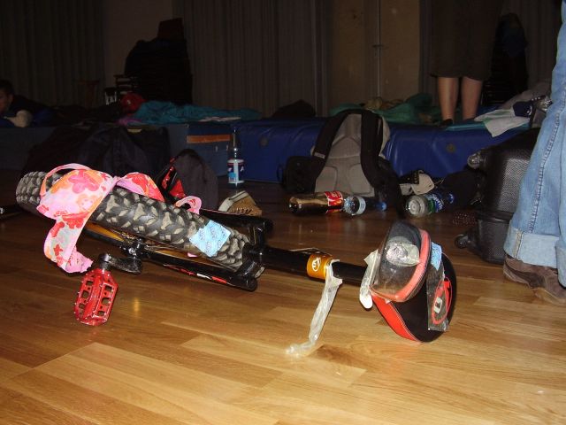

This is a f*cked unicycle
:slight_smile:
HAHAHAHAHAHA
They hide my uni and abused it! But it was great fun @ wunschkonzert (Freestyleconvention near Frankfurt).
