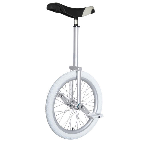

The Nimbus E-Sport wheel is nominally a 26 inch wheel (559 x 22 rim) and with a 26 x 1 tyre, comes in comfortably under the maximum 618 mm total diameter for a Standard racing wheel. It has a narrower 92 mm wide hub. The low inertia of the wheel allows for rapid acceleration which does help in short races.

Anyway, unicycle.com does list two narrow frame and hub models although I do not see the other, 24" racing model I saw recently.
https://www.unicycle.com/nimbus-e-sport-24-basketball-unicycle/
This is the E-sport Race at the Australian site.
If you do want a 24" race uni, check out the mad4one options in a range of interesting colours
