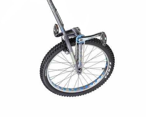

I was looking at pictures of trials bikes like this one:
I’m wondering if the design of this kind of bike could be used to make something in between a unibike and a penguin. It would be like a unibike because it would be the back half of a bike but my idea is the unicycle seat post would not go where a traditional seat post goes (this trials bike doesn’t even have that) but in line with the bike frame. This makes it somewhat like a penguin except the chainring is not directly in line with the “bottom” sprocket. It’s located very close to the tire so extends the height as little as possible. It also may be protected by saddle handles on UPDs but chain ring protectors may also help.

I think sticking a seat so it’s in line with the top tube would almost create a recumbent uni… Your pedals would be further forward than normal alway, I would think.

It could work great, though I assume Trials bikes have freewheel hubs. You could keep the whole frame, take off the front end and even attach a separate seat tube, maybe where the top of the fork used to be.
That’s what would be cool about it. The stuff doesn’t have to line up for it to be rideable. Just remember that it’s going to be oriented underneath the center of mass of the rider, so that’s how you figure out the angle it will stand up at.

The angle between the seat stays and chain stays in trials bikes is very acute and sometimes nonexistent. My thinking is that this would minimize the crank offset vs. doing it with a regular bike.
