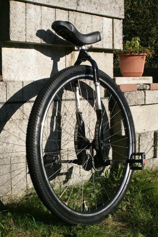

Has anyone ever heard of a Huni-Rex unicycle? Apparently it is a G26 without a Schlumpf hub, or other geared hubs, but instead has a giraffe type hub with a short chain to make it geared.
Here is the website:

These are really heavy, with increased chance of pedal strike and they are still fixed gear. You can’t change gears. You can basically achieve much of the same with shorter cranks. Why have chains and more machinery to maintain than on a regular uni? The only thing you get with a Huni-Rex is lower cadence on a smaller wheel.
There is a reason why these went out of production.
Are you sure production has stopped? I get the impression that production is continuing and that sales are being made directly on Facebook. It’s been going on for years. It seems to me that chain tensioners are now fitted to the Huni-Rex, whereas this wasn’t the case a few years ago.
I’m lucky enough to have a Schlumpf, but for someone who doesn’t, this is a way to try out the Schlumpf at a lower cost. For me, it has nothing to do with riding with short cranks. I have long been convinced that short cranks do not allow you to use all the strength you have in your quadriceps. When the road climbs or the gear ratio is higher, pedaling is no longer just about how fast you can turn your legs.
The Huni-Rex has plenty of flaws, and if I had to choose between a Huni-Rex and an ungeared 36“ (with a carbon rim), I would choose the latter. But the Huni-Rex costs 10 times less than a high-end 36”.

For someone who likes to tinker, it’s not bad. Yes, you have to be careful when cornering, the chain tension needs to be monitored, the q-factor is huge… But at this price, the curious are generally not disappointed.

I tried a huni-rex last year. It definitely felt weird and took ~20mins before I was successful mounting it. The cranks are indeed lower and I had a pedal strike, or several, while turning and trying it out. The gearing left me with a trippy feeling being so “low” to the ground yet going fast with a low pedal rotation cadence. I would pick one up for my collection if one were available at a decent price. u+1 if always a good thing, despite what my wife says.
