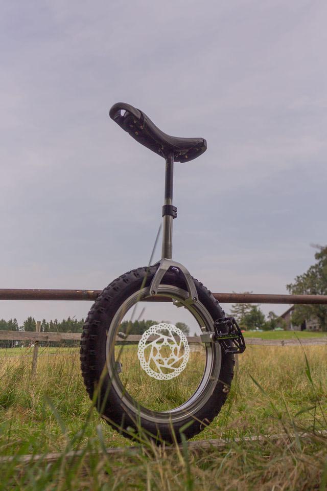

Where is the brake disc going to be? :smiley:
Maybe free floating

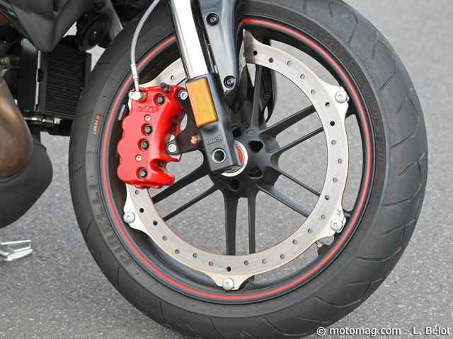

Caliper supported from frame at top under frame to rim attachment point. large diameter disc attached on rim along with pedal mounts similar to Buelle disc on Harley Davidson
Same Solution as on the Buell 1125ers:
Photo from https://motomag.com/
That makes it even more dangerous if your foot ends up through the middle of the wheel. It will be cut straight off

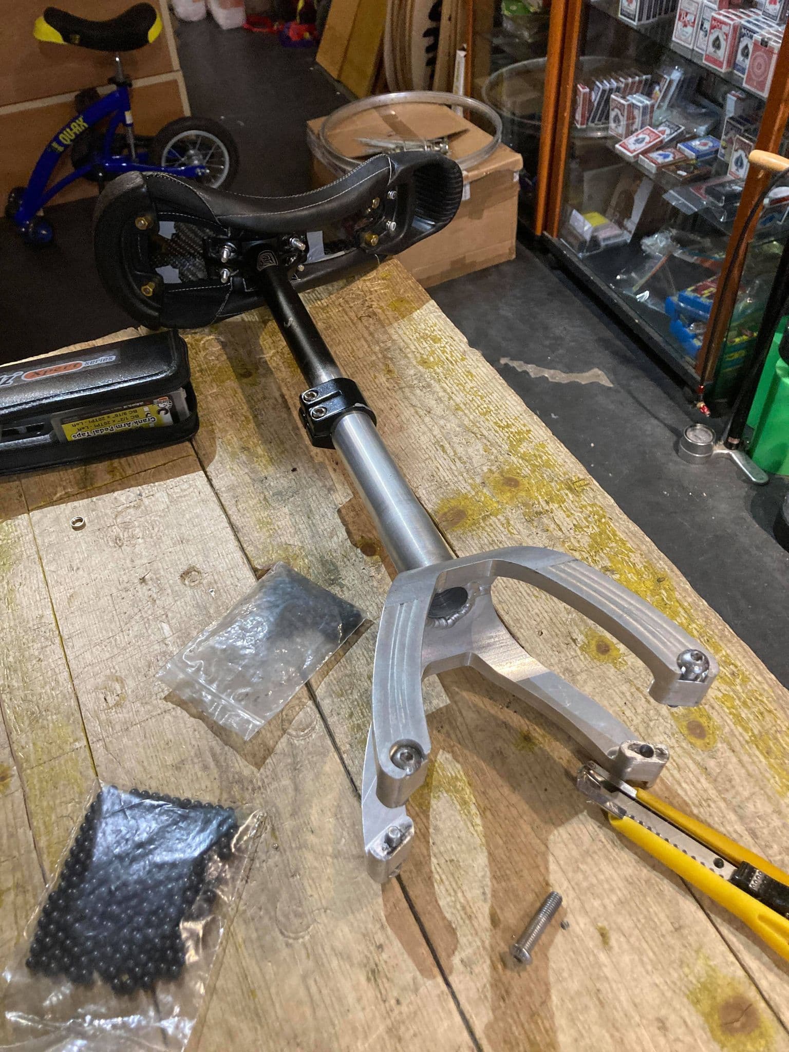

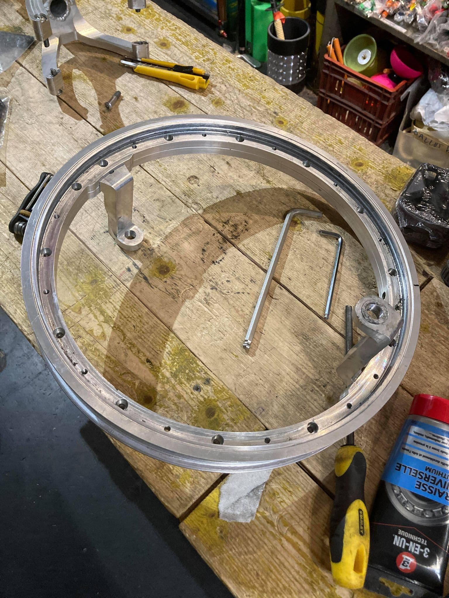

I have had the chance to test the prototype yesterday, so here is a quick feedback.
The first impression I have had was that it is really heavy. ~6 kg for a 20er, that’s a lot for people like me who are used to high-end unicycles. It’s like a carbon 36er :laughing:
It rides like a normal unicycle, there’s no difference in balance. But the bearings need a lot of improvements. Currently, they give the impression that we are riding in the sand or with a disc rubbing on the pads. They make a lot of noise, too.
So, I personally find it’s a great design but it needs some improvements to be useful. Wait and see for the future! :grin:
Some pictures:
