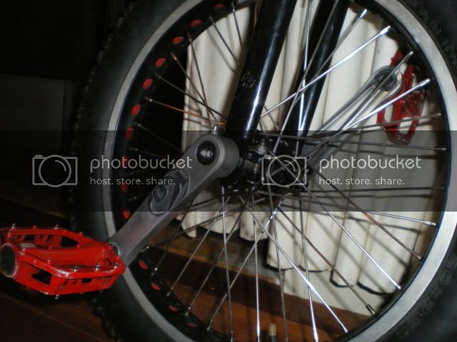

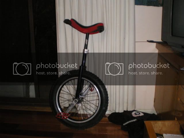

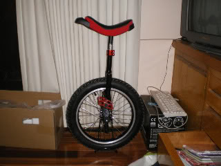

Alright so I de-anodised my cranks and seatclamp today. Here are some pics:
Before
After
The process was fairly simple, I just placed all the parts in the caustic soda, then after about 10 minutes took them all out and rinced them. (Some of the anodising needed a bit of a scrub with scotchbrite in parts.) Then, I polished them up a bit in the tricky spots with the buffer bit on my dremel.
I gave up halfway through polishing the cranks because it was getting dark and I’m lazy… I think it looks way better than it did before and I am going to get rid of all the red in time..
Tell me what you all think,
Mal
