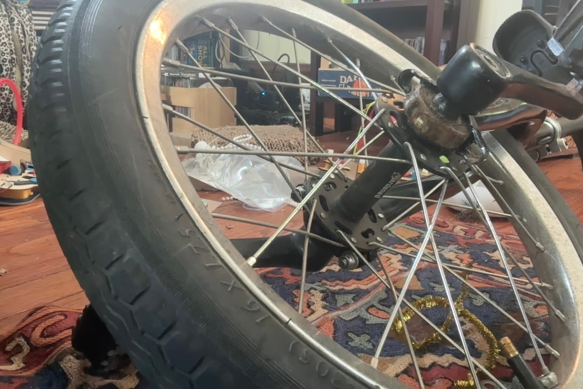

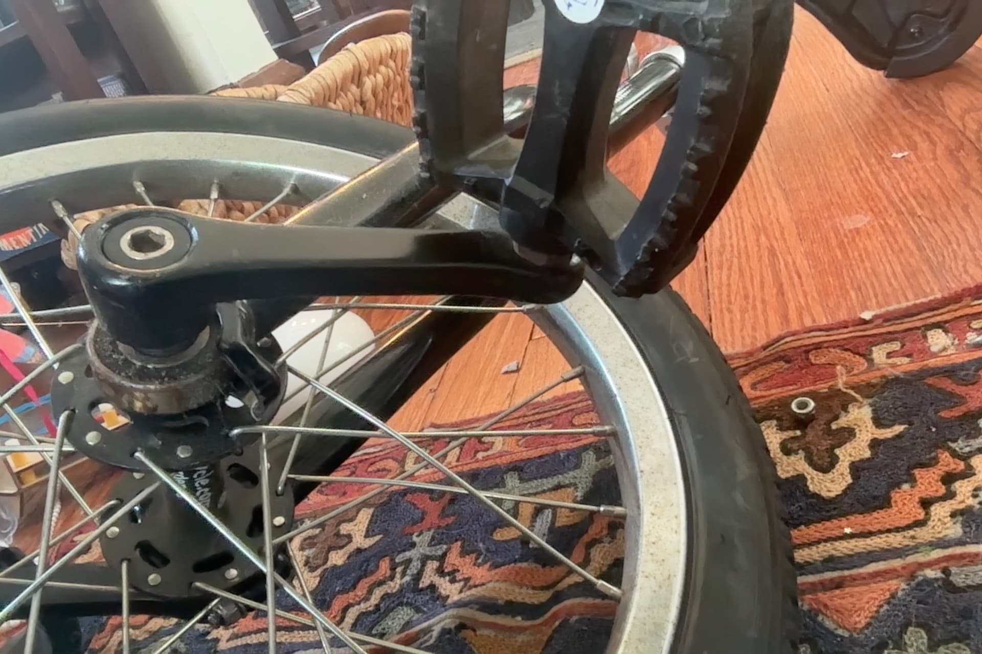

I got really gross bearings on my 16er, haven’t ever been cleaned. (5 years). How to clean without removing from hub?
What is the issue? Just use a rag or paper towel and wipe away the grime. Any cleaner that can be used against grease if necessary, it aint rocket science.
Okay, I just didn’t know if there was some special grease thing to clean it. Never done this before.
Afterwards tighten the screws more carefully than I did when I cracked the bearing shell of my first uni.
Bearings themselves are extremely cheap, I’d say replacing is better than cleaning. But they are certainly shrunk or at least pressed/hammered on the shaft. So you require a bearing puller. Not a fun repair. So as suggested a paper towel is the easiest/safest way.
There’s dirt and grime on the outside of the bearings which is cosmetic. However, with the wheel removed from the frame you can more closely examine the bearings. Check for side-to-side play and gritty/grabby feel when rotated. Those are signs that the insides need to be cleaned and re-greased or whole bearing unit replaced. Cleaning the internals is best done with the bearings removed.
I removed the grime with a paper towel, but it is still rusty. I’m also not sure it is supposed to stay in place inside the frame. The bearings never have spun inside the frame, rather and internal spinning. I am turning them with my fingers, and it moves, but is inconsistent and doesn’t fully roll smoothly. Bearings are pretty cheap though, so I’m leaning towards just getting new ones. If so, would I need a special tool?
I agree with just buying new. You’ll need a bearing puller tool regardless of whether you attempt to clean the internals or just replace with new.
