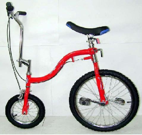

P.S You could make one of these out of the scrapped bikes. :smiley:
