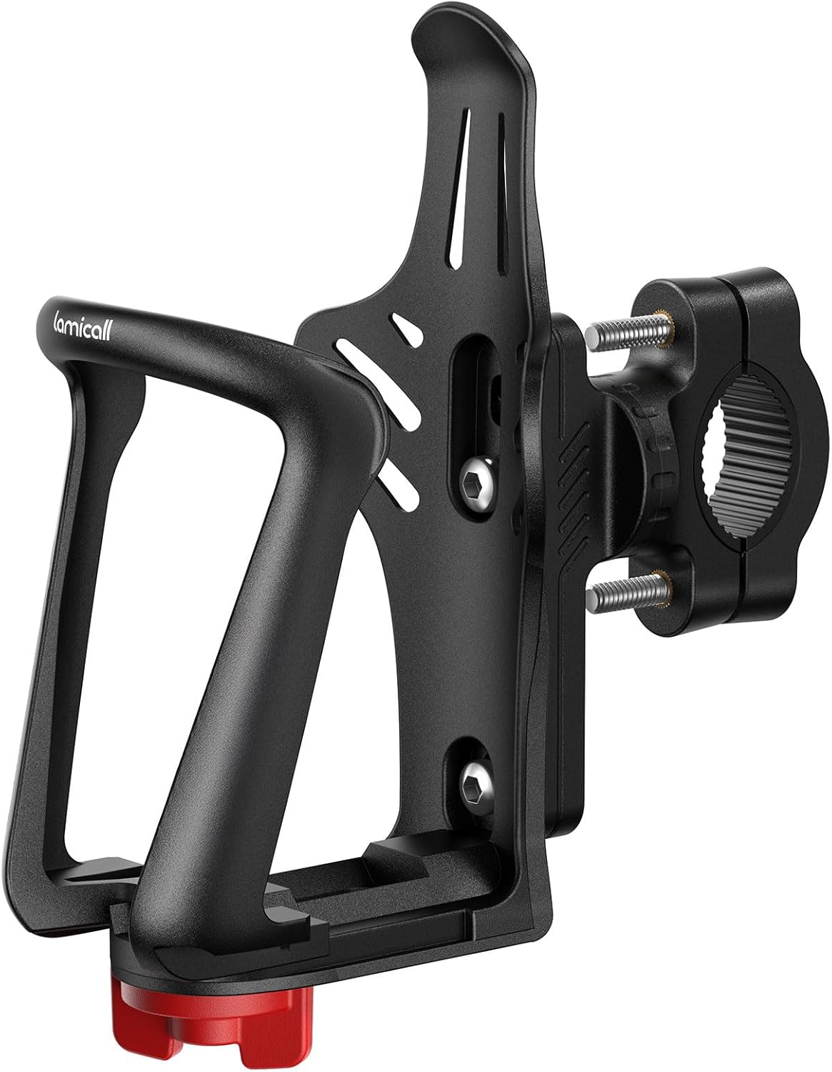

Something like this is handle bar or frame mt, adjustable clamp and 2 postions. It would mount directly on the handle or to the central brake lever mt.
I love the look of that bottle cage that @MadHatchetAndy linked to on Amazon.
Here is the link to the same item sold on the Amazon United States site. It looks like a bottle cage that will mount to the handle of the Handle Saddle, but it also looks like it will mount to the seat post or the seat post tube on the frame of your unicycle.

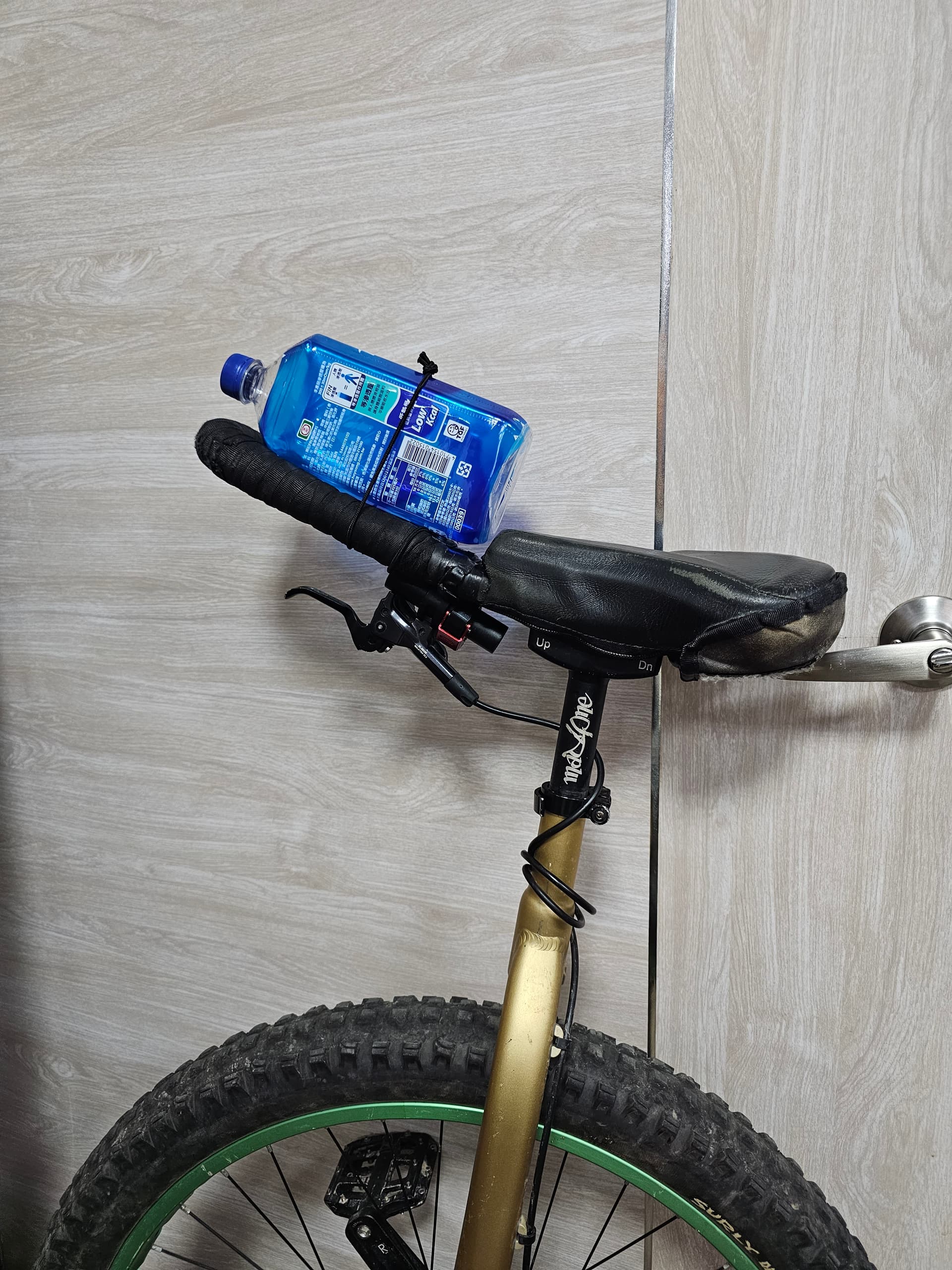

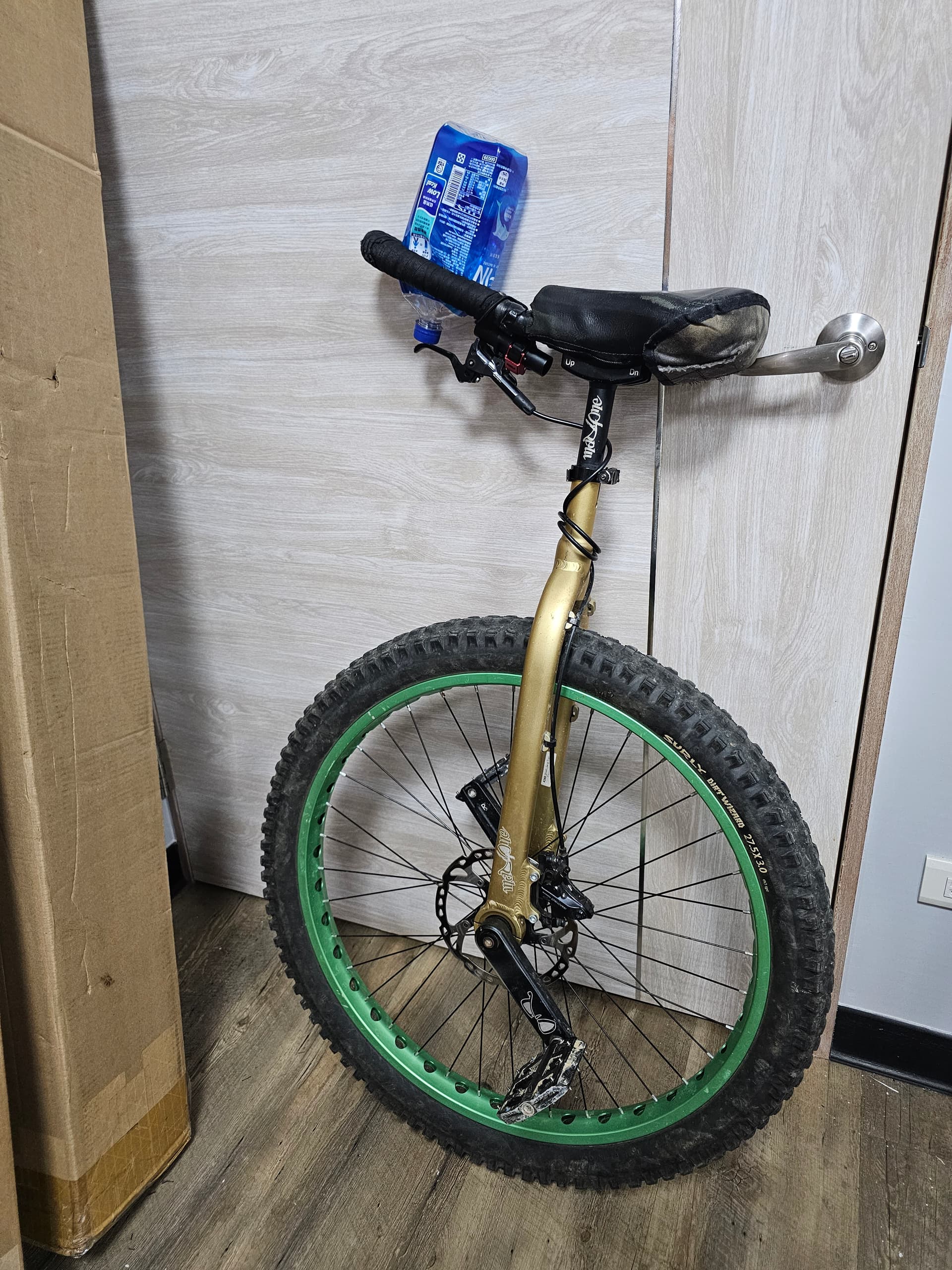

I sometimes carry a water bottle like this when I’m in a hurry. However, when I need to brake, I have to hold the bottle in my left hand.
@Syoten, low tech, I love it, I so nearly mocked one up like this for a joke :grinning_face:. But if it works, sorted.

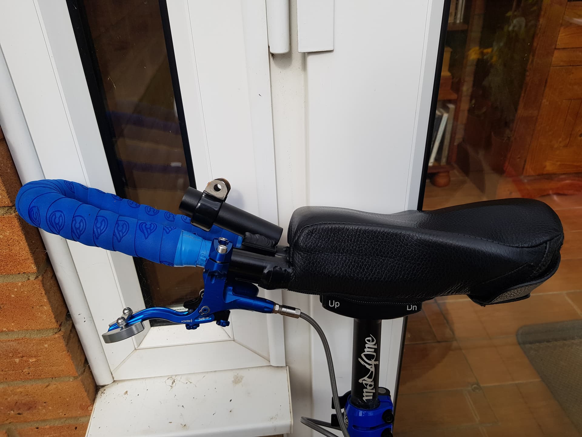

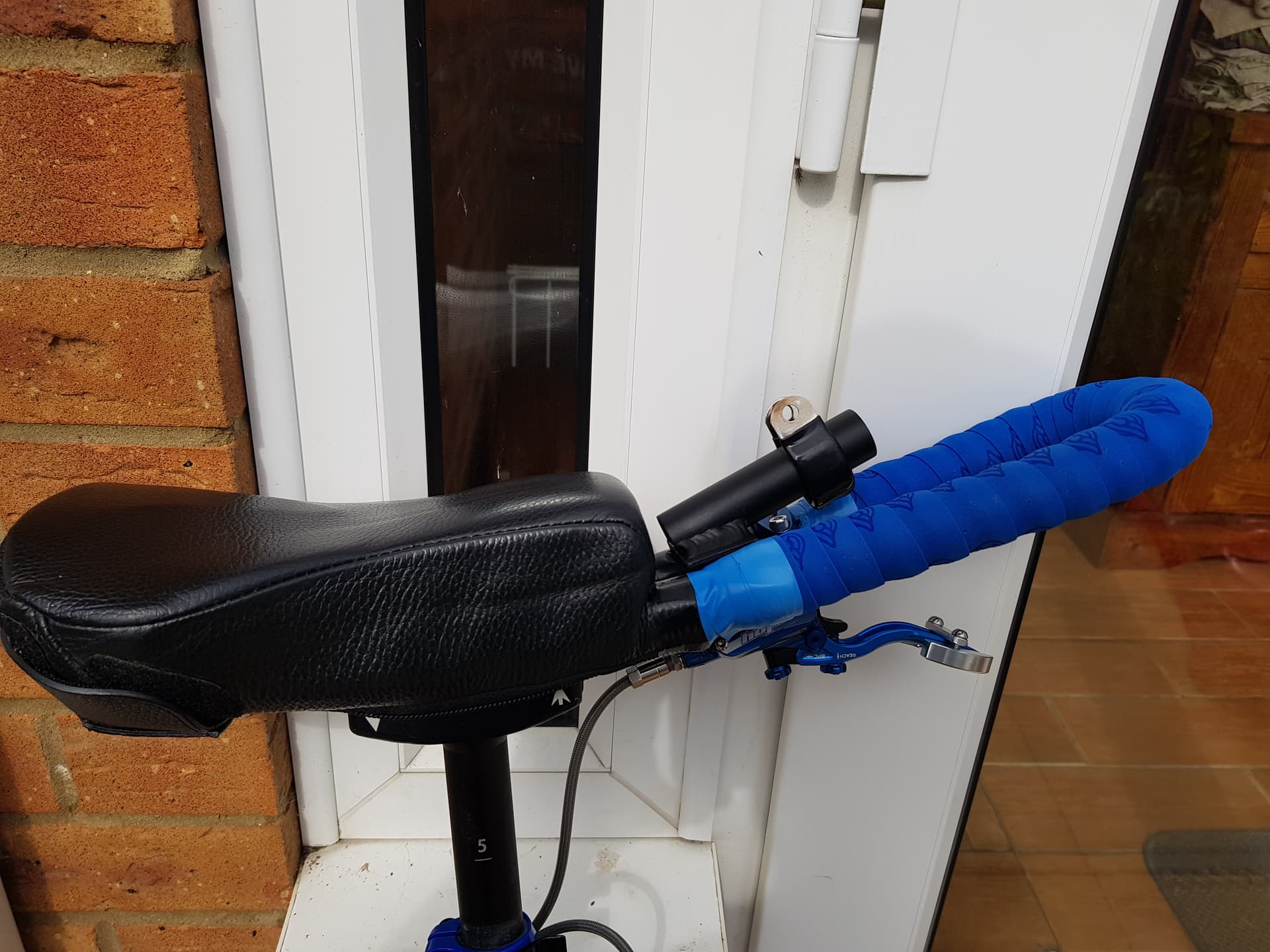

Option 1 Top Mount - put the brake lever on the bars, invert the central M4O brake mount. Then mount the bottle holder to this, see piccy. If you get an adjustable mt you can positon it how you want A 22mm sprung plastic coated P clip to mount to. That gives a good solid accessable mounting point, I might even give it a go. I have been pondering on a une mtd water bottle :grinning_face:

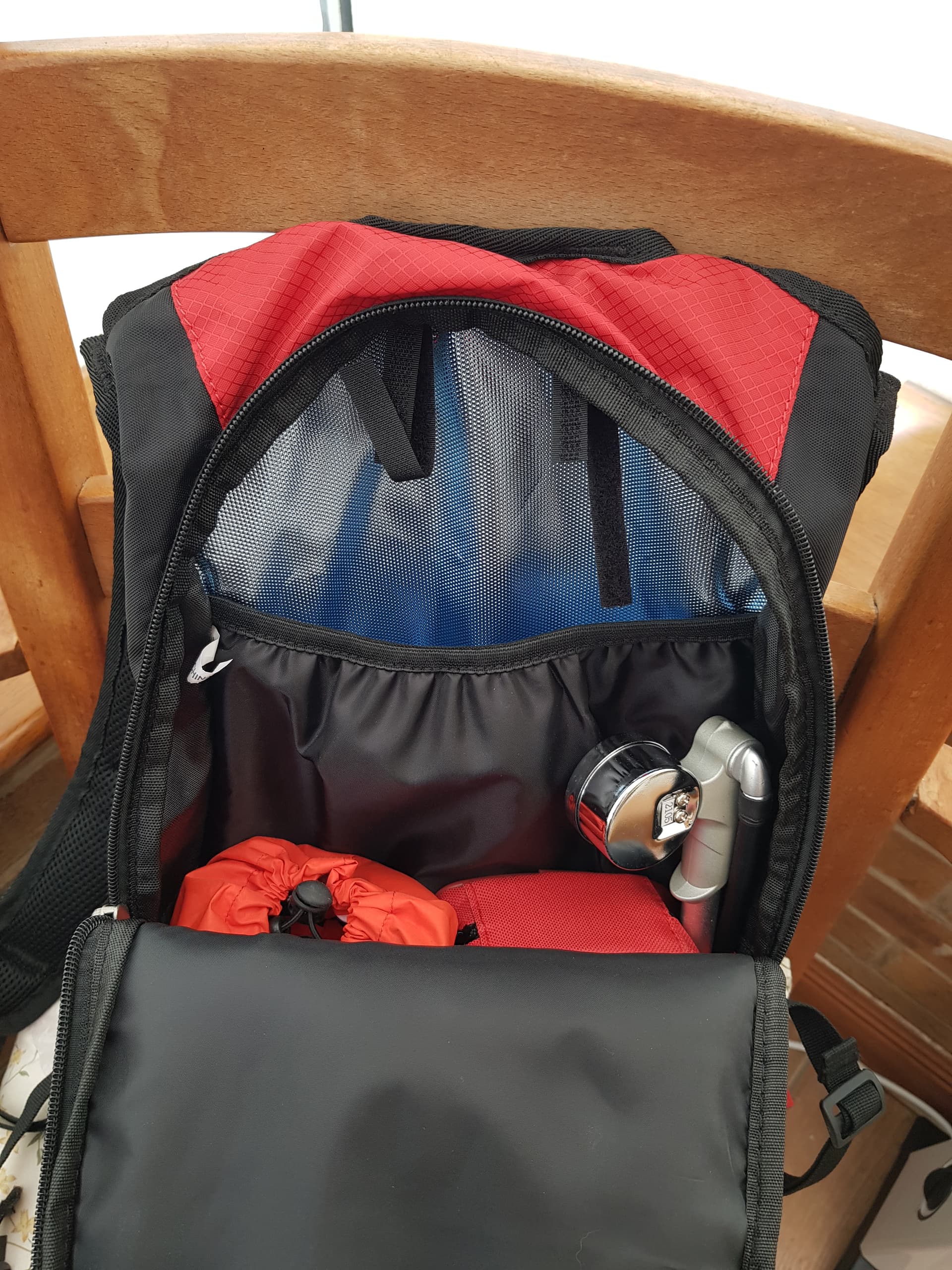

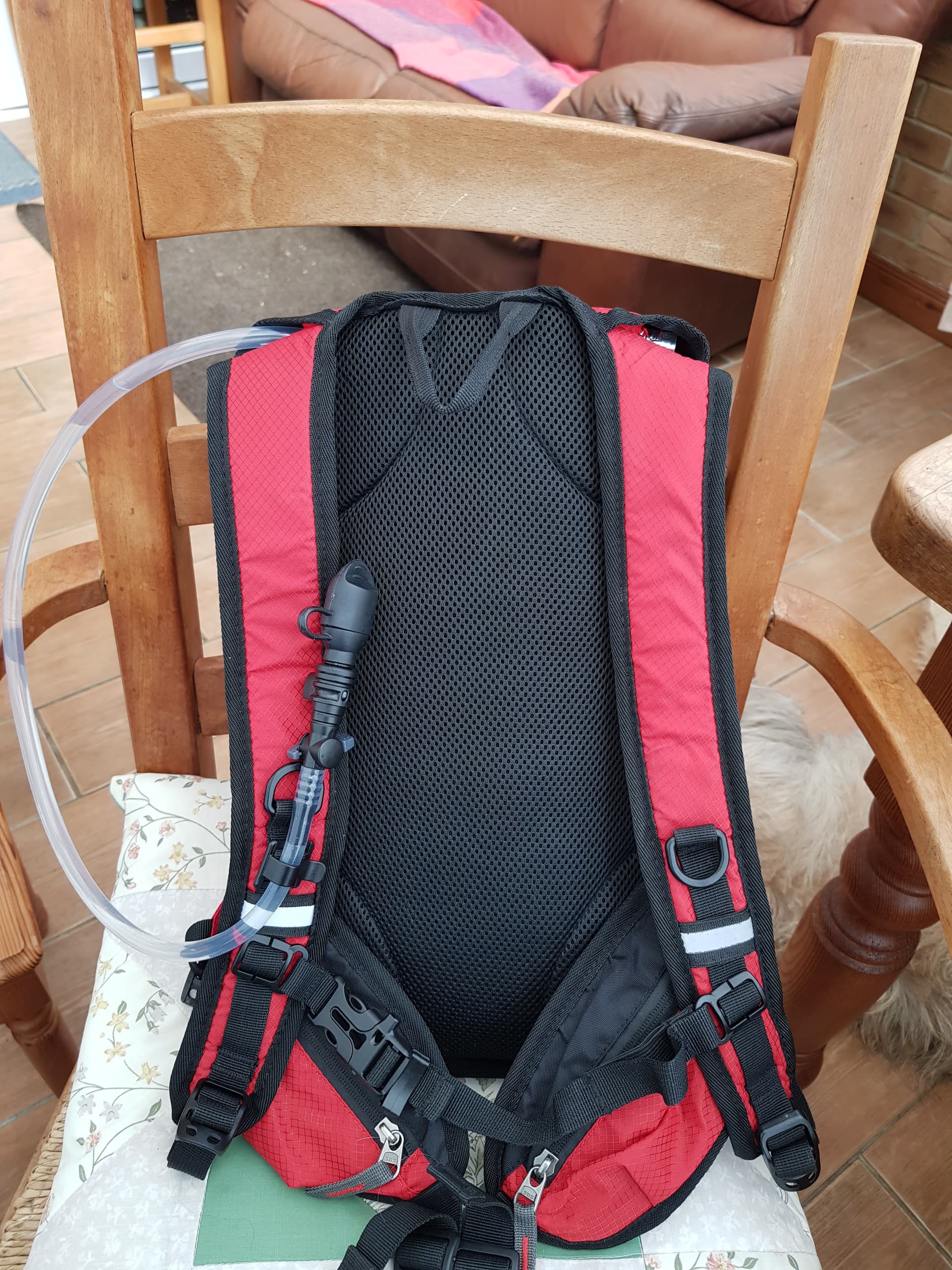

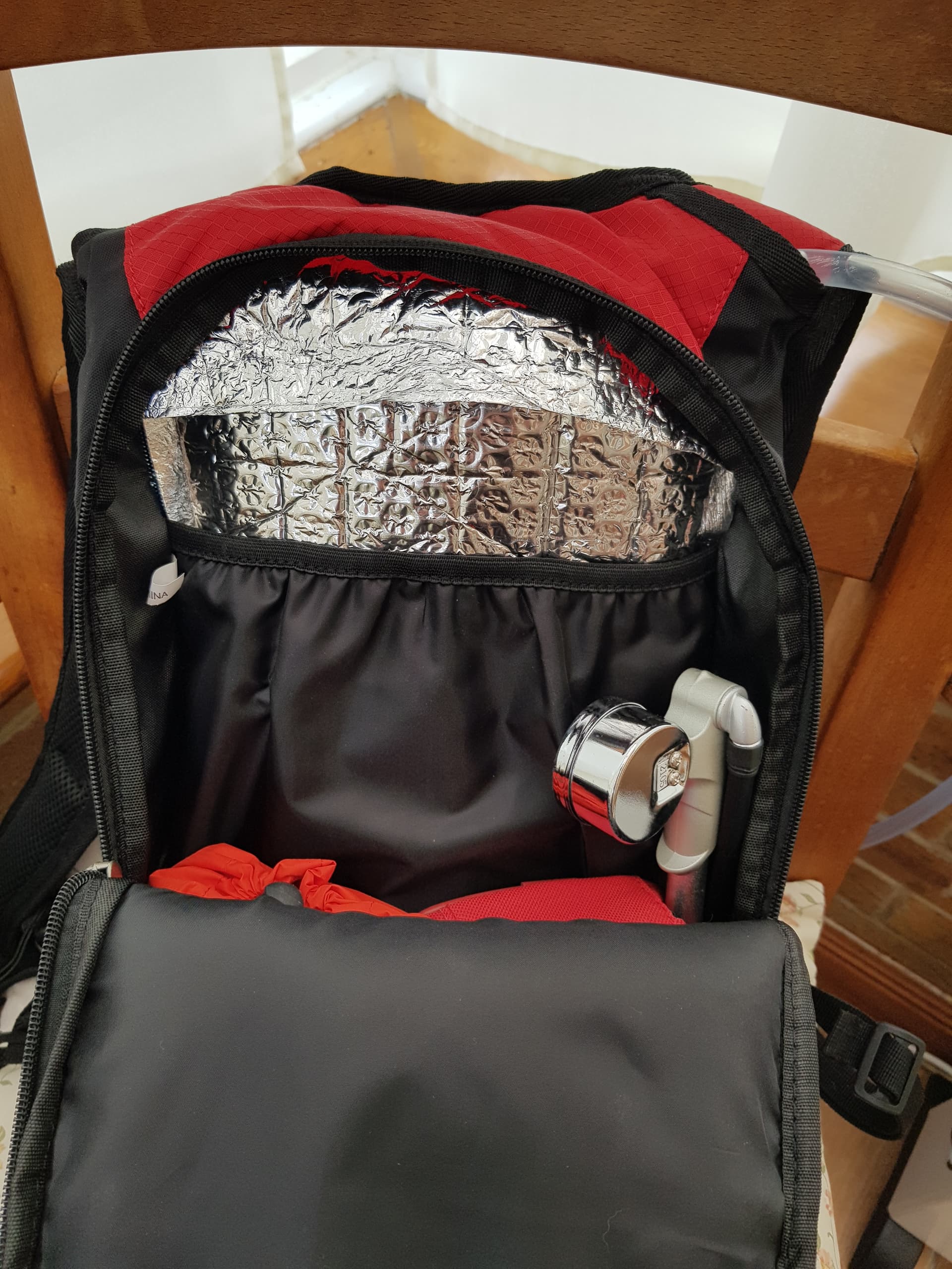

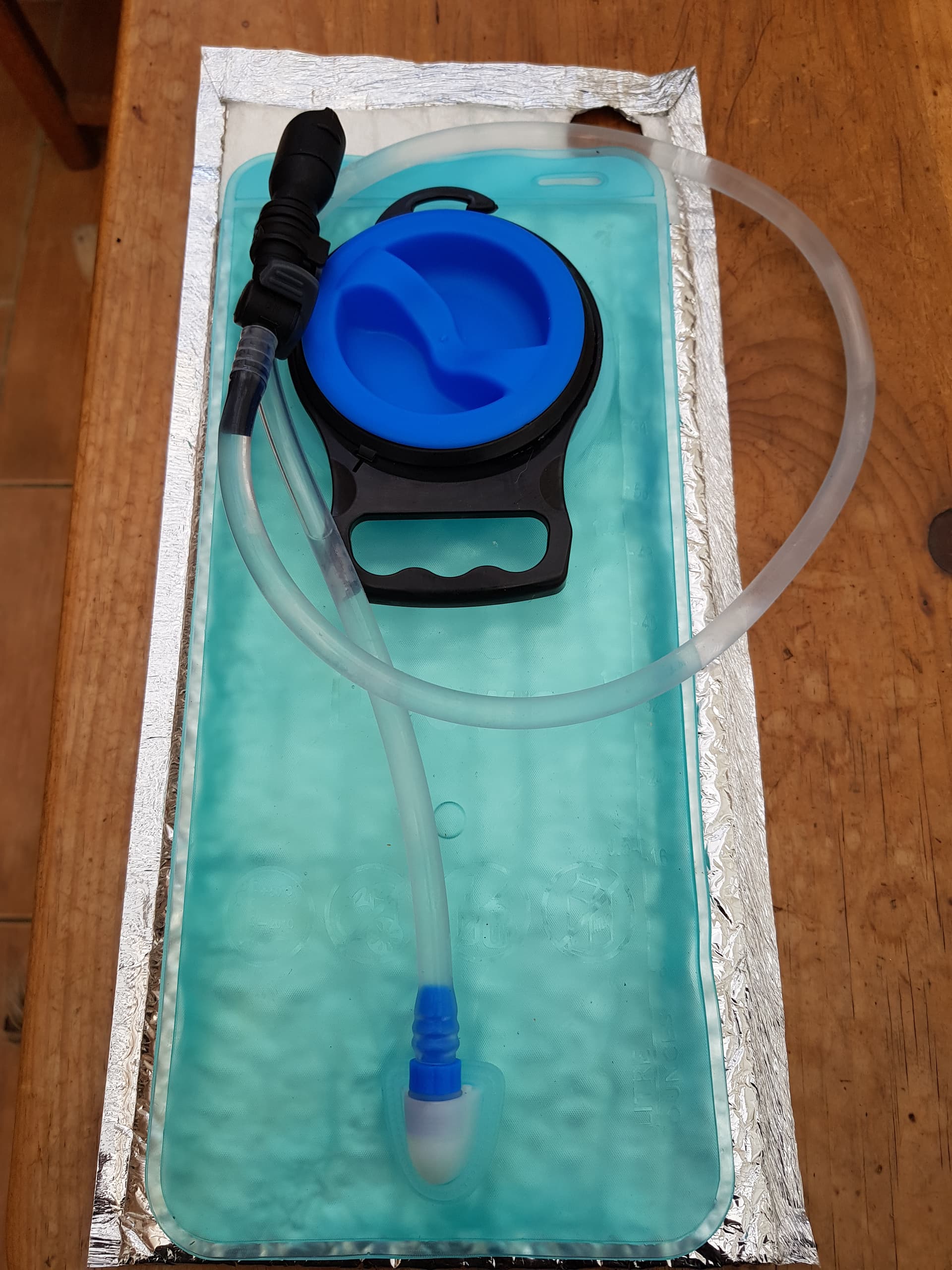

For on the move drinking I would recommend something like this, it was quite cheap, not much more than a drinks holder. I can fill and keep it chilled in the fridge ready. The back pack has an insulated pocket, and the bladder hangs upside down, feed the tube through, clip it to my chest and its ready, no hands needed, on the move drinking. It stays cold for about 4 hours. I made the exra indulation pouch out of foil bubble wrap and a hot iron to seal it to size. It will take a thin ice pack and keep snacks cool at the same time.
Takes about 2ltr of liquid. Added bonus if you fall off you have a nice cushion. No spilling, no water bottle to shoot off if you have a UPD. In summer, keeps your back cool, even with the back pack on. :grinning_face:

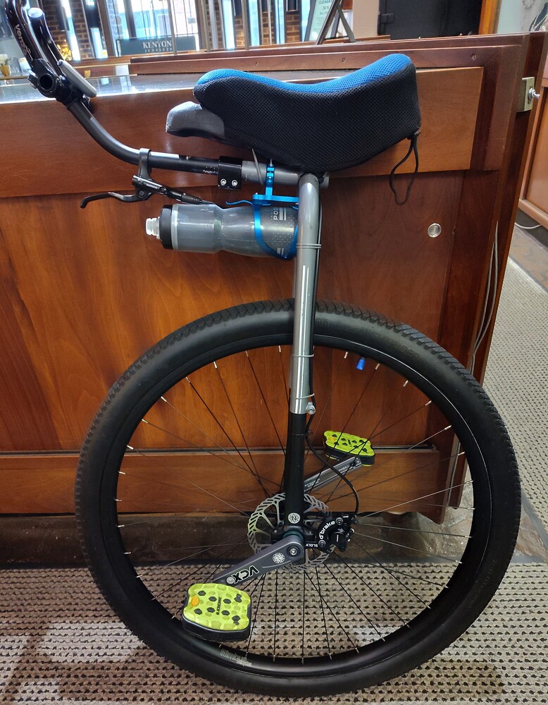

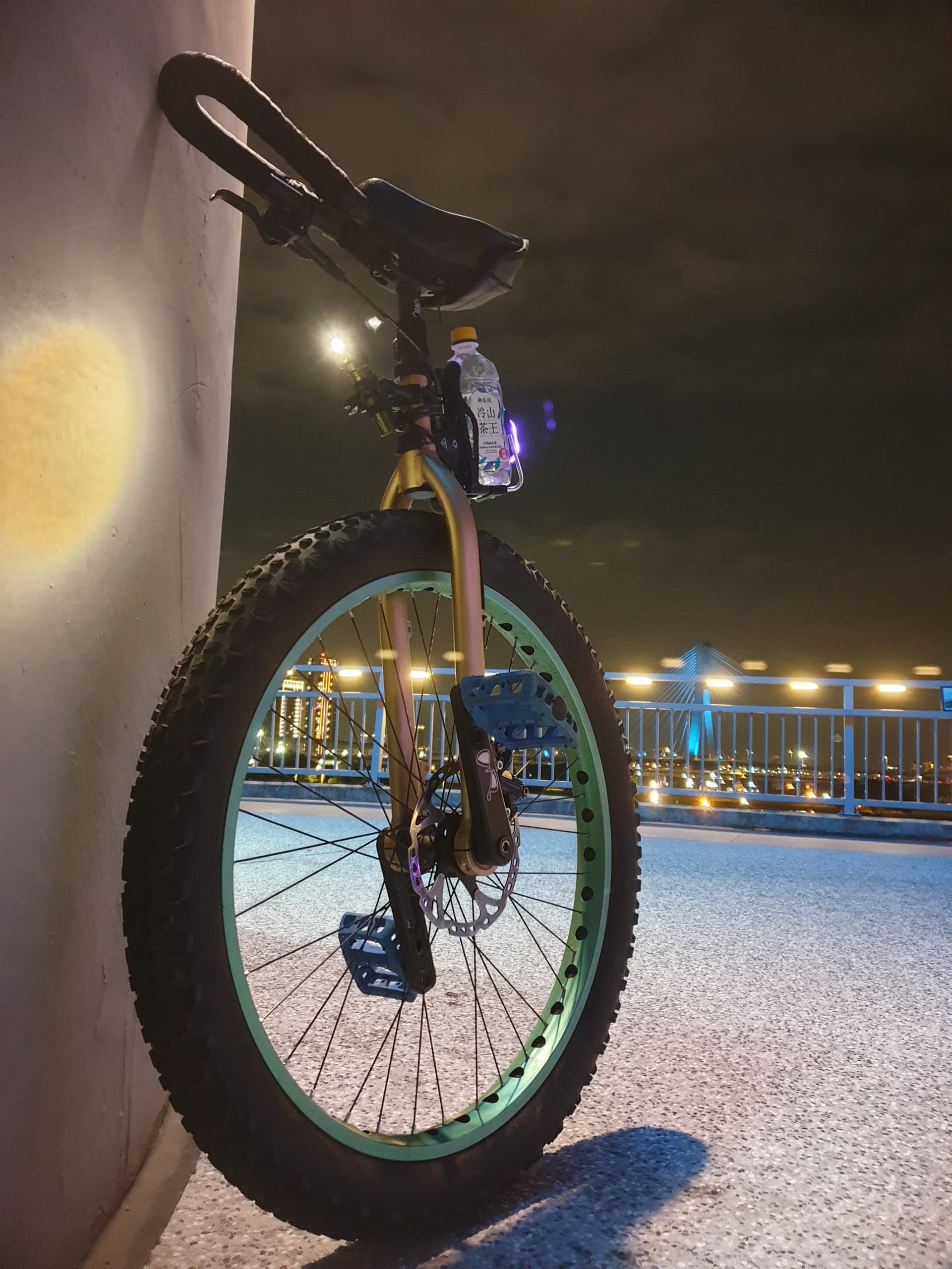

I’m using a similar setup on my nightfox.
Just as a note – I think your brake disc is mounted the wrong way round – the spokes on the disc should look like they are ‘hooking’ up into the calliper rather than flowing into it. The way it is can lead to failure of the disc under heavy braking I believe.
This one would just clamp straigh on to the bars, quick release and easy to remove. Price ok. It could go either on top or underneath.

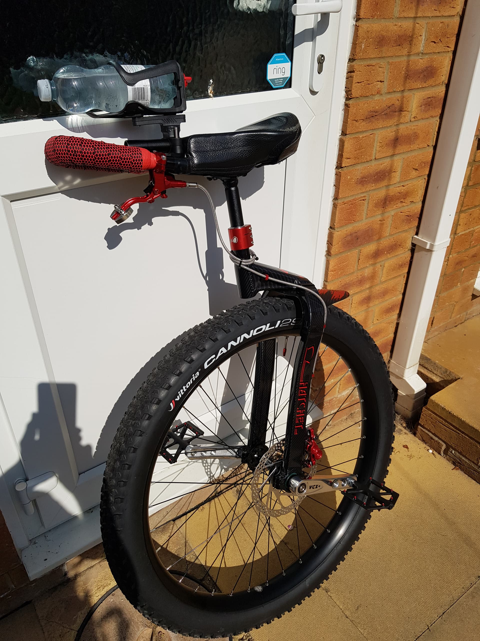

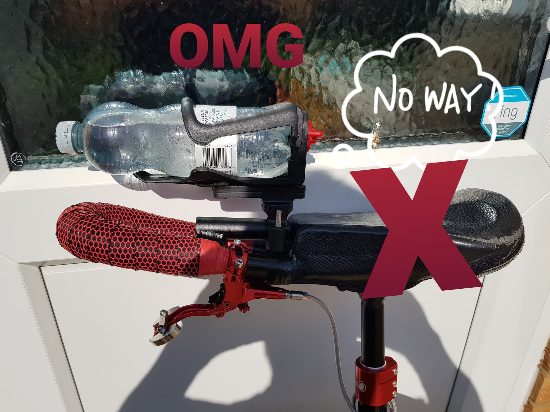

@Uni2ONE2 @ManiusTerentiusPullus @Syoten Can you mount a water bottle on the M40 size M handle Saddle? Eeerm yes you can, bars, brake and water bottle are all accessable, but its not rideable, I am afraid. So a big no no. Plus prototype 1 looks like a water bottle c–k rocket, when your sitting on the saddle, gonna get plenty of looks thats for sure :rofl::rofl::rofl::rofl:.
Prototype 1 Top Bar Mt

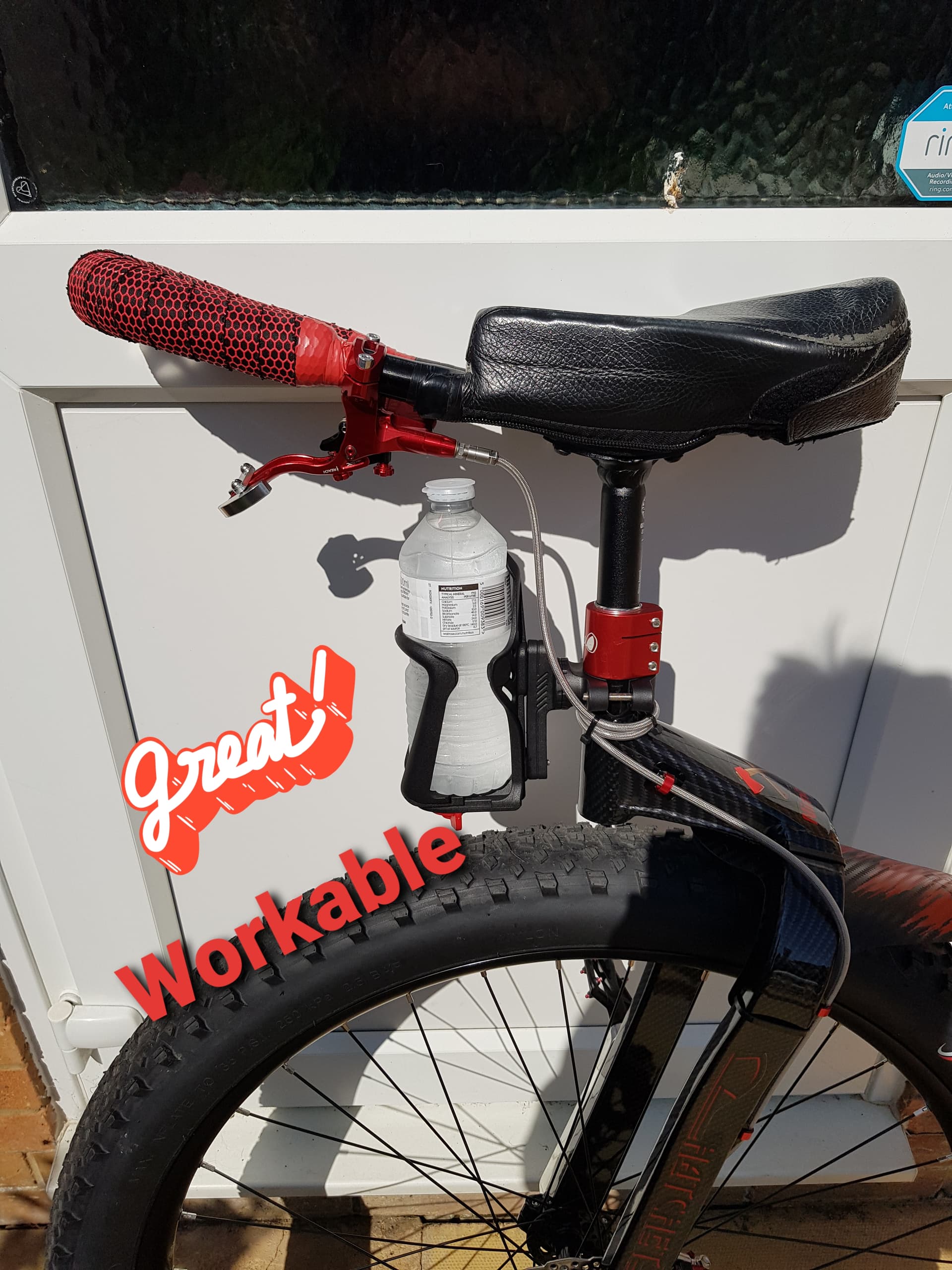

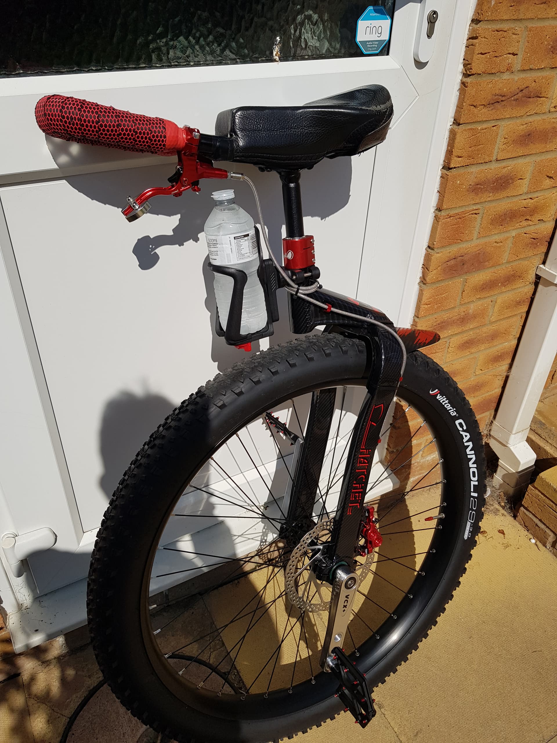

Prototype 2, works and evetything fits ok, nice and secure, for upd’s. Downside, thats the smallest size bottle @ 500ml and you have to stop for a sip.
Prototype 2 Front headstock Mt
No 2s a winner for carrying a small amount of water, but not for drinking on the move. For me thats ok, I stop for a drink anyway :+1::grinning_face:, plus my mac in a pack fits in it for wet winter riding. Everthing nicley out of the way for damage and securest bottle position for upd’s.
Prototype 1 would probabley work ok on the M40 handle saddle size L “road and touring”, as you would have the space, to take a bigger bottle and you could position it higher up the bars. Thats my 29er hatchet, so it should give you an idea for available space.
