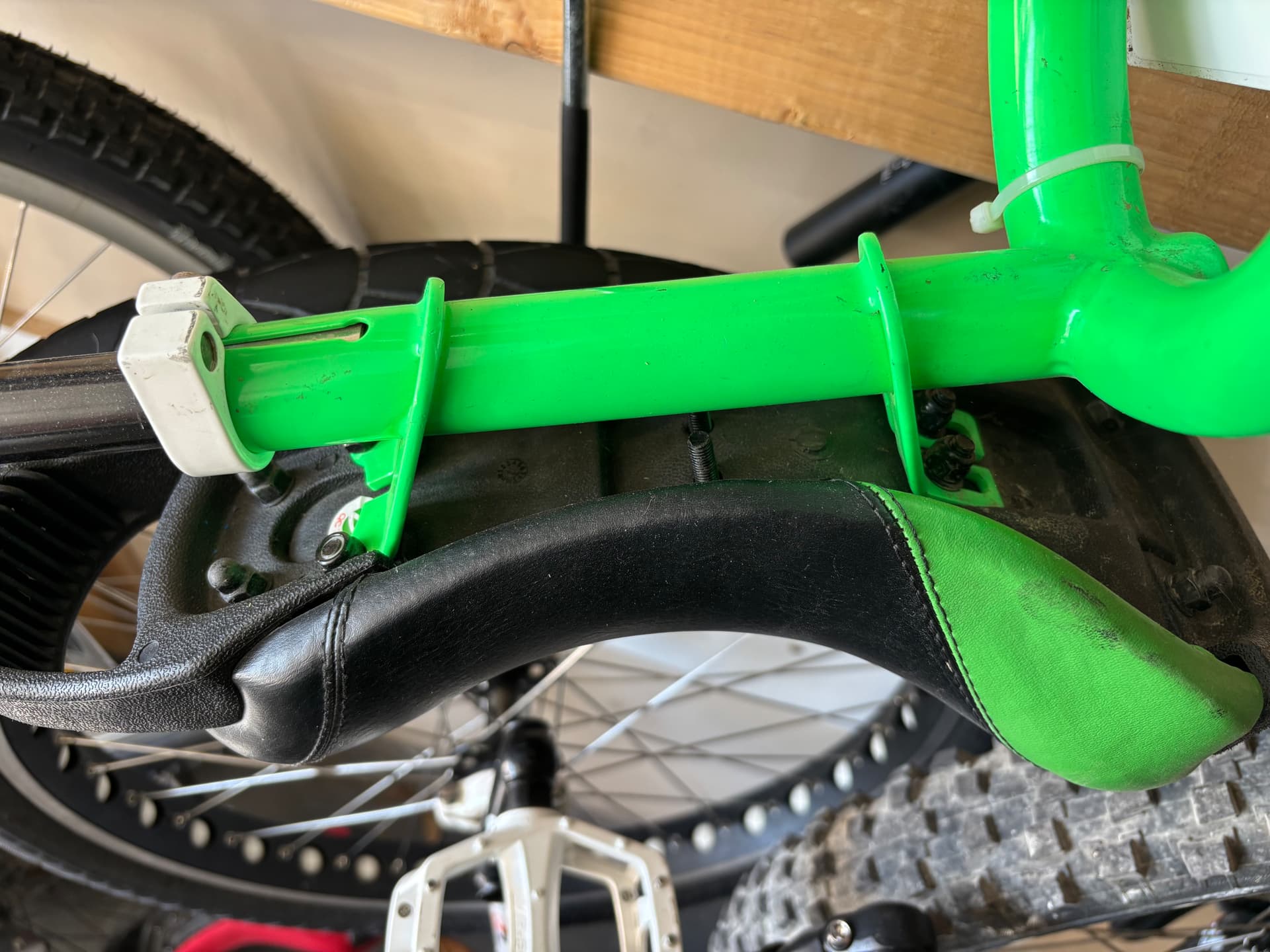

A photo of the Nightfox saddle attachment points is below:
Based on this picture, the Fusion One seems to not be compatible as it doesn’t provide the four middle holes for screws.

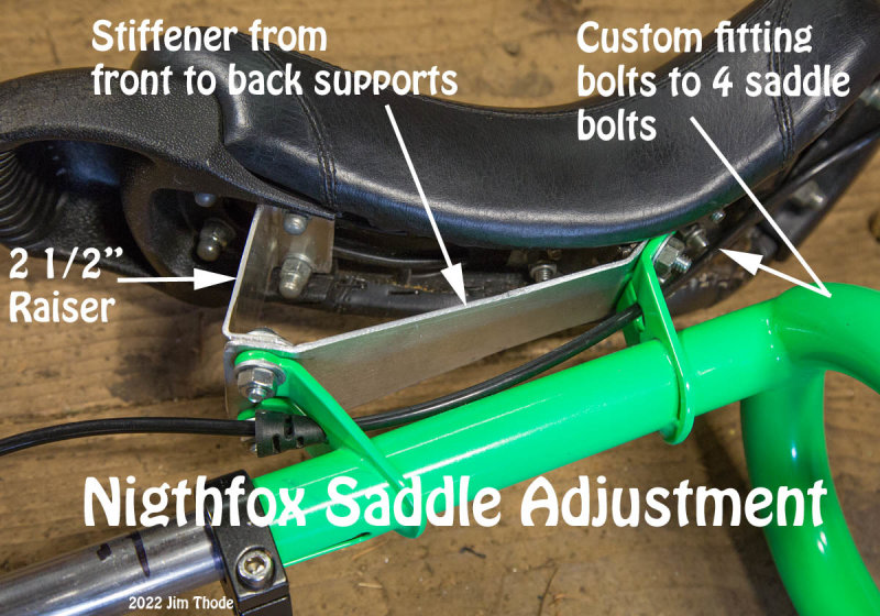

The Nightfox uses no seat post and that limits the adjustment of the angle of the saddle. With the lower nose of the saddle that puts more weight on front and less on the back/sit bones where it should be.
This is what I did to adjust the angle. More photos and details of the saddle and handlebar, here.
