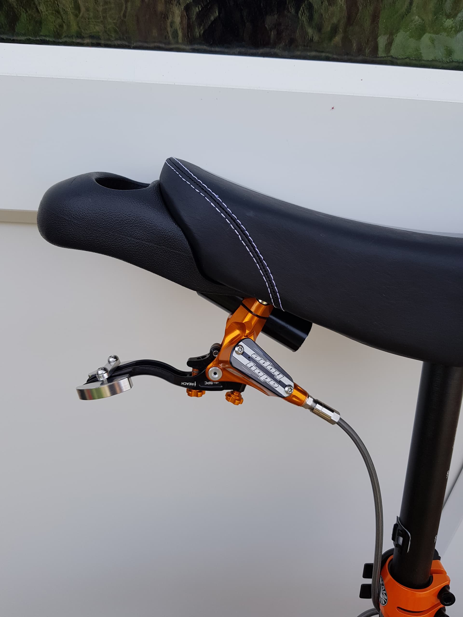

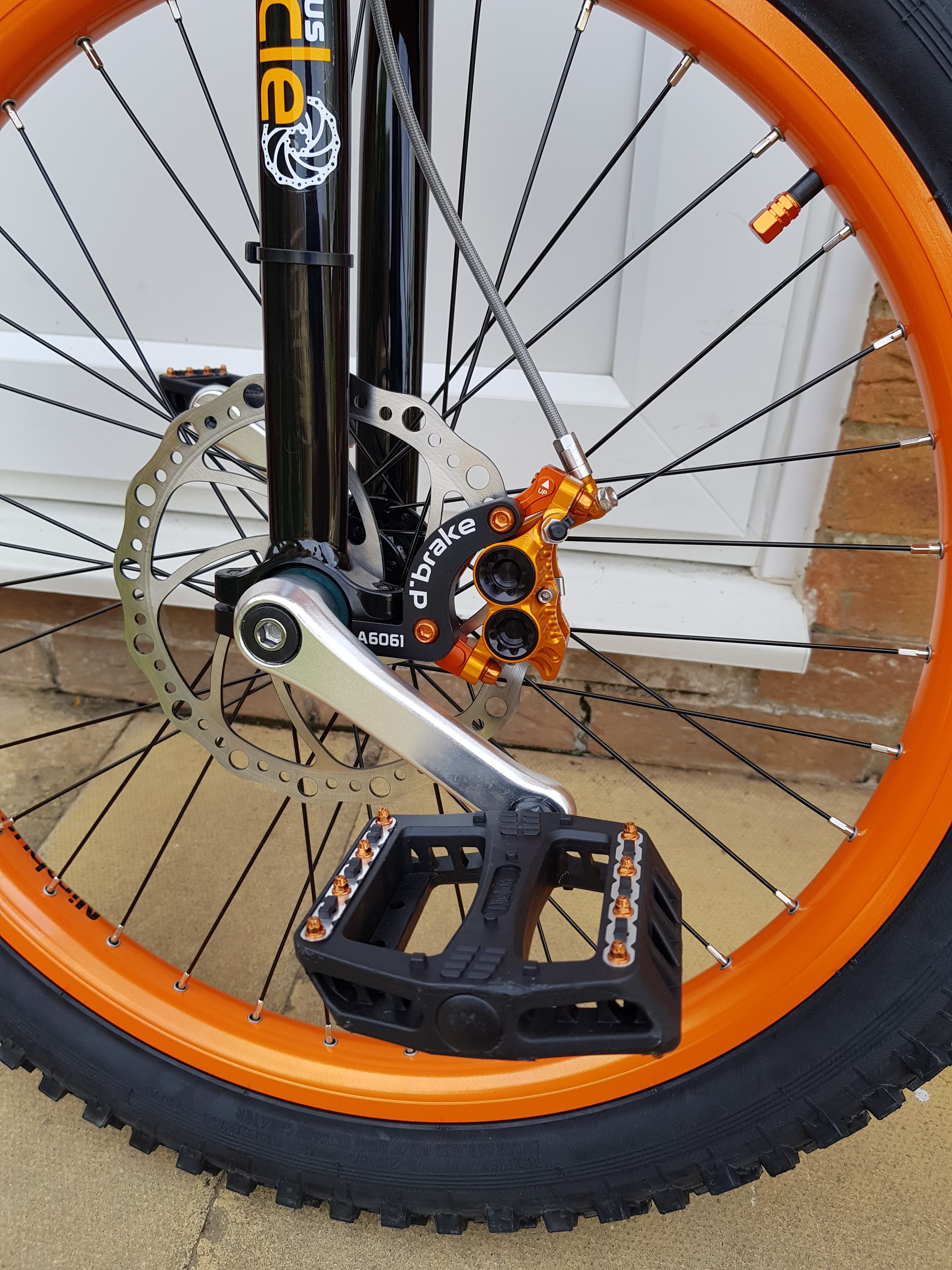

Alternative Brakes: For a little while now I have been using “Hope” brand MTB Tech 3 e4 brakes on my custom unicycle builds. Most MTB brakes seem to be compatable and generally better spec and cheaper. All were bought 2nd hand off ebay for a fraction of the cost of new. They are expensive new, but the front sets frequently come up on ebay.
The Hope Tech 3 e4 is IS Mount, has a very user friendly lever, with reach and biting point adjustment. It comes with black hose as std or braided SS. 4 pistons
The lever and caliper are fully servicable and easy to do with a few tools, so swapping hose, replacing seals and pistons is straight forward.
The easy bleed kit, makes bleeding the brakes simple.
Its an excellent set up, probabley over speced for a uni unless you are doing lots of downhill. Lever feel, response, lever travel are all significantly better than the 2 4pot shimano units I have.
Its a UK based company and spares are easy to get.
An added bonus is the look pretty smart and come in a range of funky anodised colours.

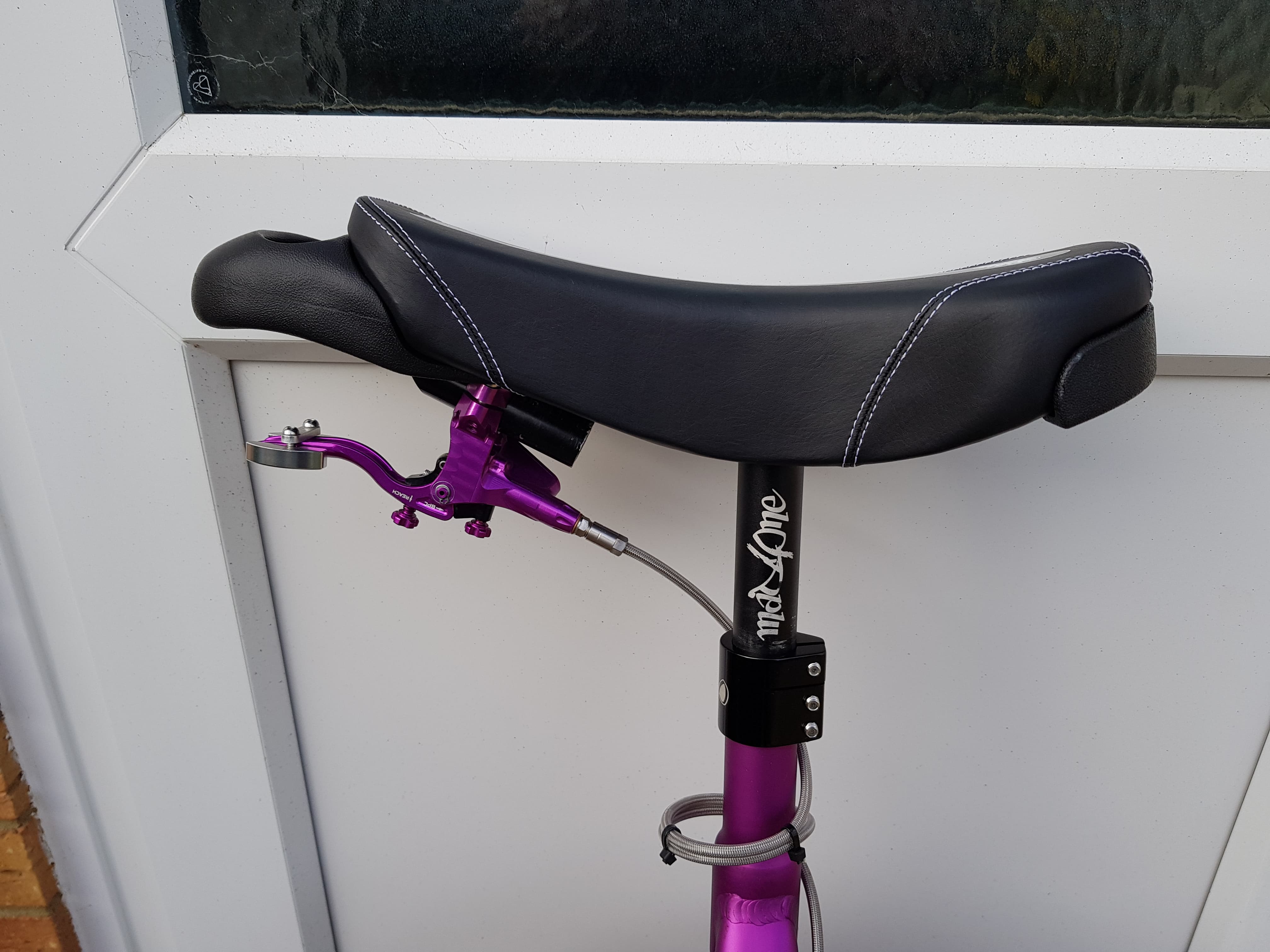

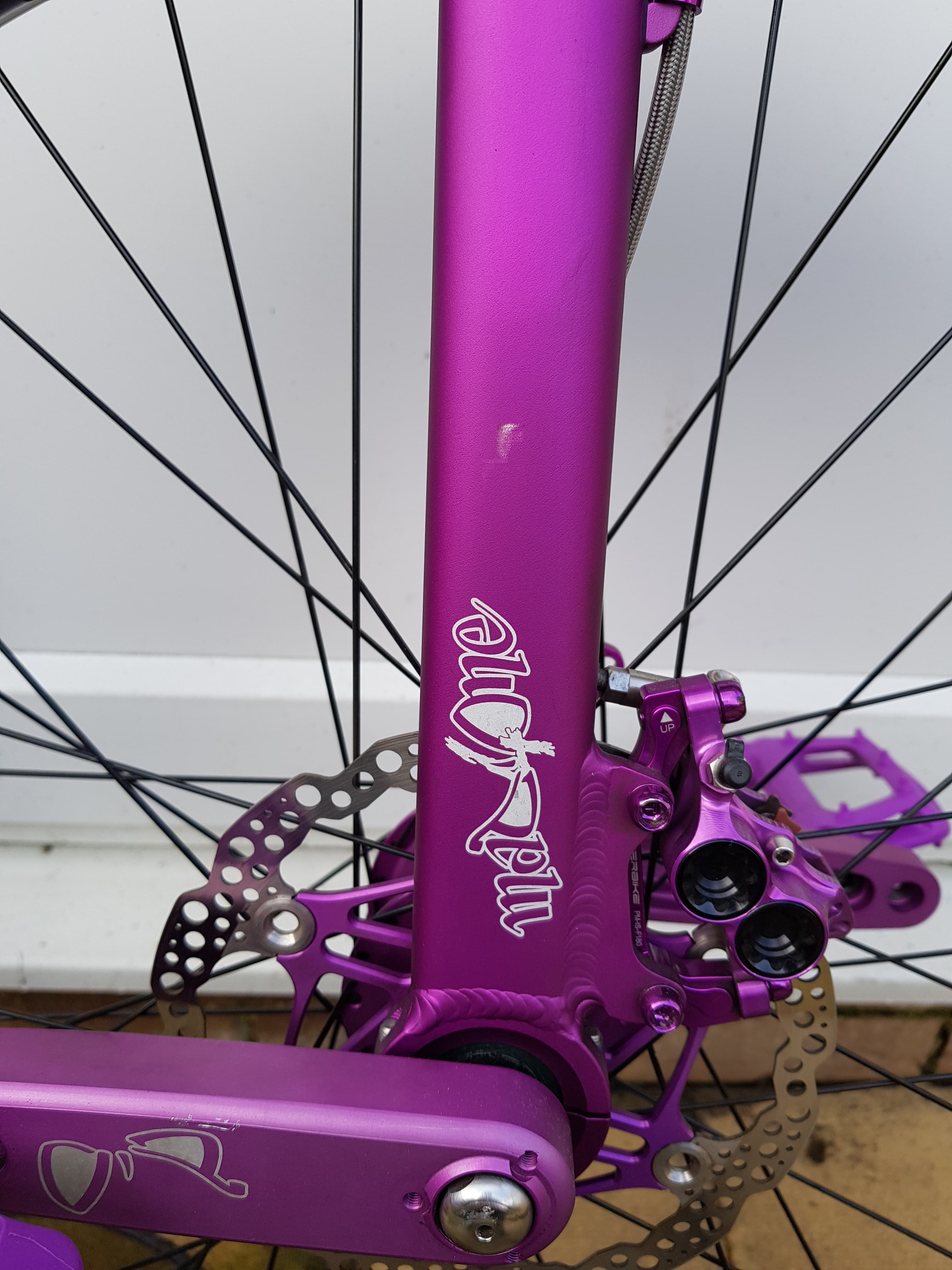

Hope Tech 3e4 and Hope Tech 4v4 are both IS mount. Just be sure to buy a front lever, it does not matter if is right or left lever as it does not matter on a uni.
Some pictures for you :grinning_face:

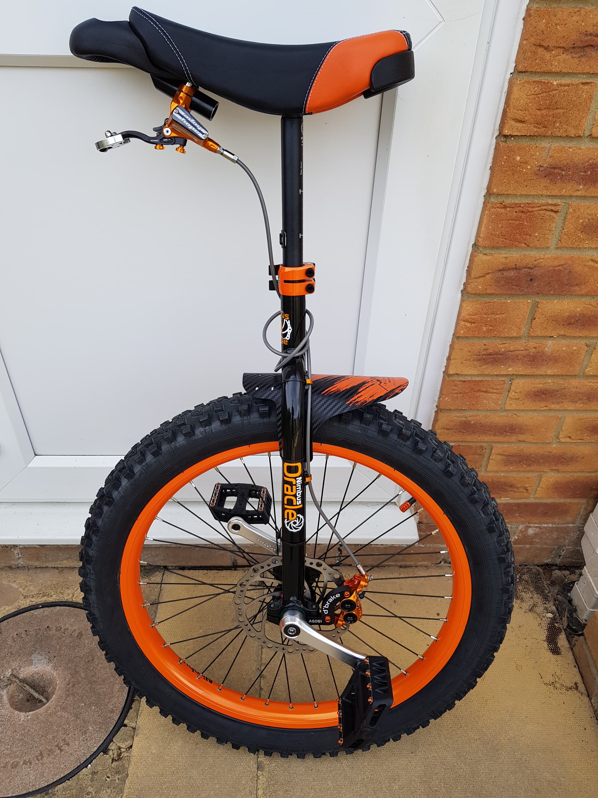

I like your orange muni. A 24" right. Can I have it? :smiley:
@Setonix yep its a 24" Oracle built on the cheap, I only just finished it. The frame was in the sale from UDC as they were selling off the dbrake oracle frames, so 40% off that. The orange rim was a second again from UDC so 25% off that. The rotor, seatpost,cranks and pedals I already had. I just swapped the pedal pins. The orange brake and lever, off ebay 2nd hand, I just serviced that and put a new hose on it. The tire and tube off a guy that sells bankrupt mtb stock. The seat, hub and spokes were new.
Nice tidy une, personally I dont like the orange, but the bits were cheaper and discounted.
Much cheaper than buying the same uni off the shelf and it used up all my spare parts :grinning_face:
Its only been ridden once so far.
you’ve done a very good job on it.
But why did you go for a gel saddle? Don’t you think the KH Freerides are more comfy?
Also why did you have to swap the pedal pins? I’ve never had any problems with my pedal pins in the past 10 years. It is just now that the pedal itself needs replacing on the 29er. I always ride with shoes with flat soles and then the metal pins keep my feet from sliding off the pedals.
Im not so handy to fix up a uni myself, or maybe I’m just a mollusque :wink:
Hack or adjustment call it what you like , you can just ride it while waiting for pads to wear in while having excessive lever travel or set it so there’s less travel straight away.
As long as your disc and pads are in good condition you will not be over extending the pistons.
@Setonix its just a std Nimbus Stadium Saddle on the Oracle. The Nimbus Air Cover on the mini hatchet I have just makes the Nimbus Stadium Saddle more man friendly. Usually I wear padded shorts for comfort. On the mini hatchet I dont need to bother as the saddle is well comfy.
Haha, the pedal pins in the std Nimbus pedal are fairly brutal on the shins and the back of your legs, I have had a few nasty scrapes down the back of my ankles. Big chunky pins and a bit too grippy for me. So I swapped for a slighly smaller headed pin with a rounded profile, still very grippy but I can adjust my feet easier.
