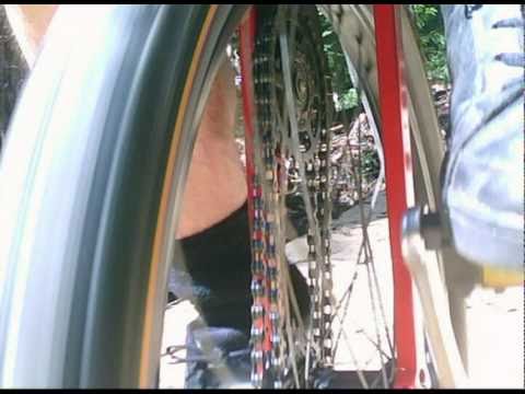

Still, it is a crap design, the jackshaft arrangement. It works, but no matter how well you align it, even with perfect fabrication, two chains in series has double the mechanical friction of a single set of chain and sprocket.
My idea for a better design, (shared by many, not really mine) would be to have a chain and sprocket set for each side of the wheel. I think that would be the ultimate design, because of lower drive train friction.

Why do you think two chains in parallel have less drag than two chains in series? All I can see that would be “better” about that design would be that you could have the crank “axle” at a different height from the wheel axle, possibly making mounting a big wheel easier (cranks below wheel centre, as long as you have long enough legs) or perhaps reducing pedal strikes on a muni (cranks above wheel centre). All drive systems (except fixed) on a unicycle are going to introduce more drag than on a bike because of the wish to get rid of all backlash, necessitating running the gearing or chain tighter than on a bike.

But you have to put the pedal axles out of line with the centre of the wheel then. You can put the pedal axle above the wheel, and have either a very small wheel (yuck) or a giraffe (yuck), neither good for distance. Or else you have to work out some way to mount the pedals on separate axles one on either side of the wheel, which typically causes an awful lot of stress on the frame, and the way the pedalling twists the frame and hence the top sprocket means that the chain drive is less efficient or doesn’t work.

Because the driven side alternates with each pedal stroke, the two sprocket sets aren’t in parallel. Only one set of sprockets is transmitting power at a time. With a jackshaft design, frictional loss is double that of a single set of chain and sprockets.
I know it seems a little counter intuitive, but friction power loss is worse with a loose chain then a tight one. Here is a link to a study that shows this odd fact.
http://www.jhu.edu/news_info/news/home99/aug99/bike.html
So a chain set on each side of the wheel should improve handling, by minimizing drive line lash, which should be doubled in a series pair of chains (jackshaft ) system.
As far as making it rigid enough to eliminate twist, I don’t know, having never tried. I assume it could be done. For that matter, on the jackshaft designs, all the driving torque is also going through the one fork leg that the jackshaft is mounted on.
My compliments to the several inventive craftsman that have shared their pic’s and stuff on the forum. I just wanted to make the point that there is likely a way to set it up that would waste less power.
I tried to find power loss figures for planetary gear systems, but no luck so far. I suspect that for an all out racing uni, the design with the lowest power train loss would be fastest. Perhaps the lower pedal position needed to afix the primary sprocket below the driven axle might improve handling as well. Or maybe not.

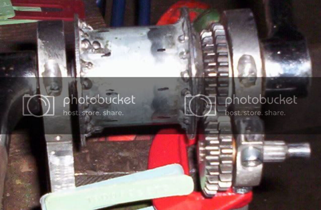

Just an update on my guni.My original design brief was to make a uni that could do the Sydney Olympic Park /Parramatta River loop ride which is around 16km(10 miles) and I had to be able to keep up with my friend on his bike.The first time I tried I had a minor mechanical failure with a cracked weld,I made good the repairs and was ready for another attempt when I injured myself while skateboarding and I was out of action for six weeks.Well on saturday I finally did it ,mission accomplished.Some may say why didn’t I just buy a coker or a 29er, well I like a challenge .16km is by far the longest uni ride that I have done and was a huge challenge for me but I realise it is like a ride around the block compared with the distances many on this forum regularly do and credit to them.

I looked at your first design with the lawnmower gears and had an idea. Hub motors require a stationary piece to work which is normally impossible to do on a unicycle. However, if we use this picture as a reference we can make more space between the input and output gear, make an adapter for the motor hub axle to be the same diameter as a bearing. Then put the cranks on external bearings on the hub axle, and do this on both sides of the hub, by doing this we have a roundabout way of connection to the hub but also a way to keep the axle still.
are there not stationary pieces on all geared hubs to take the reaction torque like the knurrled bearing on new schlumpf hubs, and the lever on older schlumpfs as well as the “blue shift”?
Yes but ebike hub motors aren’t set up well for that and pedals on the hub
Mid-drive motors (the ones just at the pedals) is the closest to what could be needed for a uni prototype as it already receives cranks and there is the ring rotating out to drive the chain.
However, as usual, there is the freewheeling “feature” that needs to be dealt with and a trick to be found to attach a rim while keeping the motor body attached to the frame for torque (no paint diagram available).
I’ve thought about mid drive motors, adapting the chainring to a hub shell is the best option but keeping it from warping under stress (due to the most common “oblong” shape) is hard. As for the freewheel, just open it up and weld or set screw. A machined frame adapter could adapt the left side of the frame to the motor’s mounting point
Mid drive motors are a nice idea and as @Nathan_Moore said, I add that I would try to weld a freewheel to become fixed, because unicyclists generate a lot of backwards torque and it should be reliable. Depending on the seals/bearings around maybe cold-welding carbonized steel will become tricky. When we already started welding, the frame is a no-brainer. The easiest build would be a mid drive motor giraffe with a chain drive. Sounds feasible, but also scary.
