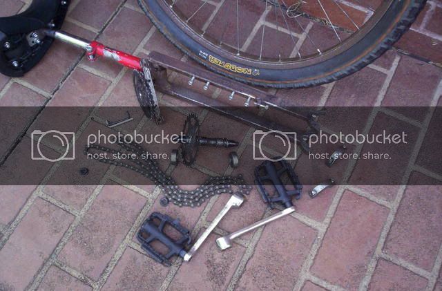

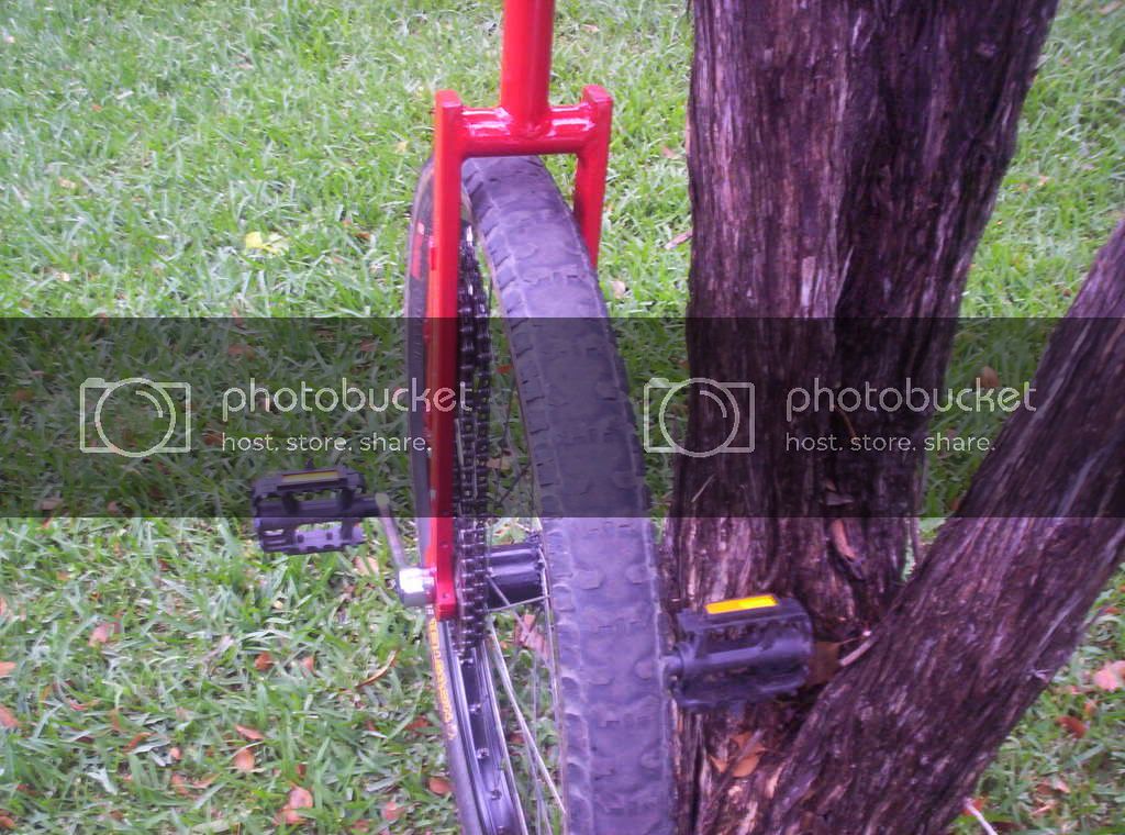

Update for my Guni.I have put a few more miles/kms on my guni and developed a bit of transmission play a quick dismantle to check things found that I am not a very good welder ,the input sprocket weld to the bb shaft had almost let go. Anyway it was easily fixed and all is well again. Monitoring, adjusting and modifying when required is part and parcel of building a one off unicycle.While I have spent a lot of hours on my guni I have also found great satisfaction in seeing its completion.

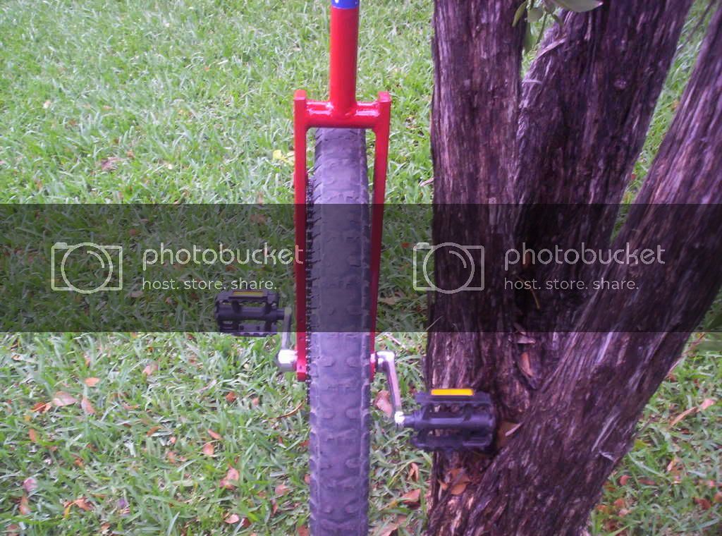

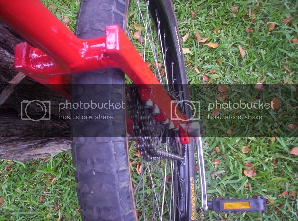

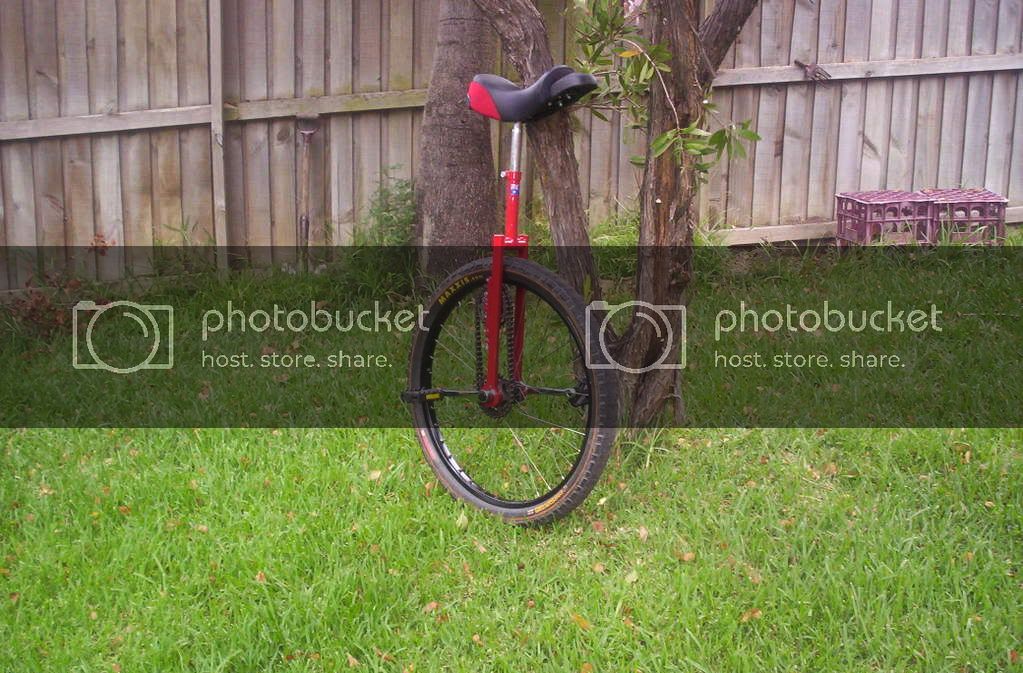

My completed guni came up alright with a coat of paint,job done.
:astonished: respect

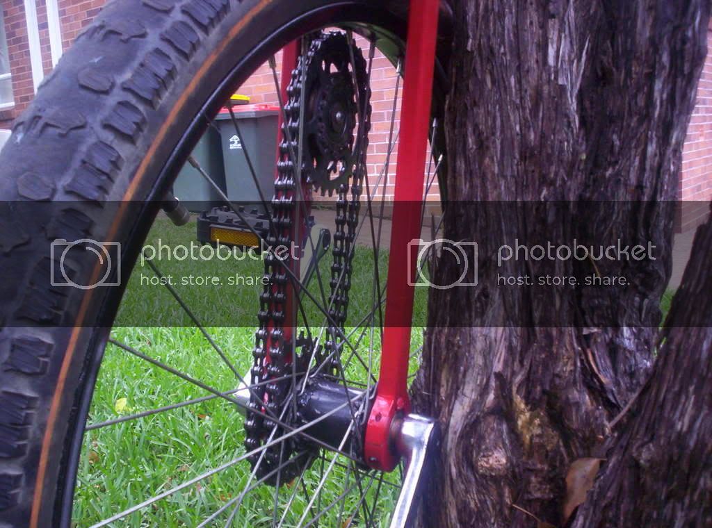

It looks really nice, did you weld a sprocket to your axle? also, could you get a picture from the front? I’d like to see how you managed to get 2 chains on 1 side of the frame

I would have used a 20mm Thru axel hub with 6 bolt rotor mount to fix the cog to. Then figure out something to fix a cog to the spindle. While using the same overhead transmission kind of assembly you have there.

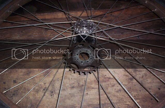

Here a few new shots.Also there are photos of guni dismantled in earlier posts in this thread.
