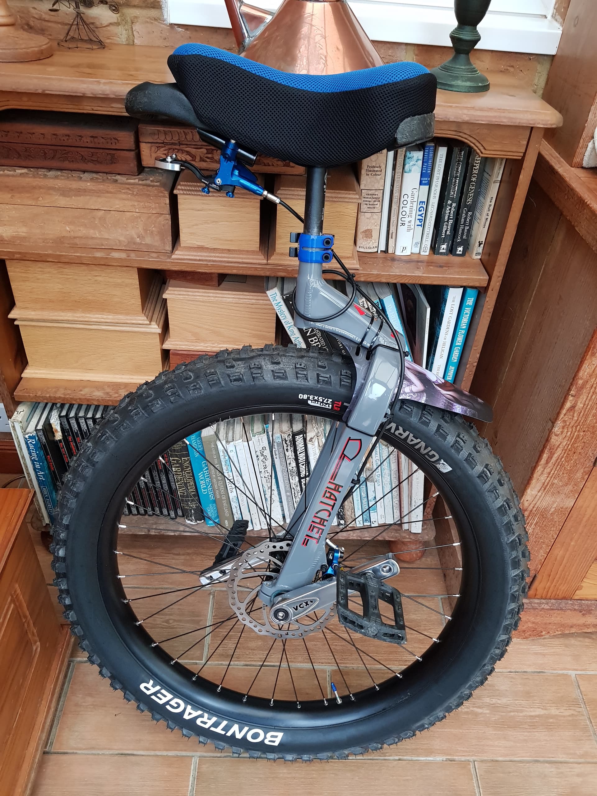

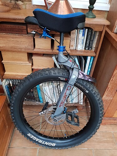

Welcome. Your profile picture shows no handlebar on your 36”. I would highly recommend a handlebar for increased comfort as you will put some of your weight on your hands/wrist by doing so.

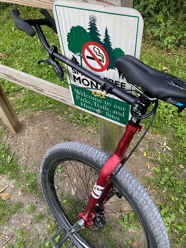

Another option (that has worked great for myself) is to use an ISM (split nose) bike saddle and a custom handlebar setup. It provides good weight distribution and has reduced the chaffing of the saddle to a minimum. Lots of great ideas in this post your homemade handlebars here!
I see you have a stadium saddle. I own one and don’t feel they are very comfortable at all in fact it is sitting in my parts bin not being used. Seeing that you have ridden much farther than I ever have you can take my advise with a grain of salt. I advocate on this forum for the nimbus air cover, I have one on each of my unicycle that I ride longer distances on.
I love them and for $50 each find them a great solution. As I always say, it will make any saddle more comfortable. Other than that I like Kris Holme saddles I have the street and free ride saddles on my unis.

And you even have a handlebar setup that makes it an easy conversion as it’s attached to the seat post (and not directly to the saddle).
I recommend getting a bike seat post with double bolts so you have infinite adjustability like this (compared to those single bolt that usually can only be adjusted in fixed positions). You will lose some control by using a regular bike saddle as you are not able to control the unicycle with your tights - but in my opinion that is also the biggest advantage as there are reduced chaffing of your tights. For road riding with both hand on the handle it’s not much of an issue but freemounting can be sketchy initially ![]()
…also consider wrapping that poor handlebar in some hockey tape for a bit or protection and a bit or comfort for your hands (you can of course also use bike bar tape but it is usually quite fragile/“not UPD friendly” and way more expensive)
Absolutely, that bar has taken some dings
, thanks for the advice

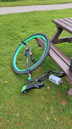

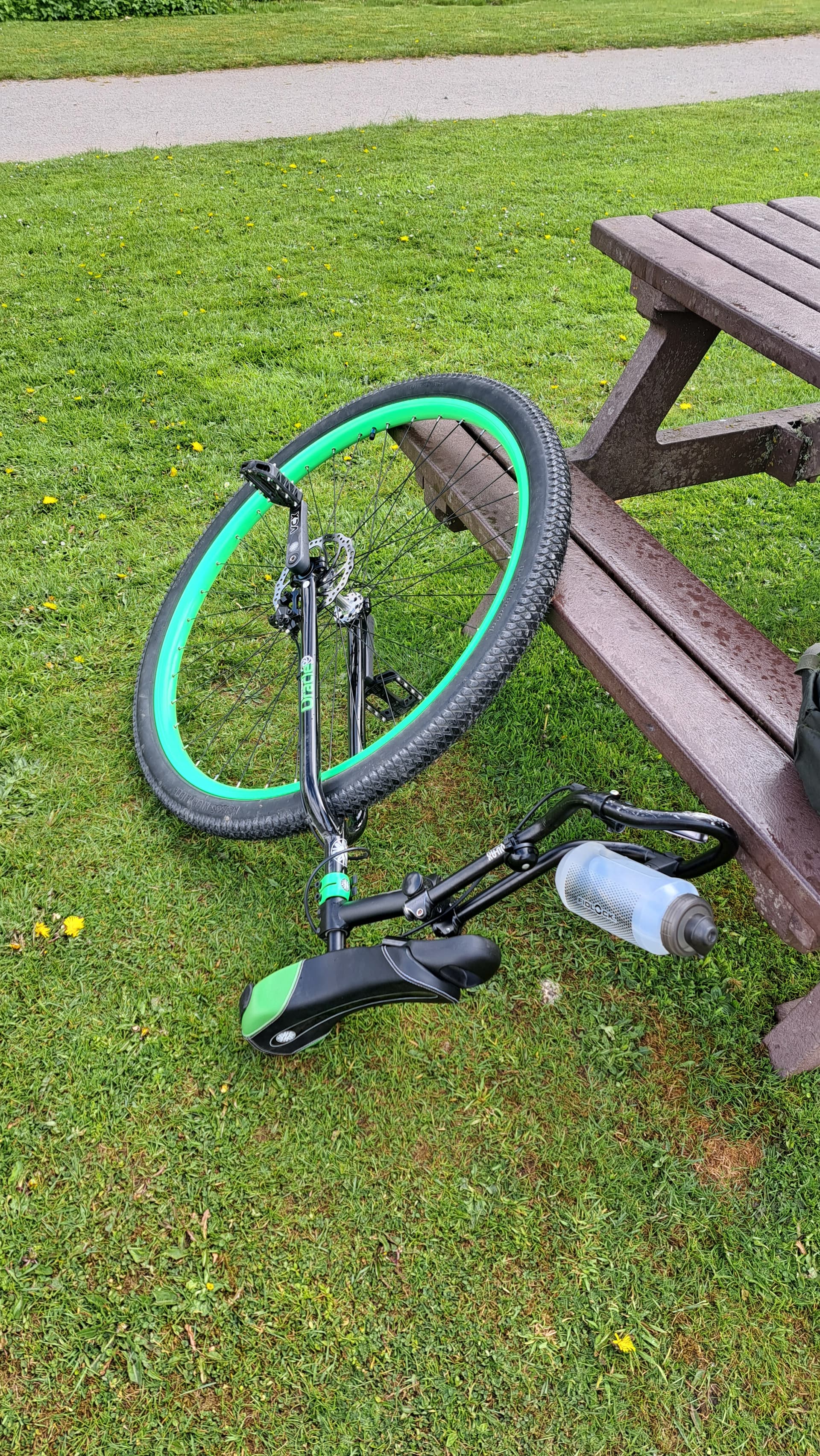

For me, I’ve mostly settled on the Mad4One handle saddles. The medium has just enough control for my thighs and less chafing; the long has less thigh control but feels pretty much the same. Neither really feels like I’m slipping off the way the bike saddles do.
