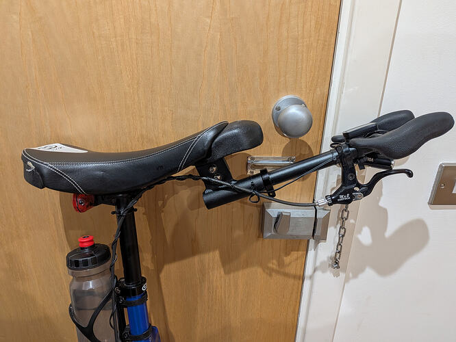

At the moment, I’m using a T bar connected to a Naomi saddle (grey base) on my 32. When riding i’m noticing a bit of creaking and maybe a tiny bit of flex despite every bolt being tight. The creaking goes away when I’m not hands down so I have to assume this is coming from the saddle base.
I ride both hands down almost all the time and am looking to extend my bars a bit so am looking to either stiffen or replace the setup outright. The way i see it there are 2 practical options:
  • Stiffener Plate for Impact Bases
  • Replacing the T Bar with a Shadow handle set
I’ve used a shadow handle before (with aerobars) so know the system but that’s a lot of cost where maybe a stiffener might do the job for the time being.
Looking for thoughts to sway me in either direction…
(edit to attach image of current setup)
I have had pretty good result with a stiffener plate, even though this adds quite a lot of weight.
There’s also the solution of adding some sort of attach onto the seat post. There’s no standard piece to do so, so you’ll have to fiddle something there.
In the past I used stiffener plates with these T-bar - kind of viewed that as essential as the plastic is just too flexy.
But the hassle of mounting the bolts into the saddle with all things lining up, as the plate is thicker is a mega frustrating experience - and I recall I cross threaded one of the insert sections which was a shame.

Yeah, my other 2 T bars are on stiffened KH Fusion and Miyata bases (this was a pain and involved boiling water). The reason I didn’t go for a stiffener with this build was that it was put together around 2017 (before there was an option) and then only lightly ridden until last summer.
I know the Naomi works for me and is readily available so don’t really want to change the saddle out as well. Thanks for flagging the Ursli and M4O options but i think both would be too narrow for me and more of an adjustment than i’d like.

There was something… I bookmarked it because I planned to do something similar (that is still the plan, months or years later). Ah, here it is:
Adjustable of sorts, and said to be very rigid.
That’s brilliant thank you.
While it’s not the post you directed me to, I saw down the thread the idea to use Bimini fittings (“marine jaws”) to anchor the back of the long bar to the seatpost. That should turn the bars into a triangle with the saddle and seatpost which will give me some more time to think, adjust and experiment…
