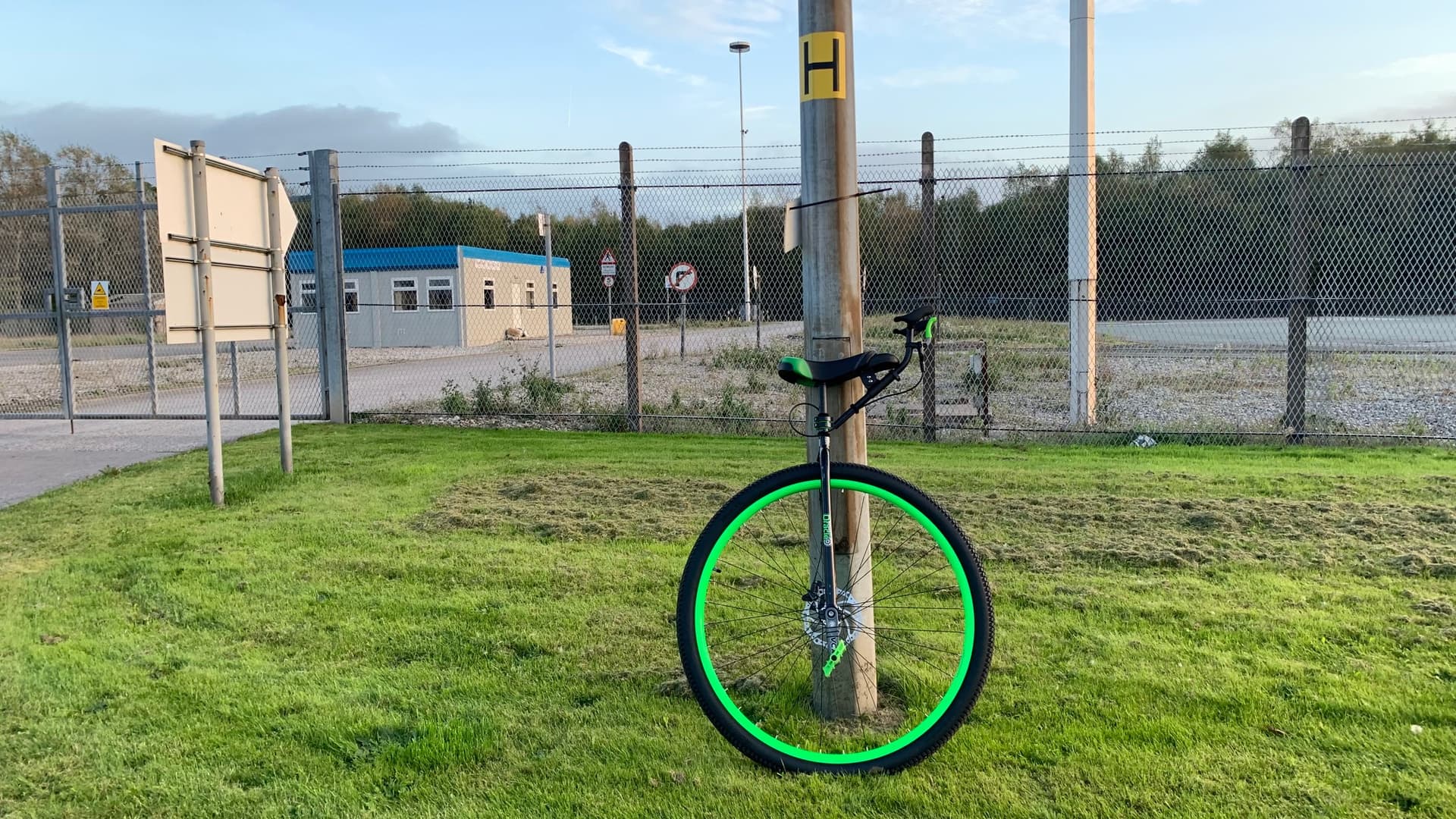

I’ve recently (maybe too soon) added some Kris Holm handlebars to my 36er as I heard they made the ride more controllable etc. After a couple of short rides getting use to the 36er I introduced the handlebar.
If anything I’m finding i’m finding they get in the way when trying to mount but once onboard they seem ok. I only say ‘seem’ because I’m not fully comfortable putting both hands on just yet. I’m using the curved Kris Holm bar but have considered switching it over to the flat bar to see if there’s any difference.
I’m sure this is a debate where its based on personal preference but is there any common position people decide to put their bars to suit road riding?
I’ve attached a picture of where I have mine presently.

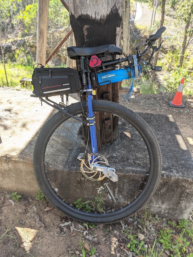

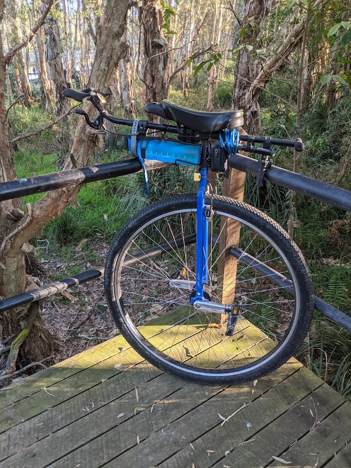

I have my curved bar positioned lower than yours so that I can still use the saddle handle for mounting, but the curved bar makes the bar ends still high enough up to be in a comfortable cruising position.
Ok thanks, I take it you have to cut the bar down then as mines way too long to do that?

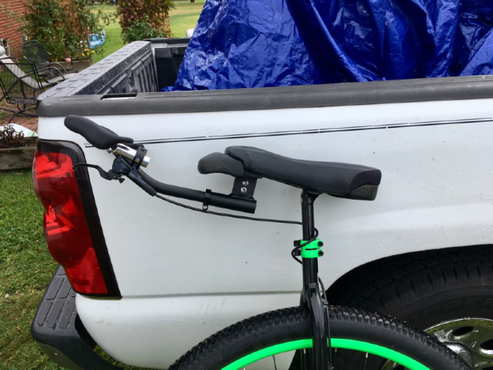

My setup is similar to what you show. My bars are about 8" above my seat and a little further forward than yours. I prefer an upright riding stance.

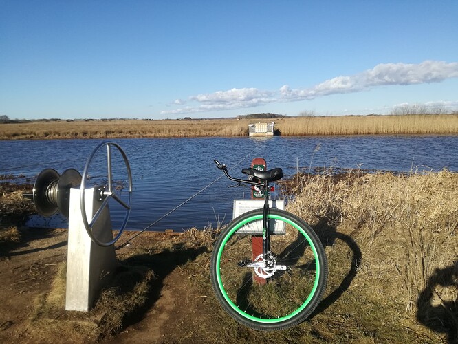

Here is mine. This is how I alway rode with a handlebar.
I dont think it’s too early. You can still ride just gripping the saddlehandle. Maybe, it’s important to remember to ignore the handle when circumnavigating difficulties. And never try to steer by pulling the handlebar.
Does the handlebar help you ride that line across the water🧐
