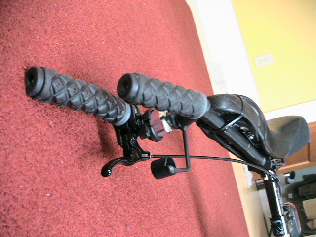

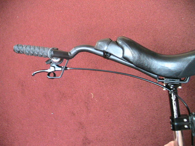

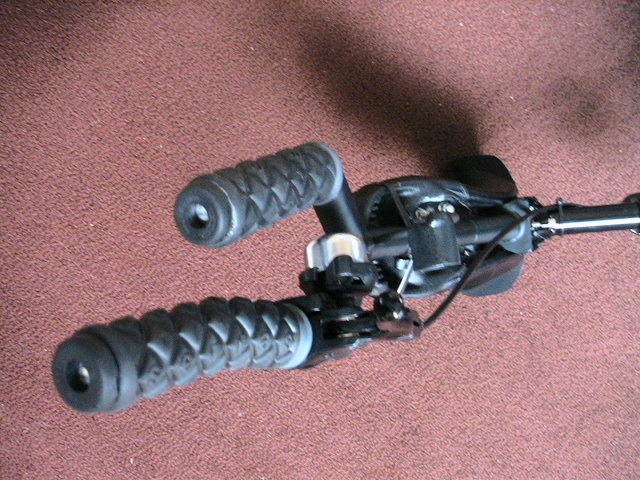

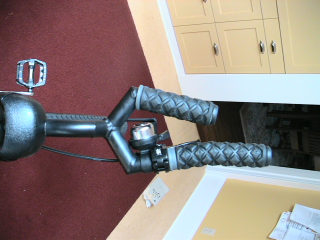

Not light, but unusual handle-bar
My latest creation. . . made of steel, yet still lighter than the t-7 bar and a little different riding position. I used: a GB4 handlebar, a KH rail adaptor, 7/8" handlebar tubing and strong cable ties. Its narrower and way stiffer than the T-7, longer and provides a great leaned forward riding position. the extended handle grip is to provide brake lever protection and an offset positon for the right hand.
See pics.
