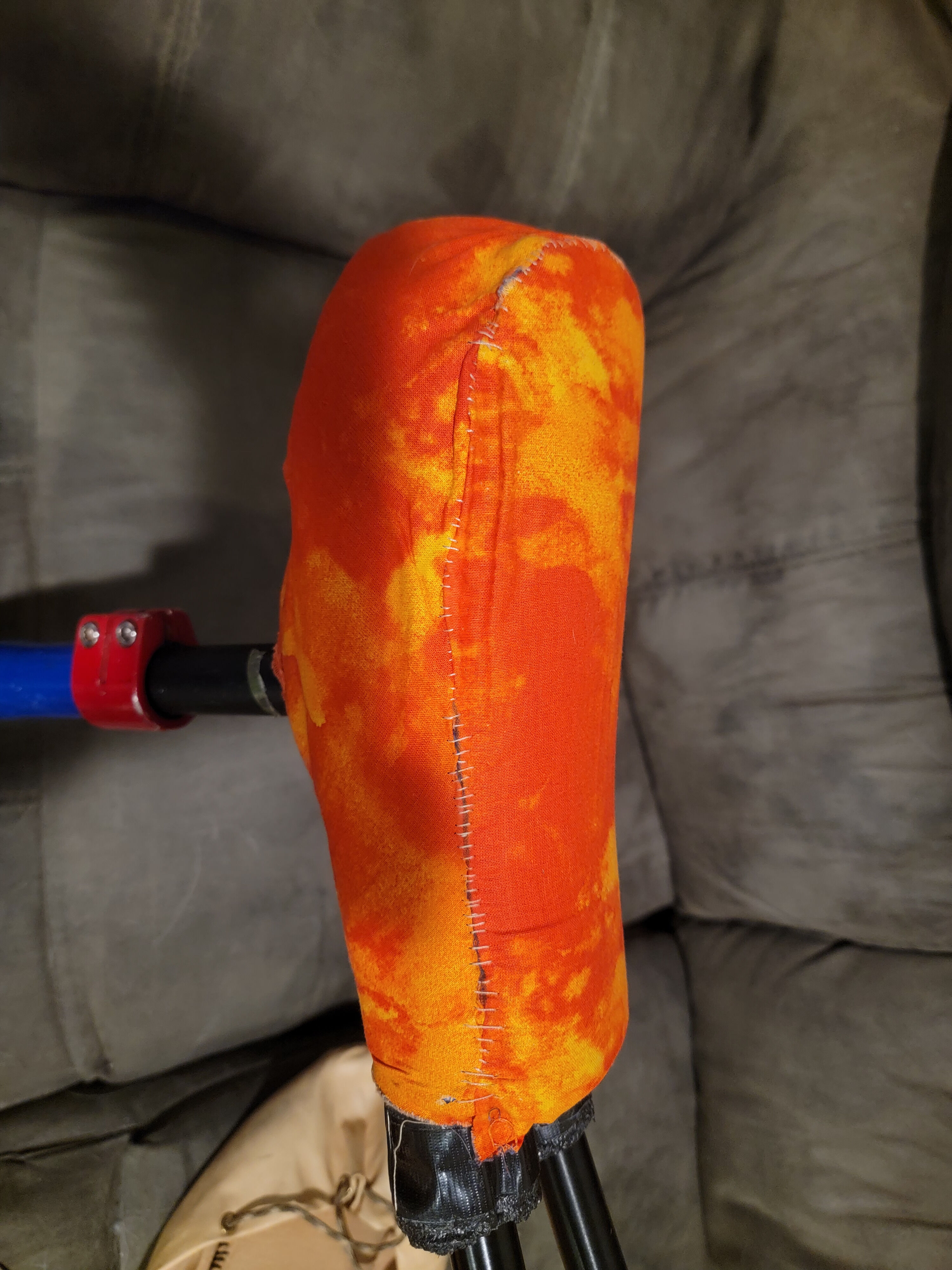

Im about to redo my saddle handle and as I took it apart I took a couple of pictures.
Medium saddle handle
1/2 pipe insulation foam
Hand stiched cloth cover
Hand stitched pig skin leather seat
Super comfortable and awesome seat but just a little to wide and heavy, reminds me of a beach cruiser seat and not a muni seat, so I recently got some new ISM bike seats to replace what I currently have and I’ll post the results here. The two seats are the ISM PL 1.1 and ISM PR 1.0.
Unicycleken,
It is not clear, why did you made a seam on leather cover?
If the leather is original, it able to take any form, when it installed wet and dried after.
