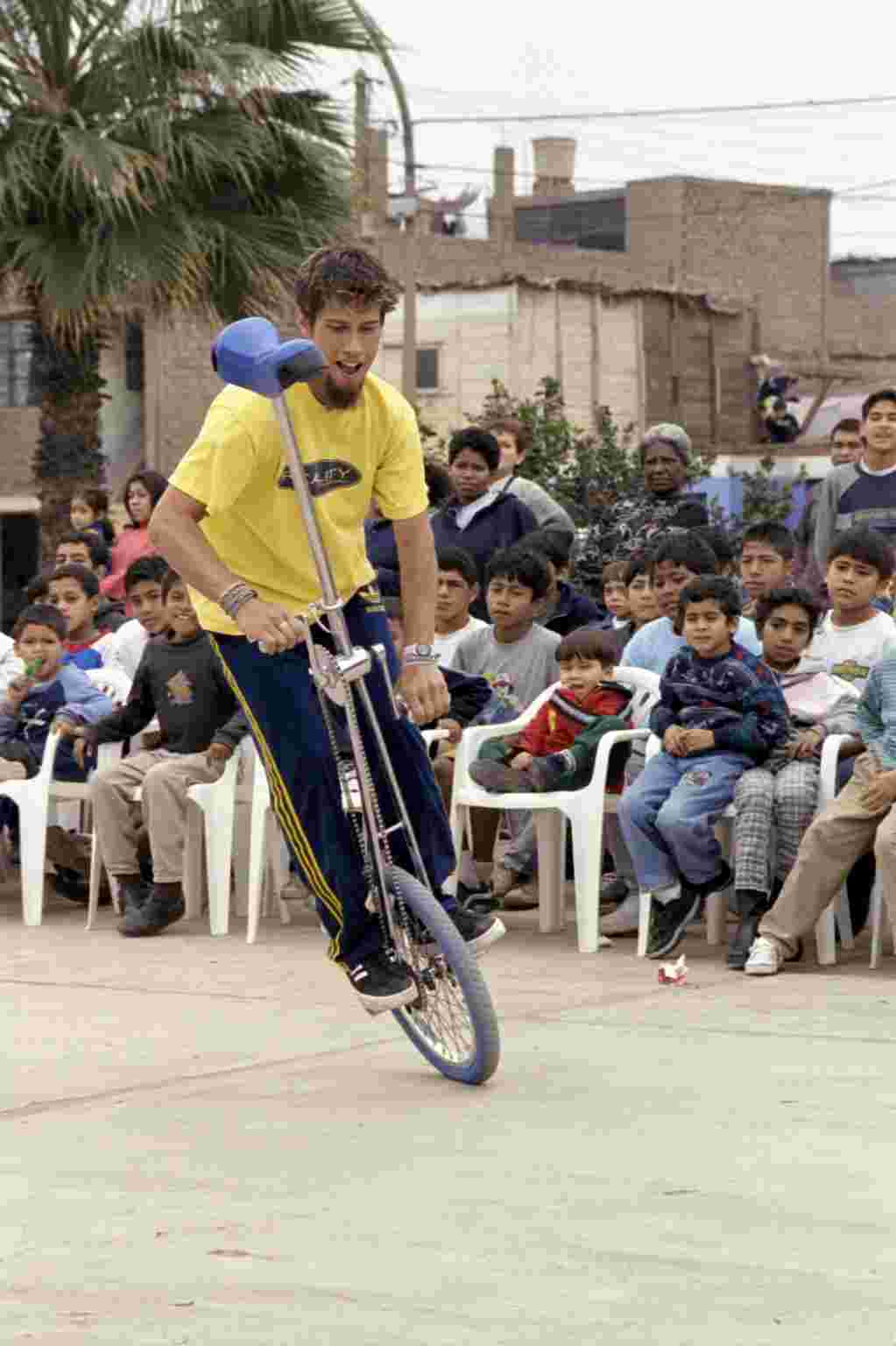

Ahh, those were the days…a big bump on the forehead, a black eye (roach didn’t have armor for the face yet), all the things necessary to learn hand ride with a chain driven uni.
There are a couple different styles…
*Mr. Foss does this trick with one hand on the frame or seat while the other hand does the pedaling.
*While learning I eventually went with the “both hands on the pedals” method. I think it helps to experiment with both.
Here are the main tips I can think of for the two hands method…
*(If you don’t mind getting your face whacked, just ignore this step) Wear a full-face helmet and tape some thick foam to the back of the seat. Some bmx pads on the seat tube might not be a bad idea either.
*Hands on pedals, pick up the uni off the ground and “pedal” with your hands. Your arms need to get used to the circular motion of the pedals and how close the frame and seat is during your pedaling motion. When the wheel is on the ground we tend to pull the entire uni towards ourselves when we are pulling on the back end of the pedal stroke, WHAM, black eye!
*As soon as you get both feet on the pegs your legs should be locked straight vertically over the axel. I find that I usually bend my upper body forward a bit.
*Keep the arms as far in front as you possibly can.
*I do most of my steering by making minor adjustments with my feet, moving them forward and back. At the same time I may lean the entire uni in the desired direction to produce a sharper turn.
*As far as getting the engine cranked up, I just have to say keep trying. Have the pedals vertical at your start, push the top pedal and pull on the bottom one. It’s hard getting started at first, don’t give up.
Hope this helps…
sorry about the big pic, I thought I had it sized down…
