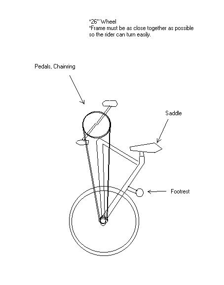

In the next year or so when I’ve saved up a bit of money, I’m going to get the guy who built my new frame to build me a hand-driven unicycle. The idea I’ve got is that the rider could sit upright and pedal with his or her hands out in front. This chainring would be linked to the wheel the same way as a giraffe. It’s very similar to a giraffe but the frame shape is different so that the rider can use their hands to pedal.
Saddle - I’ll probably use a bike seat. This way I’ll be able to get a nice soft gel seat easily and will also be able to easily use a bike seatpost and seat combination with rails for more adjustments. You can get some really nice wide gel seats. Maybe later if it suits I could upgrade to a fully padded and full-sized chair (without the legs).
Foot Rests - I’ll use footrests with an adjustable position so that the rider can have it set up so they take the stress off their backsides.
Wheel Sizes - I’ll go for a 26" wheel. Although this thing may be a little tricky to learn to ride, I think it’ll be worth it to have a big wheel to cruize along on. Try to picture this thign in action and how great it’d look.
Although I’m sure it isn’t, I really hope this is an original idea. I’ll try to come up with a quick design tonight and post it. Please tell me what you think and if you have any comments.

This thing’s going to be pretty tricky to ride. The main problem will be turning. I think the way to get over this is to make the frame as close together as possible (no big distances forwards and backwards).
I’ve done a little drawing of it on Paint. Any suggestions?

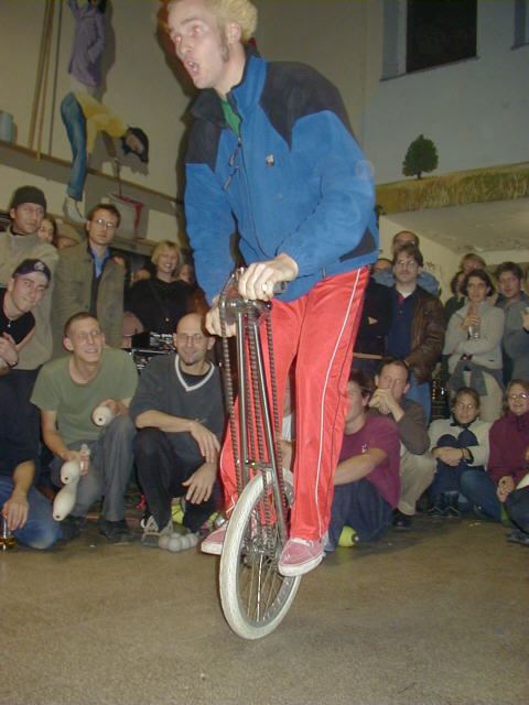

Here´s another photo of a hand pedaled giraffe with removed seat. It´s Arne Tolgen from germany performing in a juggling jam session.
UniFrank

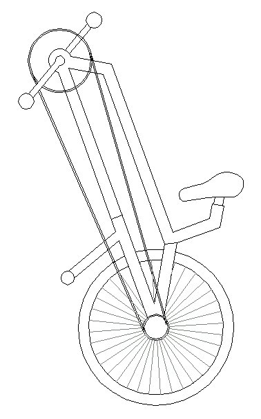

I’ve come up with the second stage of the design. The idea is to use part of an old bike frame. That way, we can use the part that holds the bottom bracket and save heaps of time and effort. Only part of the bike frame will be used. The rest will be cut away and then extra bits will be welded together. Is there a problem with welding two different metals together? I’m not sure about either of the materials we’ll use yet. All I know is that the bike frame will probably be an old one so you may be able to guess the metal…I don’t know.
I’ll post another picture in a minute of the frame only and highlight the bit that comes from a bike frame. This design will surely change. I think it’ll take a bit of fiddling around to get the geometry right so that it’s easy enough to turn and not a strain to ride. As I said before, an adjustable and comfy seat will be very necessary.
Any comments?
p.s. This is fun!
Alright, here it is. You can see in the picture that the part of the bike that will be used is in red. The blue lines indicate the rest of the bike to give you an idea of what parts of the bike are used (the bits running from the seat to the bottom bracket and from the front end to the bottom bracket). In the picture, the front end of the bike frame would be at the bottom. You can also see the parts of the unicycle frame towards the bottom where the frame breaks into two to go either side of the wheel. Naturally this is a very rough drawing just to get an idea of the shape of this thing.
