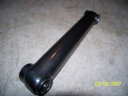

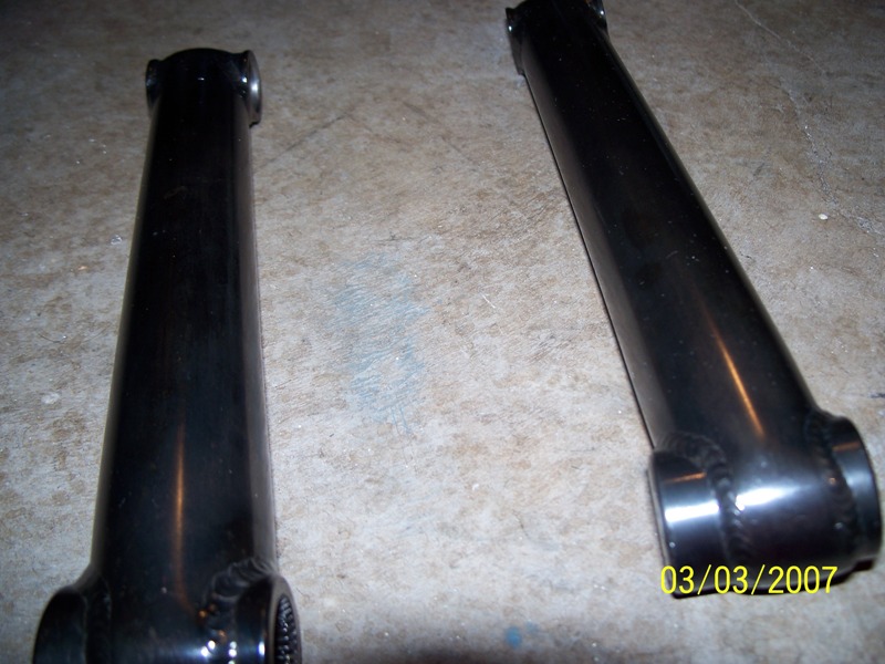

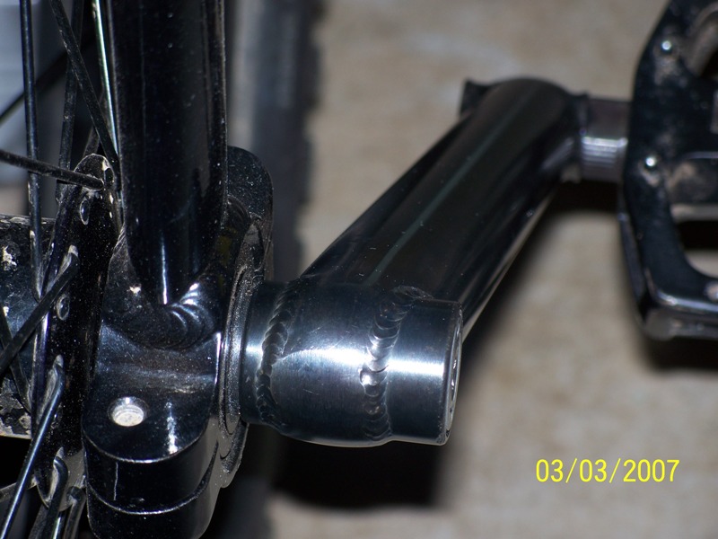

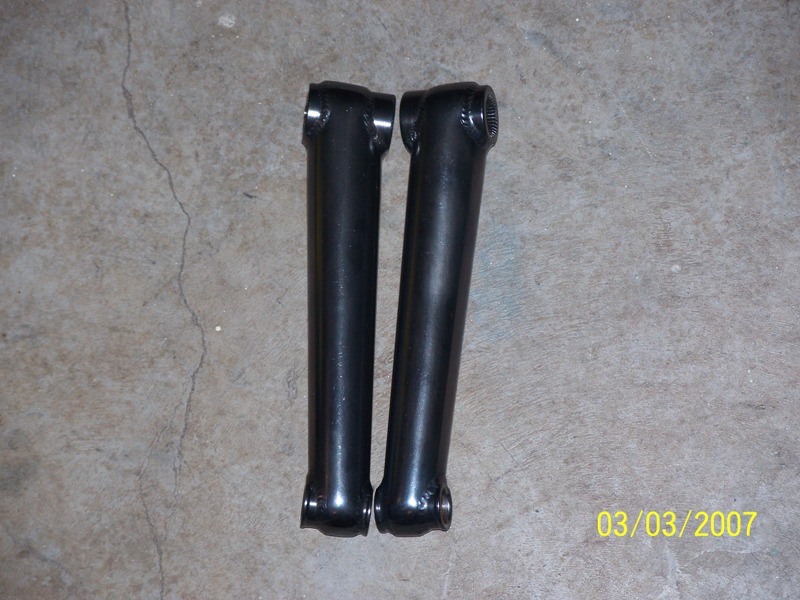

After re-bluing one of my guns, I thought if bluing would work on uni’s. It does. I have some pics of cranks I did. It’s hard to tell, but they look real good. Really rich, shiny black. I didn’t do them real black. they are kinda black tinted. It looks much better in real, than the pics. If you have some extra cash, and want some nice looking black or slightly black cranks(or any other metal parts), then get some of this. I think my bottle of bluing was like $12, so pretty cheap. Im gonna have to see how it holds up over time.

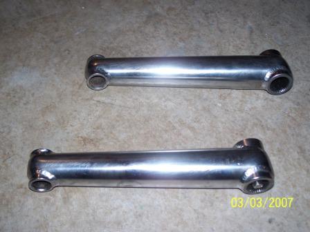

1st picture is the cranks before. They are stripped down to bare shiny metal. Wich I also like.

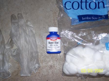

2nd pic is the stuff you need. I just had my gun bluing, gloves(your not supposed to get the bluing on you, or you will get cancer and die), steel wool, and cotton swabs.

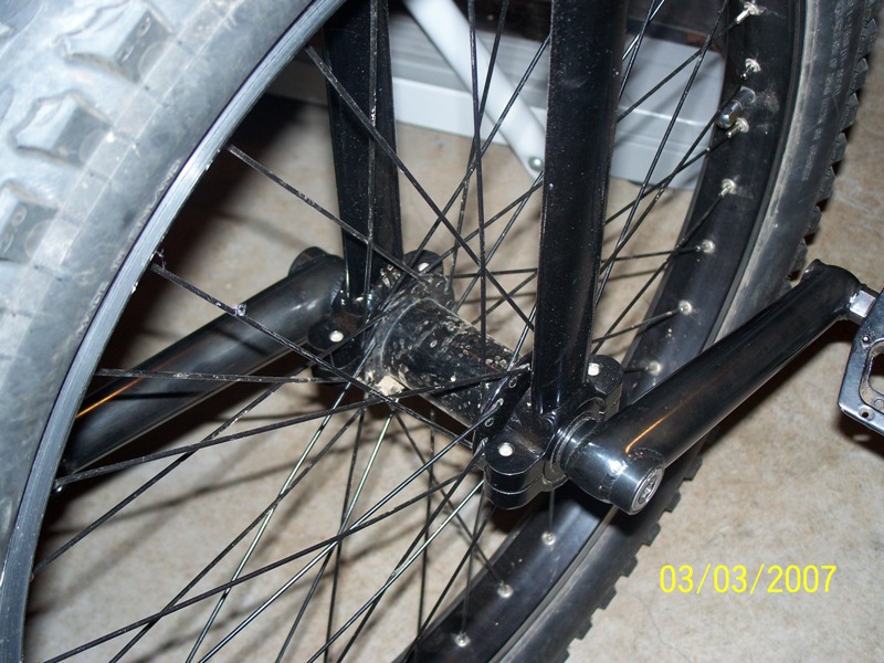

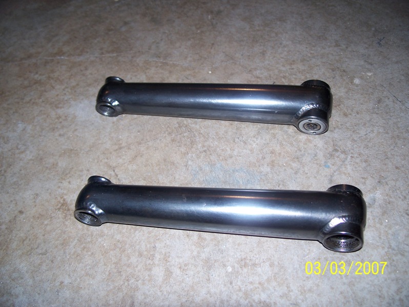

The rest of the pics are just the finished products.
woah thats look awesome. I really good idea to do is do that to the kh frame hub and cranks! All you would need to do before bluing is strip paint off frame.
yeah, that’s the only trouble in the process is stripping the old paint. But it doesn’t take long, and it looks good.
