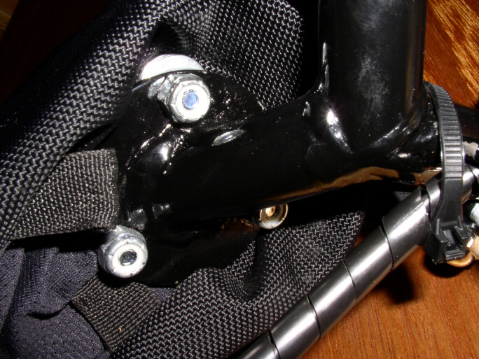

I purchased the GB “Y” shaped handle to add to my Coker, which has a Miyata airseat setup. Naively thinking it would work out of the box, I was surprised to find that the three holes in the handles mounting plate and the three bolts under the front of the Miyata don’t match up. As far as I can tell from a visual exploration, two of the holes do match up, but the third is totally opposite, i.e. the third on the seat is to the front, and the third on the handle is to the back.
Any experience on this? I was thinking I’d settle for a two bolt mounting, and just use some bolt shears to get the third one out of the way. That doesn’t seem very elegant…

I would take the cover I off and drill a 3rd hole in the seat. Better yet, get the GB4 stiffener plate for $10. It really helps out and all the holes are already in it and they are broached for carrage bolts.
Mojoe
Mojoe is right on; that’s exactly what I did. It works great:
I have one of those crescent shaped stiffener plates, but I’m not sure I follow the connection. I’d still need to drill a new hole, correct? Is it just a matter of taking the roach cover off, or do I need to do deeper dis-assembly of the seat first? I’m having trouble picturing how I get the bolt in place under the seat…maybe it will become clear to me when I get the cover off…right now, all I see is the three bolts coming out of the bottom of the cover.

You’ll need to drill a hole in the plastic Miyata seat base to use the GB “Y” handle. The metal stiffener that Jagur posted a picture of already has a hole in the right place (George thinks of everything).

You will have to drill one hole, though if you have the stiffener bolted on this is very easy.
There is no reason to keep the original Miyata handle or the small kidney shaped plate on the saddle if you are using the GB handle.

Well I finally got around to installing the GB stiffener plate and “Y” handle on the Miyata seat for my Coker today. George, your directions worked great! I did a quick test ride and I think the new handle will be a big help on the longer rides. Now as soon as I can get my computer installed, I’ll go take one of those…
I did encounter a couple steps in the process that might be worth considering for incorporation into the directions. In regard to the carriage bolt size, at least at my local Home Depot, the only choices were 1" or 1.5"…they had no 1.25s. I used the 1" for the four points of attachment to the seat post, and the 1.5-ers for the three points front section where I was attaching the GB Handle.
The directions also call for installing the stiffener plate first, then using this as the template for drilling the 9/32 hole. Once I had the plate installed, however, the 9/32 drill bit I had would not fit cleanly through the square carraige hole in the stiffener plate. It locked. I ended up just using a 1/4 inch bit, which fit and worked fine.
I also have the Roach Air Pillow option on my Miyata, which introduces two additional processes to the “GB Coker handle instructions”. The first process–and thanks to John_Childs for pointing this out to me–is to remember to cover the whole plate with duct tape after installing the carraige bolts but before putting the cover back on. This helps hold the bolts in place when you flip the seat upside down to install the nuts, and it also protects the air pillow unit from the edges on the plate. The second process is that with the roach cover, you need to put the cover back over the seat before installing the GB handle. The directions for the standard saddle foam and cover call for installing the handle first.
