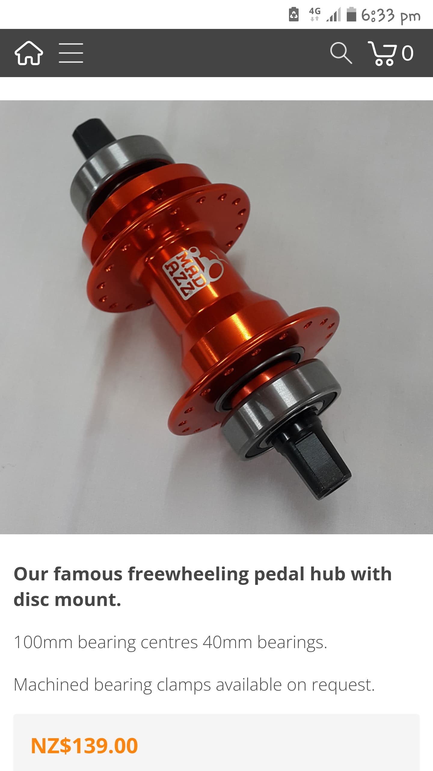

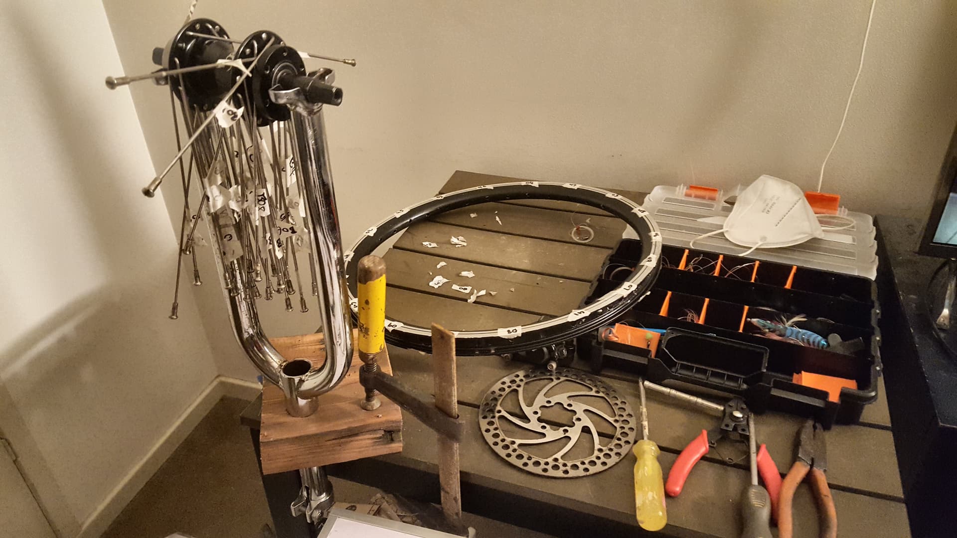

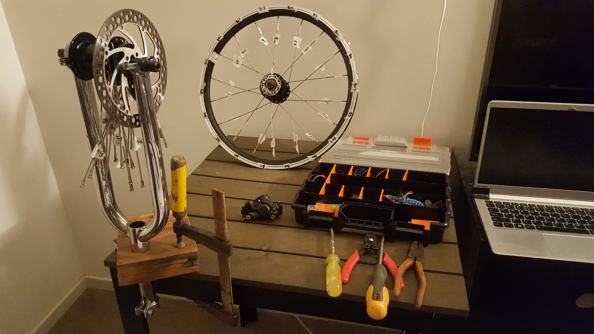

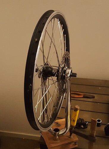

Got my Madazz hub delivered from New Zealand last week.
Started building the wheel from parts from an broken 20" electric bike. Re-using rim, spokes, 160mm disc with shimano calipers, wire cable and lever. Using my “aldi” frame (40mm bearing) suits 40mm Madazz freewheel hub.
Images of swapping out hubs from 20"wheel.

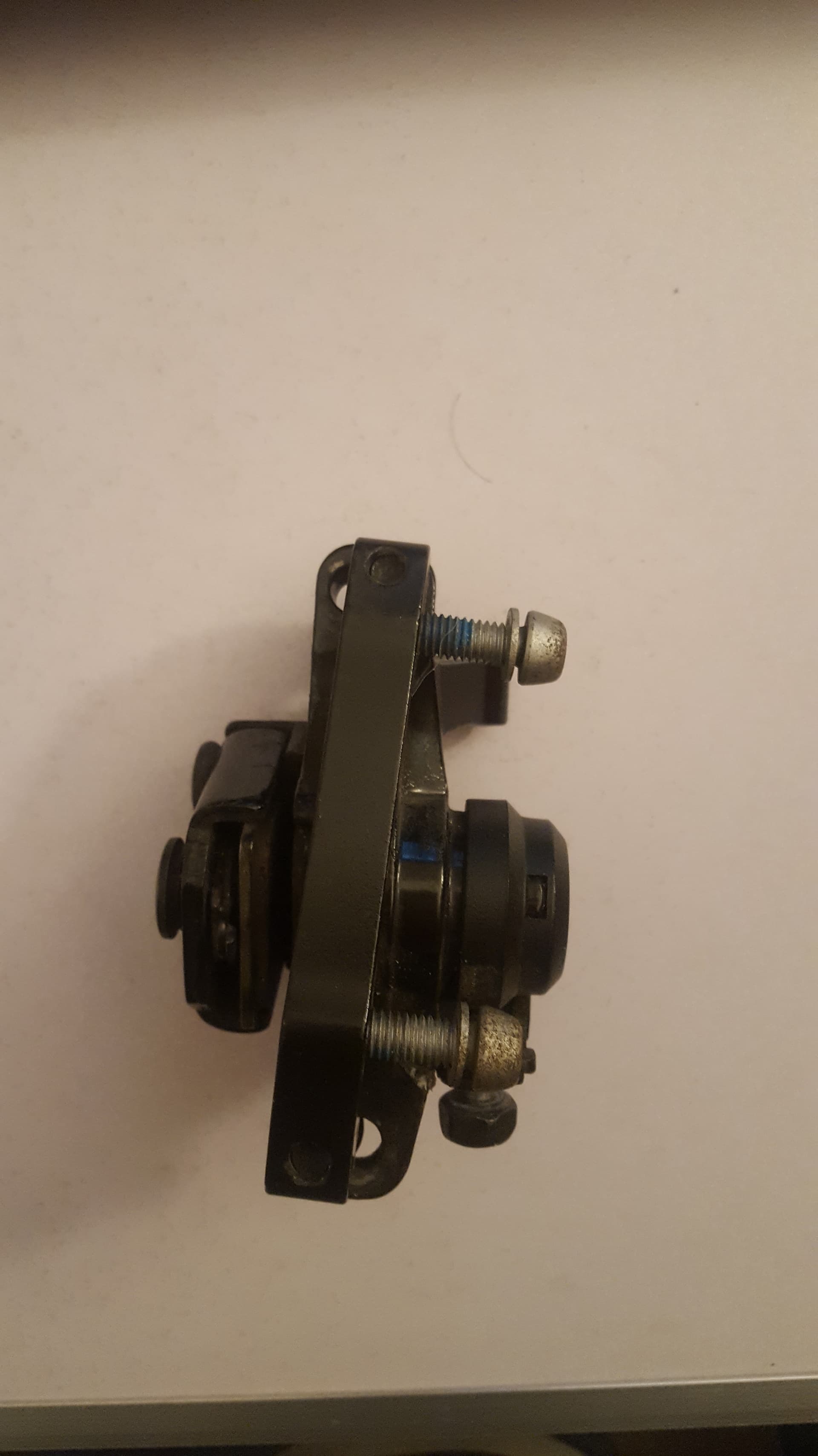

To mount the brake caliper, i might just drill holes in the frame and bolt on a plate. Rough as, I know. Will a D brake adaptor fit a 40mm bearing clamp?
Woah. If you get that straight, then hats off to you. :tophat:
The d-brake adaptor is made for bearing diameter of 42mm. To deal with the difference of diameter, you might use half a 40mm to 42mm shim, although I’d guess the d-brake adaptor won’t fit that frame (i.e. upper bearing shell) anyway. :x: But you can ask your unicycle dealer about that.
If you are willing to drill your frame and bolt on a brake tab I think you’ll be able to make a d’Brake fit the frame… as mentioned you’ll need a thin shim of some sort and you might need to file the holes to get them aligined if they are different spacing (maybe they aren’t). I think that would be easier than trying to align a tab.
I like your wheelbuilding stand. I did something similar at one point with a cheap seatpost screwed to a block with the frame on that – I like the block with the hole in it idea though.
The brake caliper I have has an alignment mounting piece which could adjust for approx. 5 deg misalignment with the “bolt on” mounting plate.
When i hold the caliper on the disk it looks like a 3mm plate bolted to the frame might work.
I reakon I wont be on this uni for more than a few seconds at a time for a long while, so not so worried about holes in the frame. I plan to learn without a brake to start with anyway so can unbolt the plate or not even drill for it until ready.
Next stage, I’ll probably keep an eye out for a good priced 24" muni with frame tabs and get hydrualic brake set… i would just swap hubs.
I put the bearing on too soon (before lacing spokes - disc in the way) but found that the interference fit is not too difficult to overcome.
I actually unbolted the brake disk and the 6 screws coming out, touch up against the bearing. By gently unscewing each of the 6 screws they push the bearing off half way. Then I got two screw drivers and leveraged on opposing sides of bearing and it gently moved off shaft. Glad I know that for when rebuilding other wheel sizes with madazz hub.

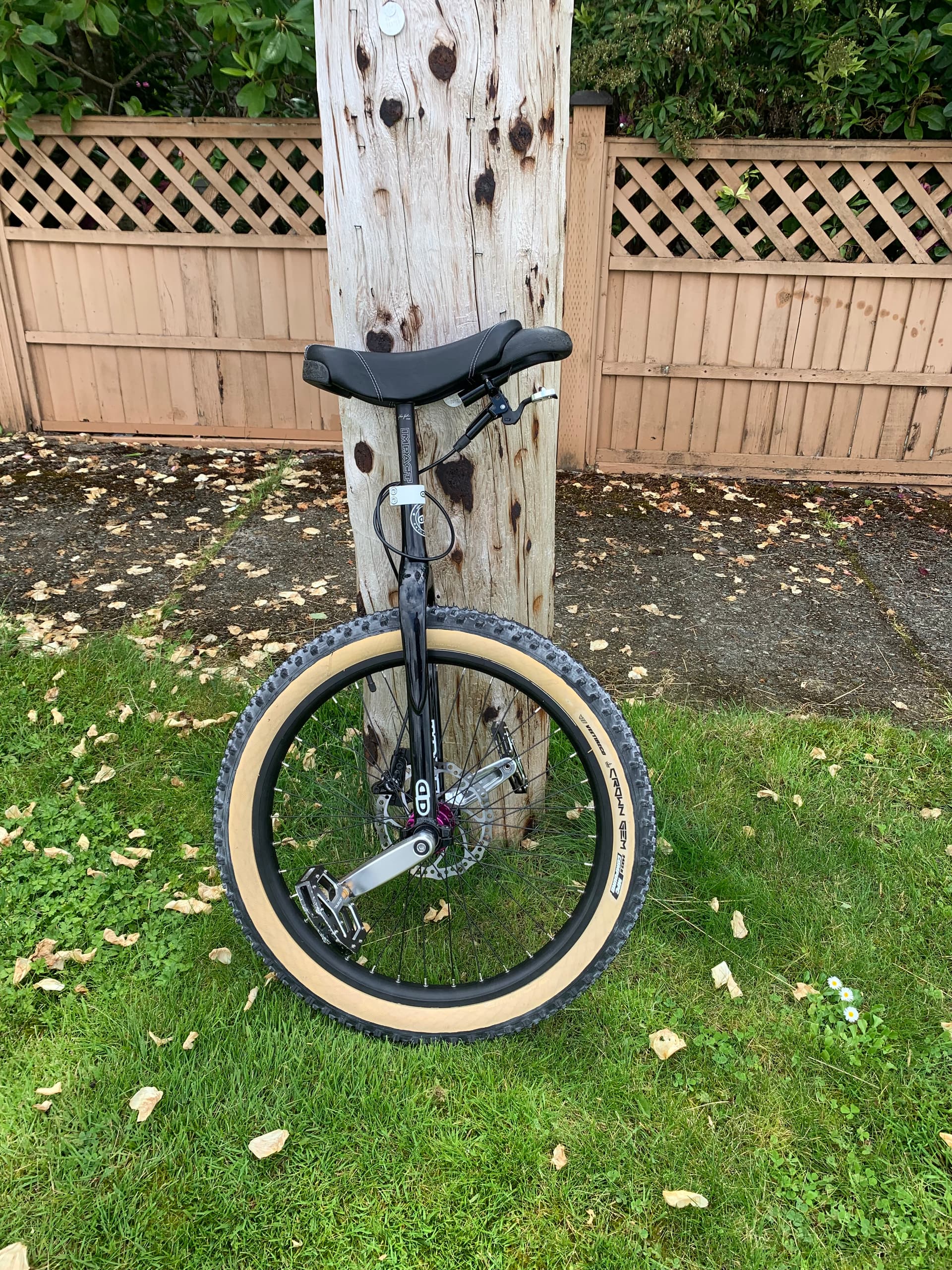

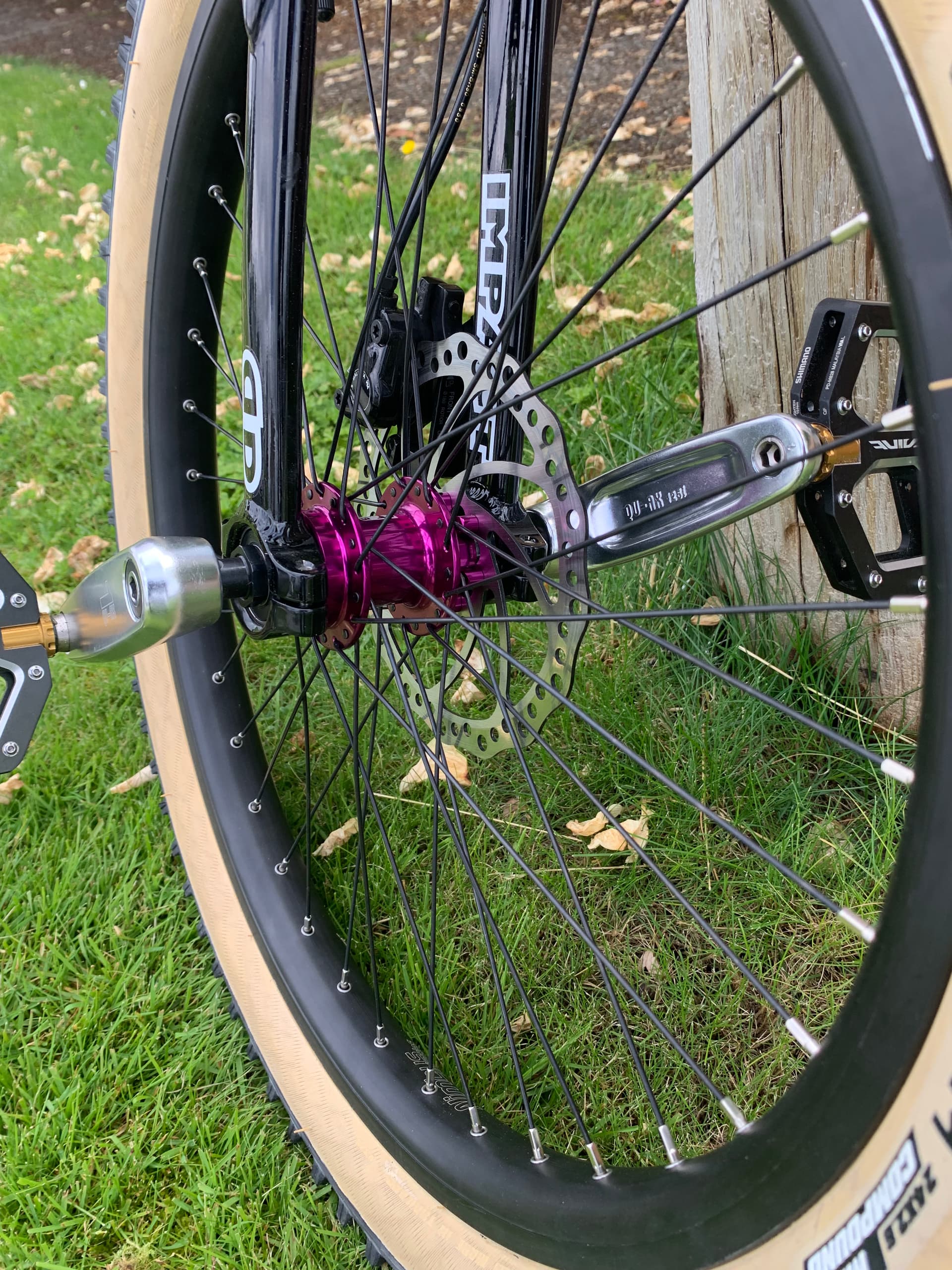

Put a P-Hub in my impact gravity
That looks proper nice , super clean and tidy :+1: I’m guessing you can ride freewheel as it’s to pretty to be dropped?
No this is my first freewheel uni and also the one my girlfriend was learning to ride on pre-freewheel hub. Luckily the seat and pedals take most of the beating and trust me, it’s dropped a lot
